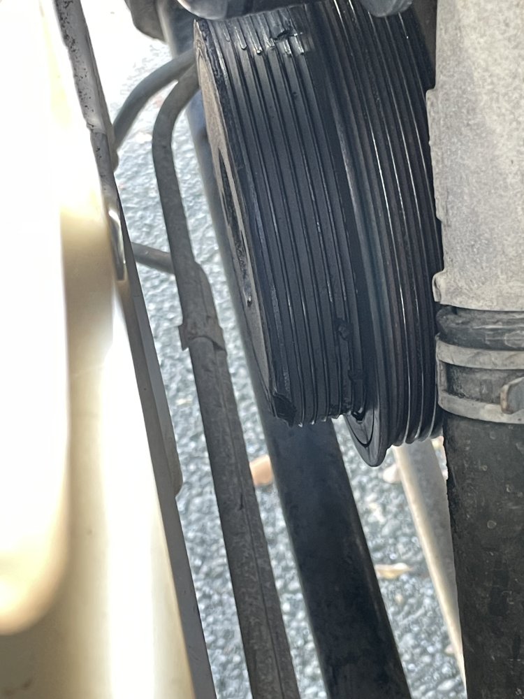

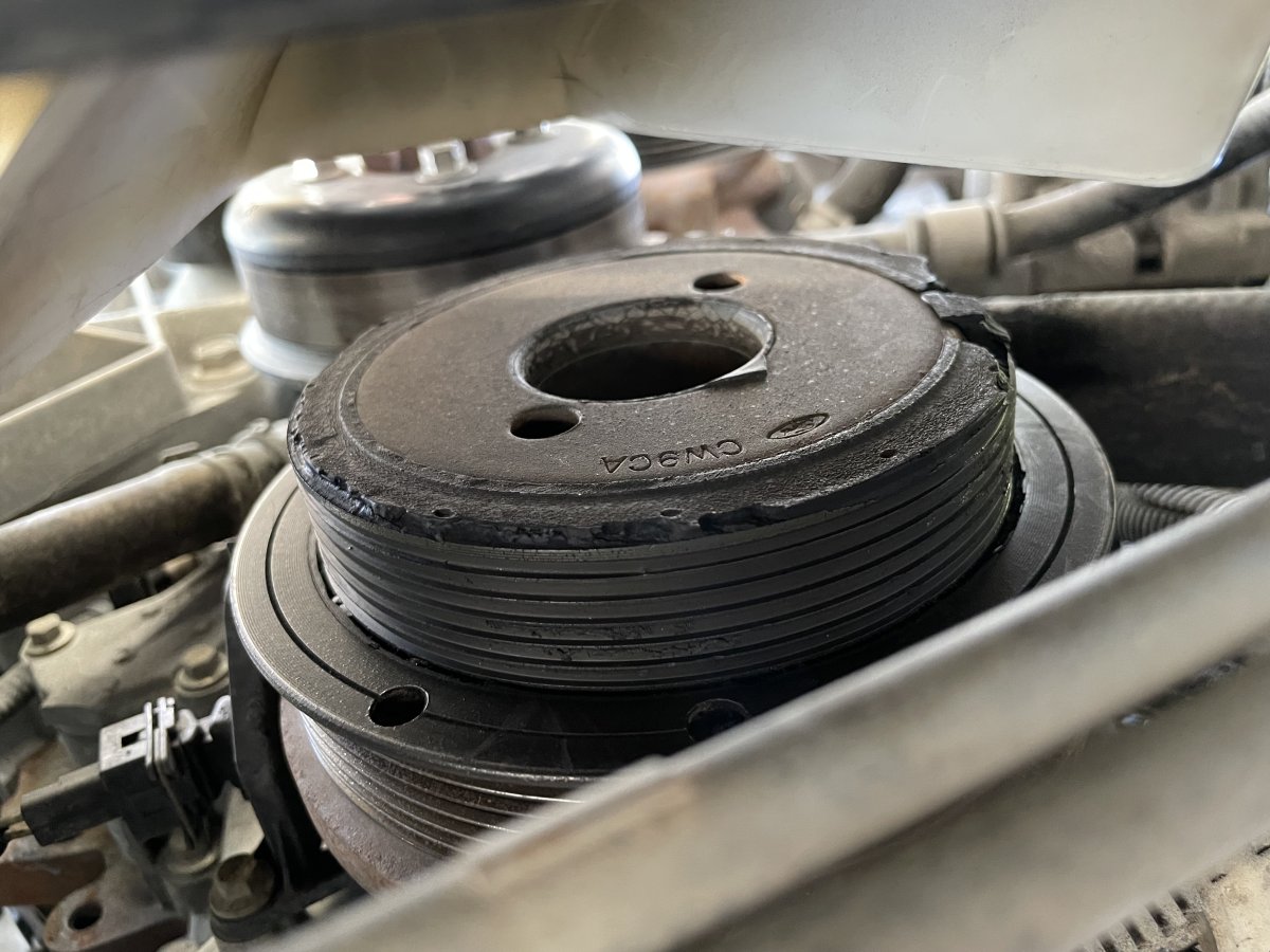

- The belt drive pulley coming off the crankshaft seems to be a bit worse for wear. I can get pictures later today, but it's rubber, and it seems like some bits are missing.
I'm kind of at a loss rn. I think the next thing is to try a motorcraft belt or just start throwing parts at it, which I really don't want to have to do. Or go to a shop and have them diagnose it.
I love O'Reilly's but their belts for the 4.0 OHV (and I'd bet for everything else) are 1/2 inch longer than what Advance lists for the same application. Normally not a problem, but when I swapped the alternator with one with slightly (like 1/8th) smaller pulley it started to slip. If any aftermarket idlers are slightly smaller than stock, it could be a similar problem.
Yes, I know the tensioner should have more travel than that but it doesn't. :dntknw:
Yeah I was worried about that. Definitely could have something to do with it.
There shouldn't be any missing chunks of rubber in the harmonic balancer pulley. If there is then it is time to replace it. This isn't to say this is the squeak issue but one that that is found during diagnosis.
When you changed the belts did you grab the pulleys and feel for any wobble?
It is concerning that you mention the belt moves on the tensioner pulley. This would cause a squeak.
Yeah the balancer pulley is missing quite a lot of rubber on the edge towards the front of the truck. I just felt the pulley where it's fully intact and there's a little ridge, which is probably supposed to keep the belt on. However, it's missing from probably 3/4ths of the pulley. Probably why it's spitting the belt off?

Harmonic balancer is missing more like all of that rubber rim actually.
Okay after some forum scouring I have learned that it is NOT supposed to be like that, and the balancers on 1st gen rangers like to split!!!! SO FUN WOW
