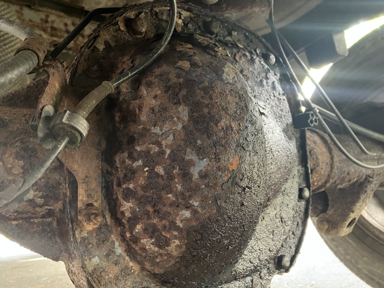

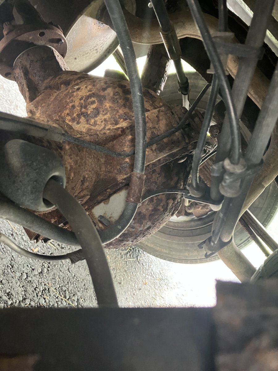

Hi all, I just recently bought a 2011 Ranger XL 2WD. It has 2.3 L in it. Really happy with! I need to replace the rear differential cover. Everyone I’ve talked to says that the truck should have the 7.5 axle in it, but the axle code on the door tag is 97. And everything I found so far it says that should be an 8.8. I can’t tell the difference by looking at it. Could someone help? Thank you!

Looks like an 8.8 to me, 7.5 diff covers are more flat on the top & bottom... your door tag says that it should be an 8.8.
Thanks Shran, is that unusual to have the8.8 axle paired with the 2.3L? My local parts store didn’t even show a listing for the 8.8 for that truck, but that might not mean much I guess.
Guess I'm not sure about newer trucks like yours but that would have been a very unusual if not impossible combination on any 1st, 2nd or 3rd gen truck. 4th/5th gen, I don't know, I suppose it's possible that it was an option on late model 5th gens for some reason, or they were trying to use up parts in the last model year, or who knows. Generally only 4.0 powered trucks got 8.8 rear axles.
Seems i heard (on here probably) after 08ish everything got the 8.8
Did Ford even make a 7.5 with disc brakes?
the 2010's and 11 had disc brkes on the rear
it is an 8.8, has the big 1.6 Explorer outer bearings, has shorter 28 spline axle shafts with wheel speed sensors, and the 11.65 vented disk setup is unique to that axle.
the 2010/2011 have unique rear axles mostly to accommodate RSC, roll stability control. each wheel has it's own line back the ABS unit.
yes, even the 2.3s got that axle.

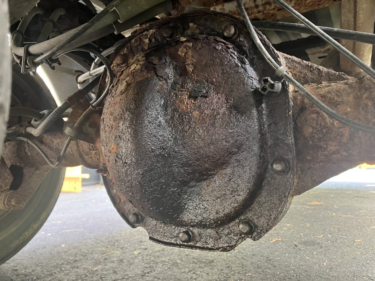

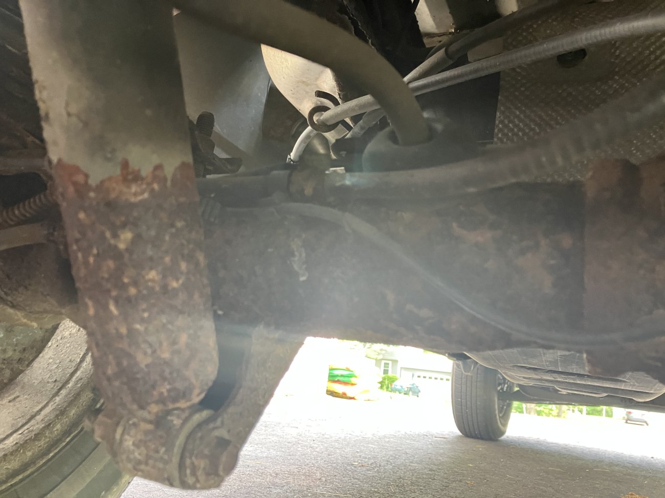

Thank you all. It does have rear disc brakes with a drum in the center of the rotor for the e brake. There is also what looks like a rubber vent tube coming out of the middle of the axle tube on the driver’s side.

all axles have that vent, or some kind of vent.
the tube-end flange the disk plate mounts to is unique to that axle.
I bought a new Ranger XLT in 2011 near the end of production. It was a 4.0, 4x4 with an automatic and 3.73's- nobody's idea of a heavy duty off roader- and it came with Rancho shocks. I think they were using up whatever parts they had, that's probably how a 4 cylinder truck got an 8.8.

something interesting is the main casting/center section has the boss for the watts link pivot arm.
abs sensor no longer needed because of independent sensors on each wheel and that boss is not there.
