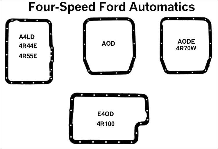

Your best bet is to look at the pan, note the shape and number of bolts. A 1990 would almost certainly have an AOD, there wasn't anything else in those cars.
