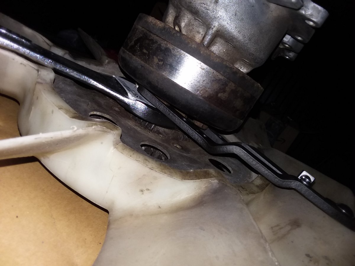

Been waiting for the combo wrench and the fan clutch holder so I could separate it and the fan from the water pump. I tried other methods (vises, pipe wrenches) and nothing I have in my tool box would work. Within half an hour of the arrival...done. I thought I read or saw something on YouTube that the fan clutch holder I purchased was a POS. I have to disagree. But maybe it was easier since I had the pump off the engine.
And what the heck is the nonsense on the fan shroud that says "Right hand thread on fan clutch?" PPPPFFFFHHHHTTT!!
Righty-tighty. Lefty-Lucy.

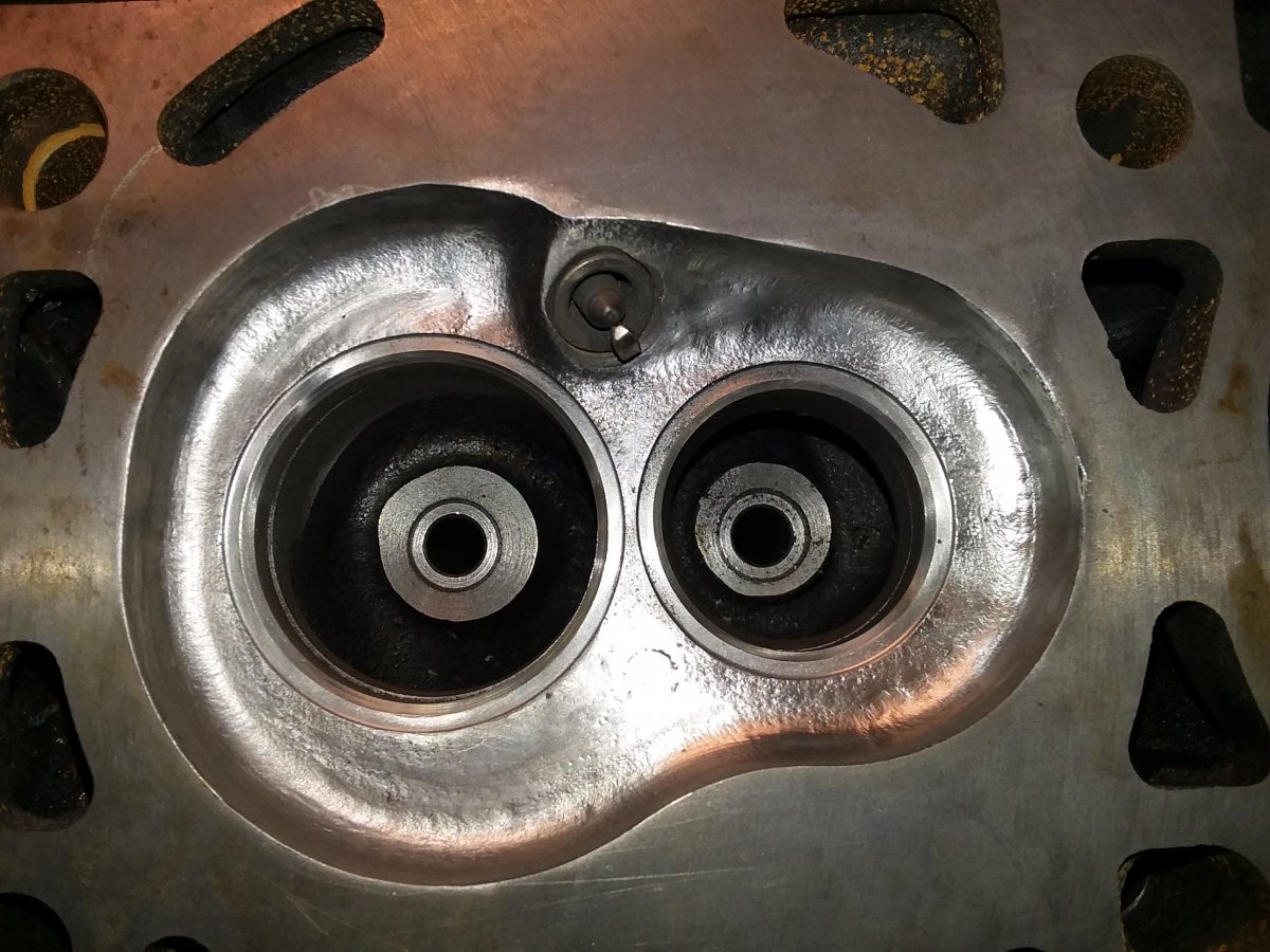

in spite of all the practicing on the old heads and watching all the videos on how to do this polishing business, it is still a bit unnerving to start carving metal away from a perfectly good head that you just spent a couple of hundred bucks on. Take out too much and you lose horsepower. If one is bigger than the other by more than .25 ml your f'ed. I tried that measuring stuff and it ain't easy - seriously? First get the head set up so that it's level, upside down level. I can laugh about this cause I am new to it and just went through it with the understanding that this is how you need to do it - but still, it's a PIA.
It's all good though and I am getting the hang of it. It just takes time. Here's a couple of pics just because....

I've been busy grinding away and polishing up the heads (specifically the combustion chambers). In doing the combustion chambers and measuring the volume between the polished and the unpolished, I'm wondering how much is too much and/or too little?
I'm measuring out at 60 ml after polishing. Compared to 58 ml prior to. I only want to remove enough material to get a nice smooth finish and not increase the volume too much to lower compression.
Any ideas or am I over-thinking?
thanks
Bring up a compression calculator, input engine specs. Shouldnt be too great of a loss.
Worst case, can have heads shaved down a few thousands to make up the difference.
