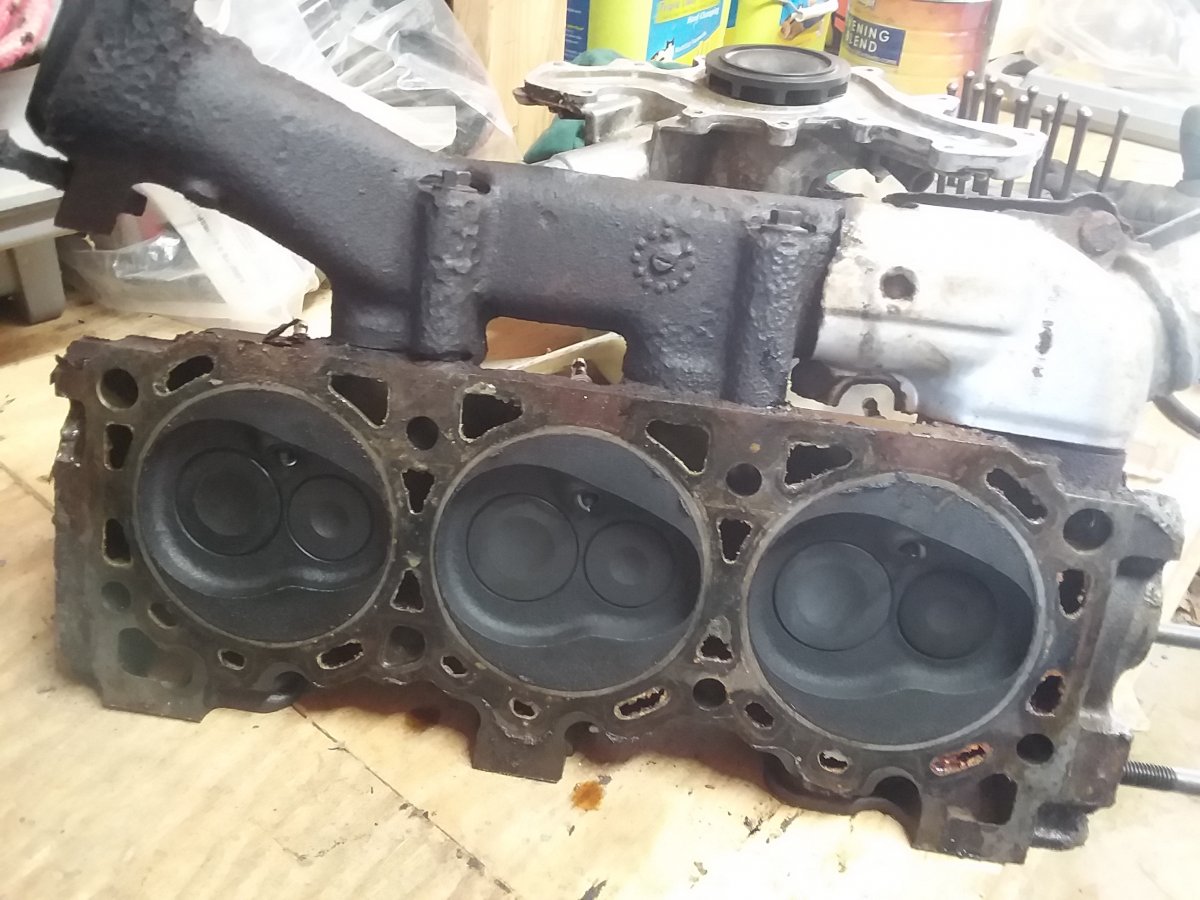

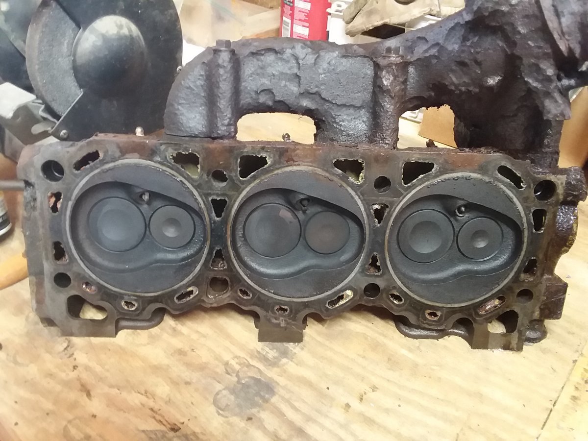

heads are off!!!!! I am Xcited. sorry. I know this is old hat for you guys but for me---uncharted territory. I mean I did stuff when I was little that I can hardly remember now, so that doesn't count. Anyway, now I get to order new heads from King and look for a new exhaust system - stainless if it's not too expensive - would love to include some headers thanks to the link
provided by schul274, but first things first...
You can see in the pics how bad the drivers side mani was messed up. The top side was even worse. Could be a case study for this forum on what happens when coolant is allowed to run rampant.. IDK.20200408_131845[1].jpg20200408_131900[1].jpg
You can see in the pics how bad the drivers side mani was messed up. The top side was even worse. Could be a case study for this forum on what happens when coolant is allowed to run rampant.. IDK.View attachment 39777View attachment 39778

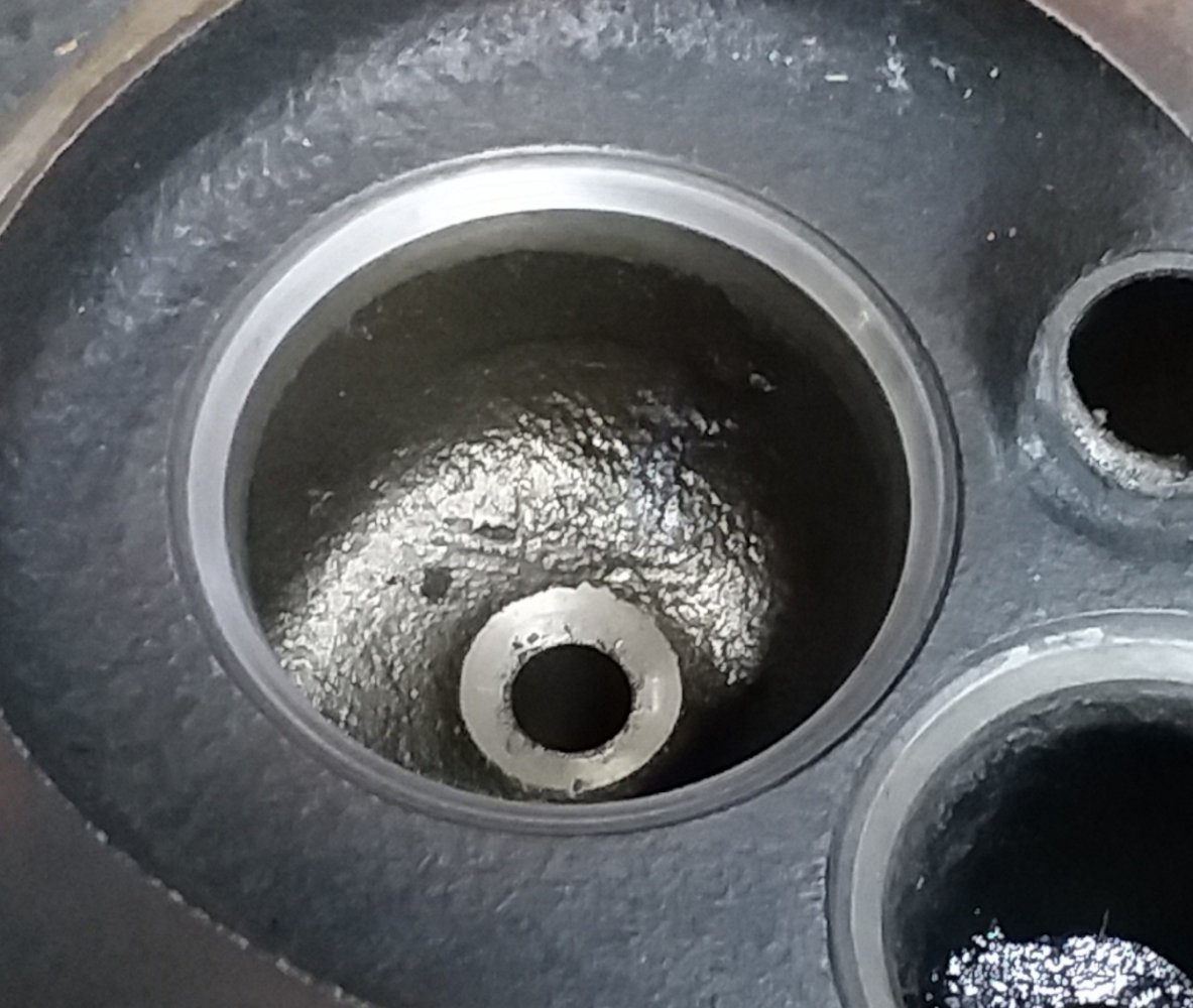

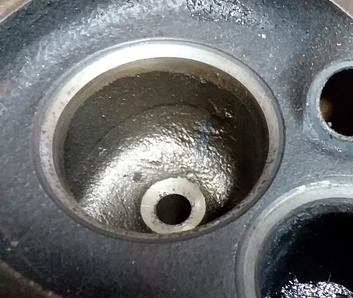

Ordered headers today. and practiced valve lapping on the old heads - never heard of it before, but you can sure see the difference:
Before... After
In the Before image you can see lots of pitting around the valve seat. Totally gone after lapping.

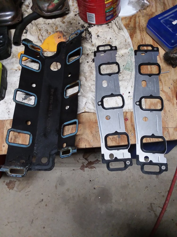

Taking stock of the gaskets that came with the cylinder heads and I have a couple of questions. It's a Fel-Pro gasket set.

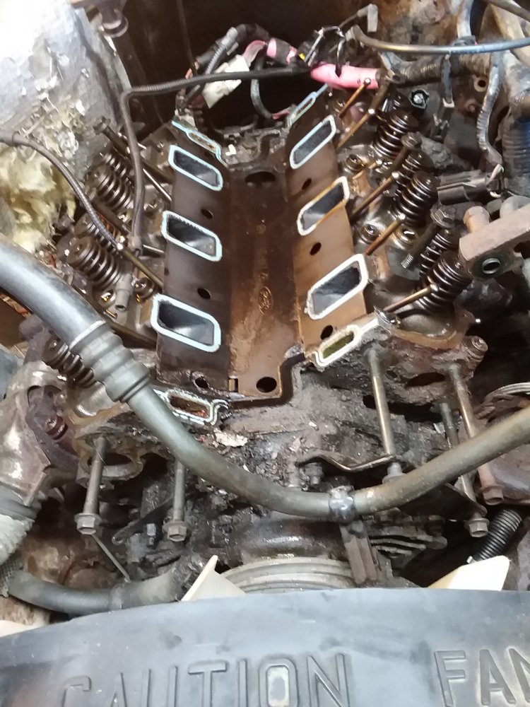

When I removed the lower intake manifold, there was this gasket?
40161
In the set that was provided, there were these:
40162
But there was nothing like the image above. Can someone help enlighten me so I ain't so dumb?
Thanks in advance.
Nevermind. It's the lower intake manifold gasket and for whatever reason it is not included in the "Complete" gasket set I received. Ordered it separately from Rock Auto.
Having fun answering my own questions...
I found out that the older one-piece gasket apparently was problematic and was replaced by the two metal gaskets. Not sure if that's true or not or what the actual problem was with the one-piece gasket, but that's what I was told.
I kinda like the one-piecer. Seems like it offers more protection for the lower case by covering the slots in the valley.. The metal ones don't seem to fit well.
