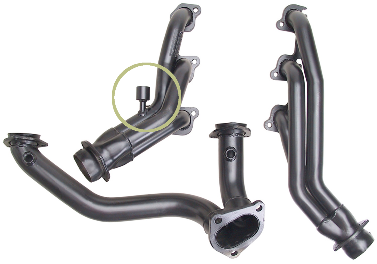

Have a question on the headers. These are the Hedman headers I purchased. The O2 fittings are on the crossover, but what is the circled portion? Is that the warm air outlet or intake? Thanks.

Got the girl back yesterday. It's all good. Turns out that the crossover - in the opinion of Hilltop - was not welded correctly and there was no way to get both sides to fit properly into the headers. One side would tighten up. but the other would not. So they remade the crossover. Installed a stainless exhaust with OEM cat. Only thing left for me to do is find the right size pipe plug to seal the EGR inlet on the driver's side header. It's metric -- pppfffftt. I've tried two Dave at Hilltop tried a couple. I've contacted Hedman but no response yet. The odd thing is that it isn't showing any codes. I thought it might show a rich code -176 or 177, but nothing. Attached a pic. Brakes and rear diff seal are next.
