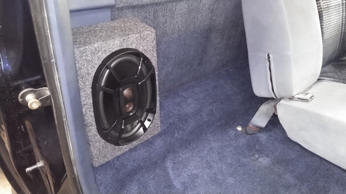

More importantly, I now have some tunes. Took me a while to find suitable speaker options, the second gen dash doesn't have any in it and I don't want to cut holes in my new door panels. I found these nice little 6x9 boxes at a local audio store for 50 bucks, a set of Polk audio speakers at Walmart on clearance for 60 bucks, and a Sony head unit for 80 bucks. Wired everything up last night and it works great. Need to play with the equalizer a bit still but I am very happy with how it looks and how the speaker boxes fit behind the seats.

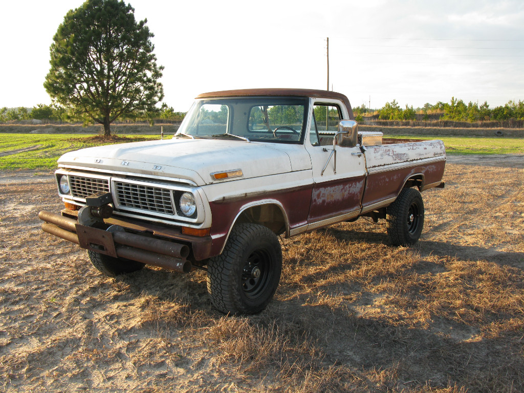

I like it, reminds me of what dad did on my F-100 back in the day. These were from a coupl eof years ago, but he built them 25-30 years ago. Back then it also had a home built hitch receiver attached to the bottom of the back bumper, now it kind of needs a second tube to fill the gap.

Yours is much better executed. I haven't decided if I'm going to keep this style but rebuilt stronger, or go rear step bumper and warn type front when I start restoring.
