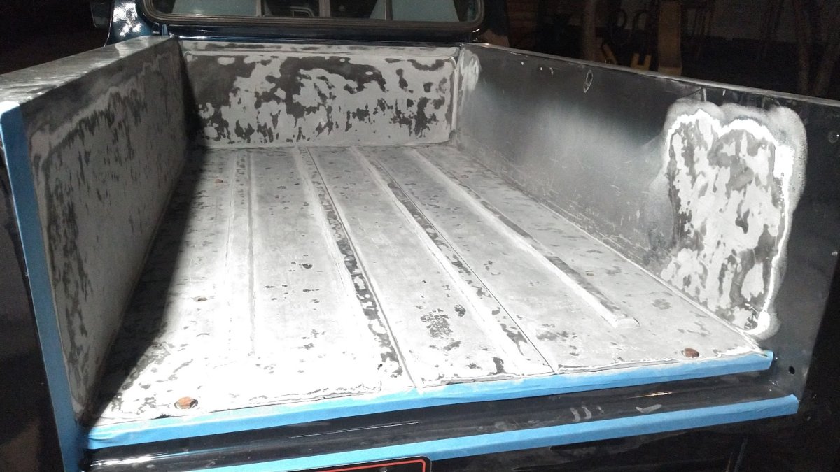

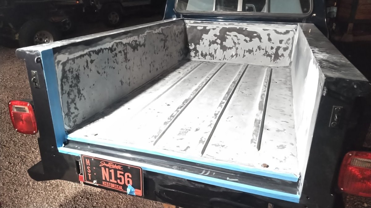

Making good progress with prepping the inside of the box for bedliner. Feels weird sanding on it so soon after paint... but it is what it is. Hopefully I will have a weekend here in the next week or two that I can spray it - I am using Raptor Liner.
Let's just get bypass the boring sanding pics and get right to progress. I took half of Friday off to go to the junkyard and picked a disc brake 8.8 with 4.10 gears for this truck... was done with that by 2:30 and it was nice out so I figured, why not spray bedliner? Since I was more or less ready and all... not going to have a lot of nice non-work days left this year.
