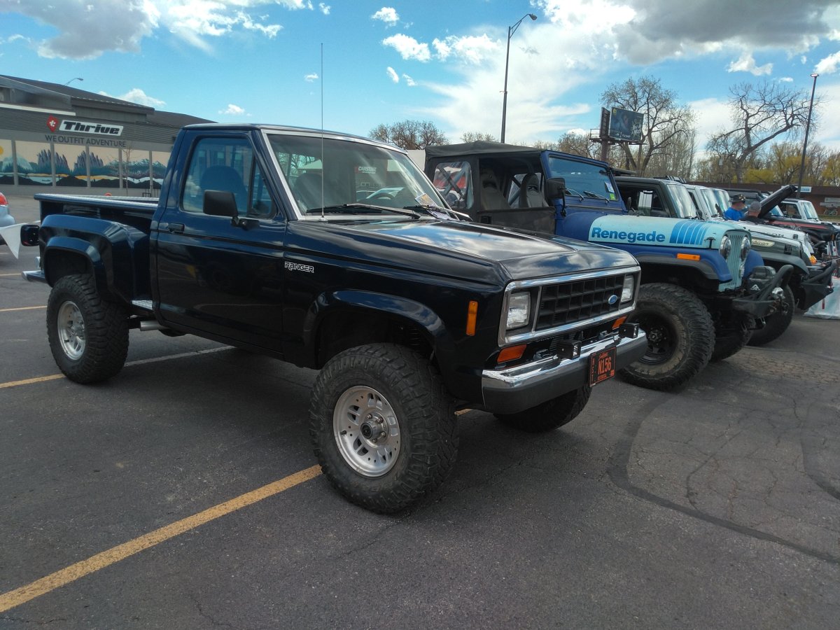

Sunday was a marathon of bolt shit back into place and empty a bunch of boxes of new parts. That pile of empty boxes on the floor is always a super good feeling. Last night all I had left was building one brake line, bleeding the brakes, putting gear lube in it and putting the tires/wheels & driveshaft back on. Took a sick day today and hammered out those last bits between naps, I actually do feel like crap but got restless. My kid helped me bleed the brakes this evening and I put about 10 miles on it testing and correcting the speedo.
First thoughts - 3.73 to 4.10 was not a huge jump like I'd somewhat hoped. Lot more snort from a stop, still kind of a turd at highway speed but not like my wife's 3.27 gears. I was expecting more from the limited slip, that "err err err err" around corners is cool but it doesn't do it. Oh well.
Most importantly - the brakes are MUCH better. It has about the same stopping power but I can't lock the rears up on command like I could with the drums. It was almost unsafe to drive it that way, I was always paranoid that I'd have to panic stop and rear end somebody because of the stupid brakes. Not anymore!
Looks pretty cool too.
Congrats on the show win.
