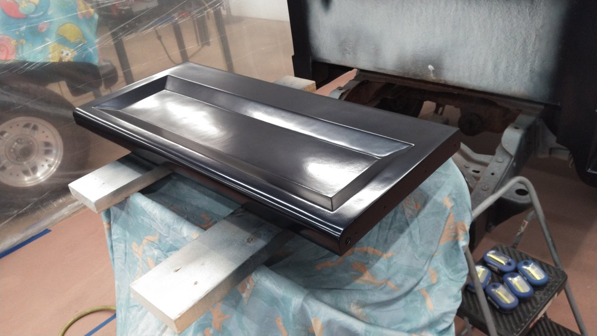

Small update, I am almost ready to shoot primer. I finished scuffing up the box and washed the entire thing with soapy water to neutralize the baking soda. I also am 99.9% done with the tailgate, which was a mess, and also the main reason I don't have this thing painted! It needed a LOT of repairs around the inside edges and I had to put several coats of resin and matting on it to fix that. After washing it yesterday I found two little spots I need to fill, no big deal, if the weather cooperates I am going to shoot some primer on it soon and let it cure for a week, then see where I'm at.

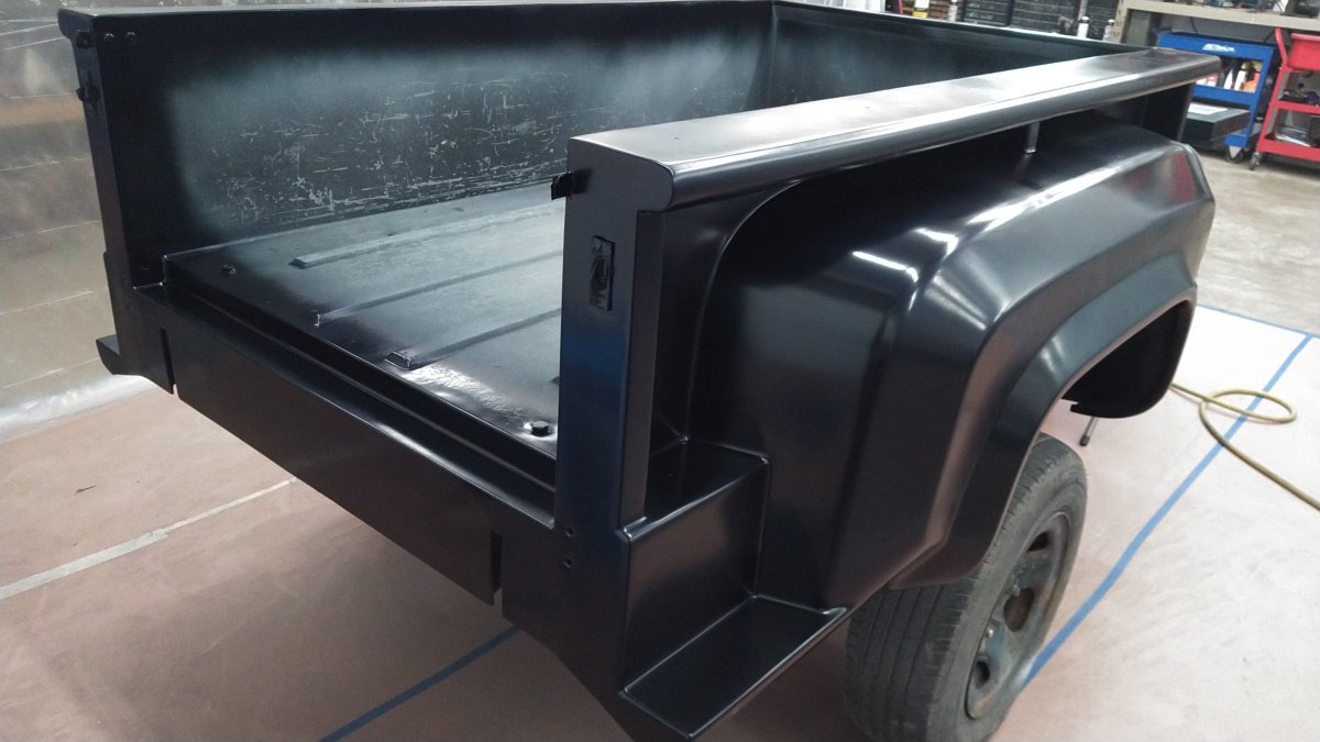

Imgur was acting up so I didn't get pics posted but this was my progress from last Saturday. Kids were all out of the house and so I had a few hours time by myself which I have found is necessary for me to focus on things without interruptions. I shot two coats of primer on the box and tailgate. The box will need more, there were a lot of cracks in the gel coat and I was advised to keep adding high build primer until they are filled.
I am not worried about overspray inside the box, at this point I am pretty convinced that I am going to spray Raptor Liner on that once I've got the truck back together. My buddy used it on his Jeep tub and IMO it's dang near Line-x quality stuff at a fraction of the cost.

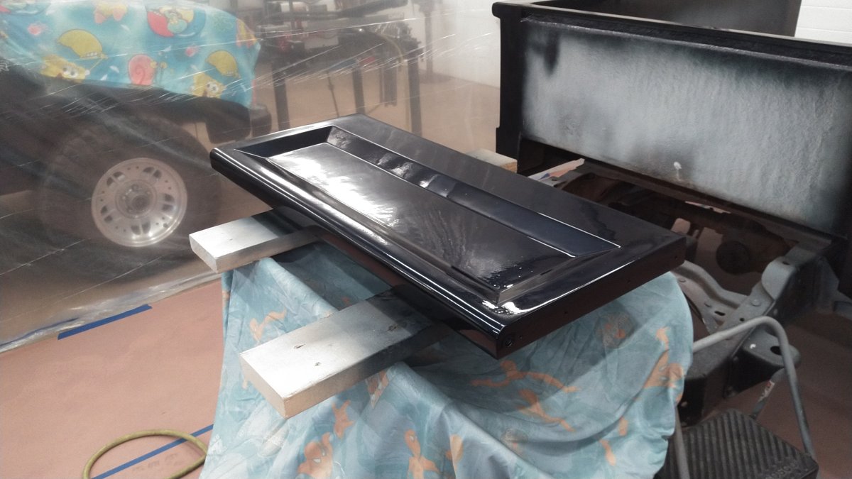

I am really pleased with the tailgate. I may wet sand it and shoot one more coat...not sure yet. I could probably get away with just sanding and a coat of sealer.

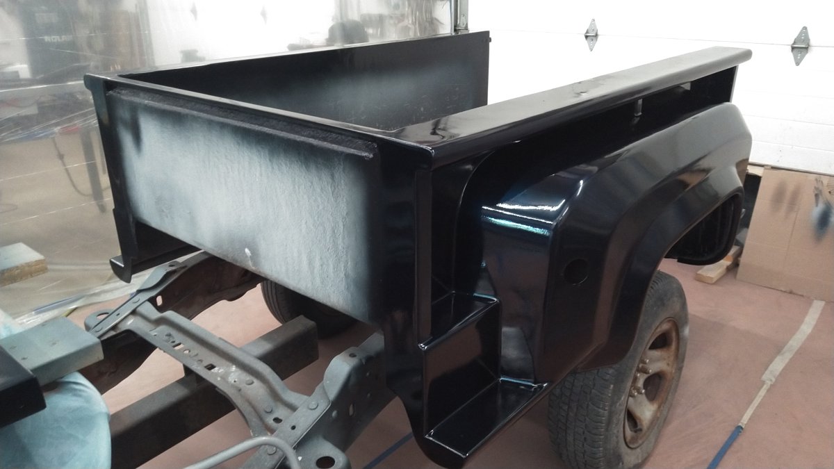

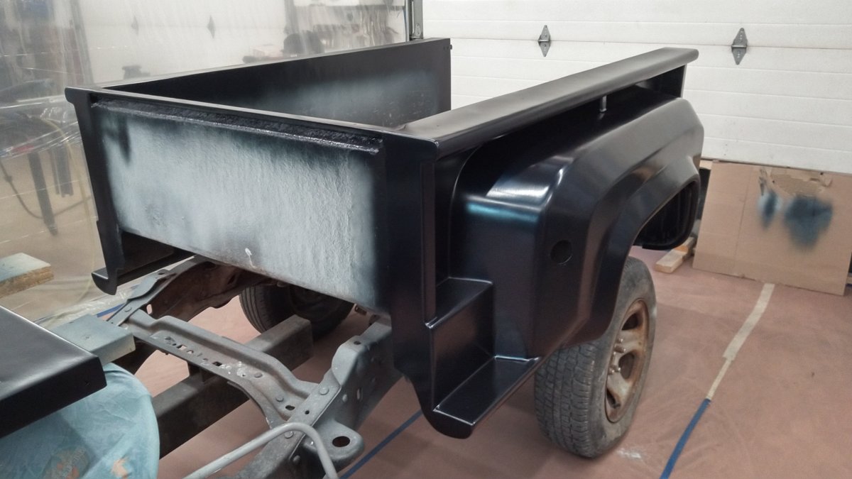

No point in posting pics as it looks the same as it did before but I do have 2-3 additional coats of primer on as of yesterday. I keep finding little pinholes and stuff but I'm down to two spots on the box that need to be fixed and I'll spot prime those, then block out all the overspray. If everything goes according to plan I should be painting in the next couple weeks.

Pee/soda/wipe sweat/let base set break... 2-3 coats on, will clear in about 30 minutes. Pretty pleased, everything going according to plan so far.

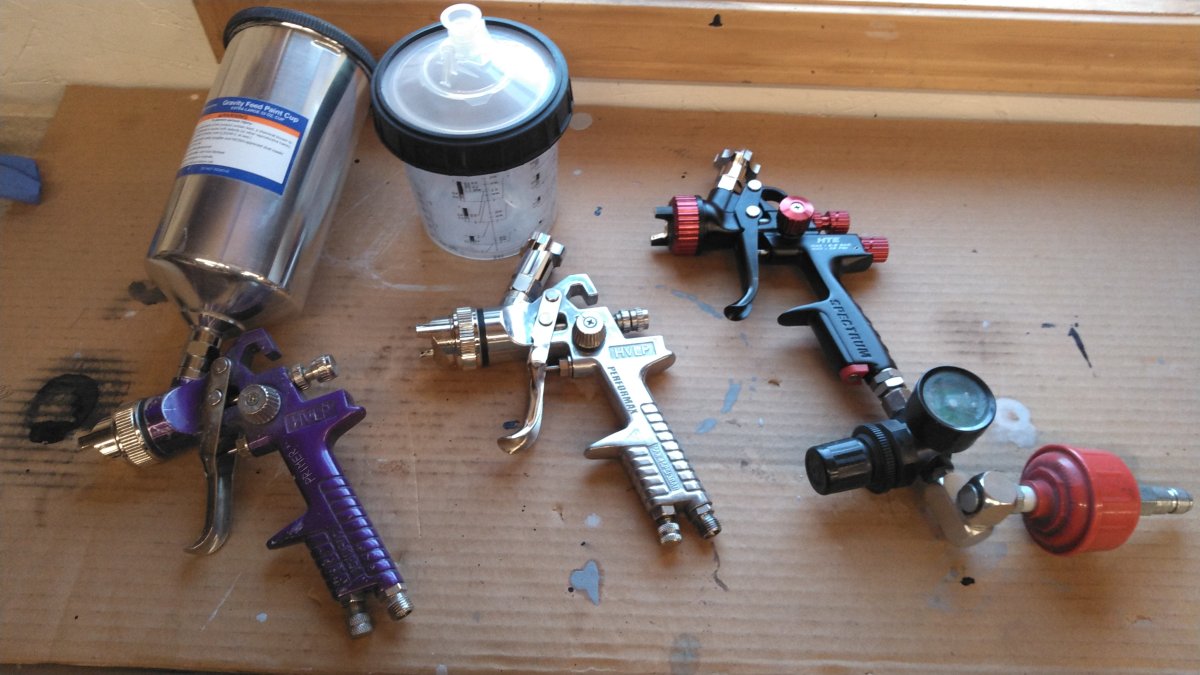

These are the guns I'm using. Purple gun got drilled out to 2mm for primer, middle one is a cheapo 1.4mm gun that I used for sealer and the one on the right is the top of the line Harbor Freight black widow 1.3mm that I'm using for base and clear. I paid like $50 for it used... It's an improvement on the purple guns but I would never pay full price for it. The cheap guns paint just as good.
Also using the new disposable paint cups from HF. I really like them- they make cleanup and really the whole process easier.

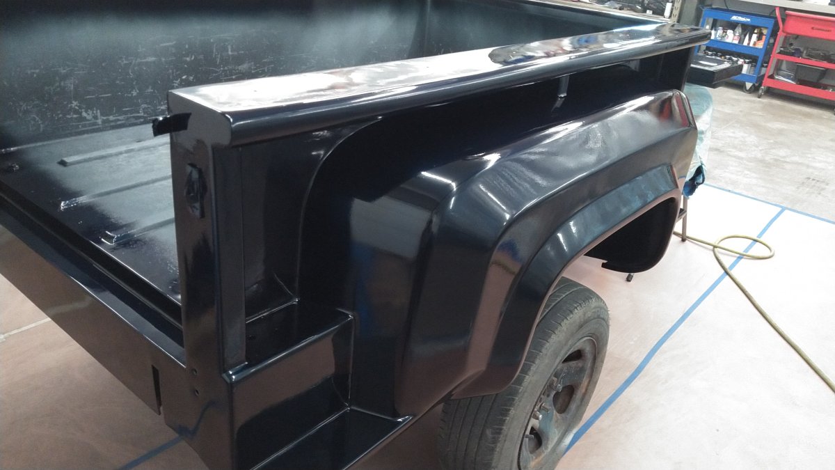

2 coats of clear on. Calling it good. TDS says 15-20 minutes between coats, I gave it 50 and still got a few frickin runs. Oh well, so far very pleased with it other than that.

That step side box sure makes that one unique truck!
Nice Job...
