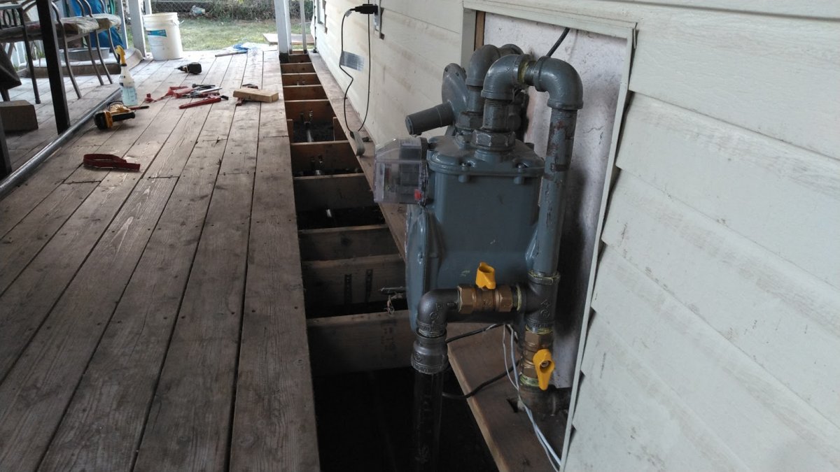

A lot closer to being back on the truck project... finished up the last major part of the gas install last weekend. I ran 20' of pipe under my porch and tapped into my side of the meter, added a couple shutoffs, etc. Also ran my Cat5 cables into the house and got them tied into the patch panel and set up a wifi router in the shop. That's probably my favorite part so far, now I don't have to stand near a door or window to get coverage.
Just need to run a thermostat wire, install the heater vent stack, hook up a power cord and connect the gas to the heater now and I'll be done.
