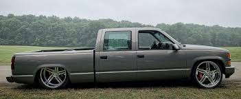

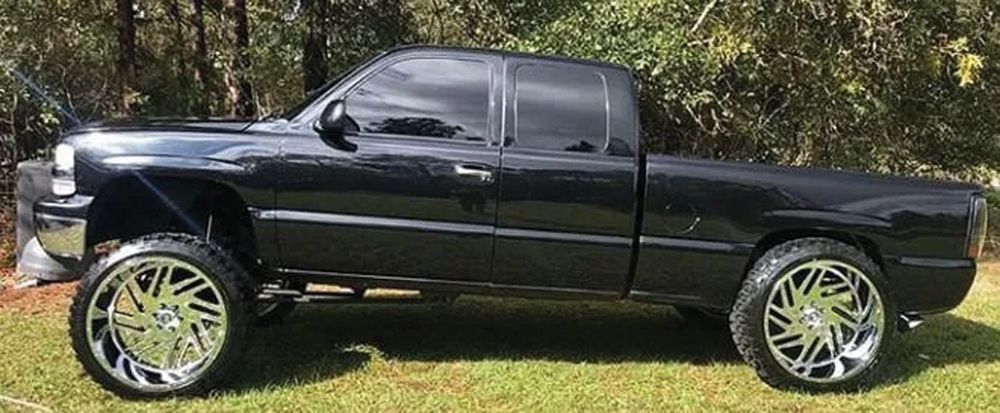

There IS a reason other than looking goofy, I just don't know what it is. @ZMan may be on the right train of thought. You may be thinking of the current "squatted stance" full size trucks are going through. That's definatley a "fad".
this
is not the same as this
