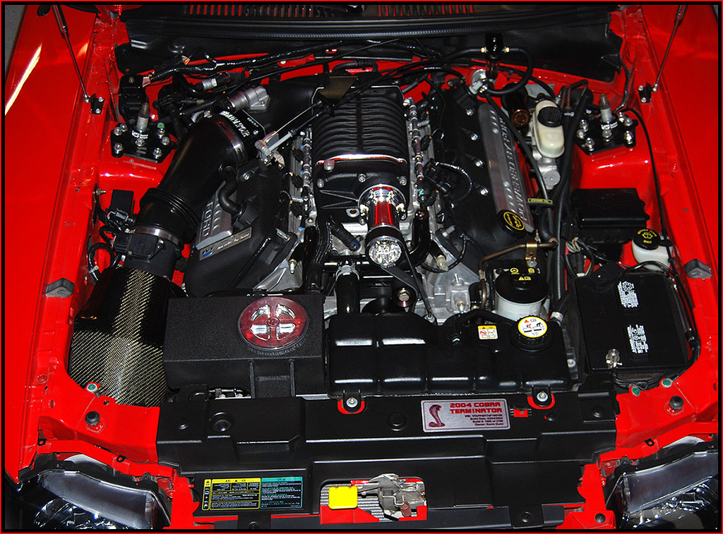

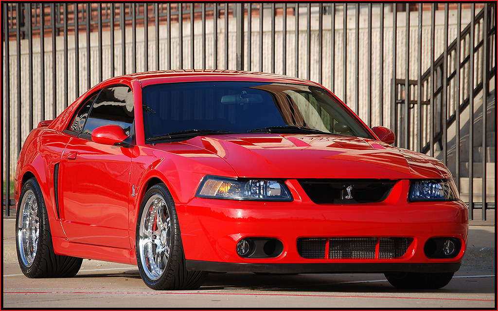

I too had my fair share of Fox Mustangs. 5 to be exact.
My last mustang was an 04 Cobra that I spent 5 years building.
Whipple 2.3 @ 22 psi running on E85 fuel. Made 720 RWHP and 668 RWTQ!
Had to sell it though. Looking for my next one now.

Nice feature! I used to read that magazine religiously, seems like I should be learning from you sir.
Seeing the cobra and the write up makes the thread jack totally worth it:icon_cheers:
