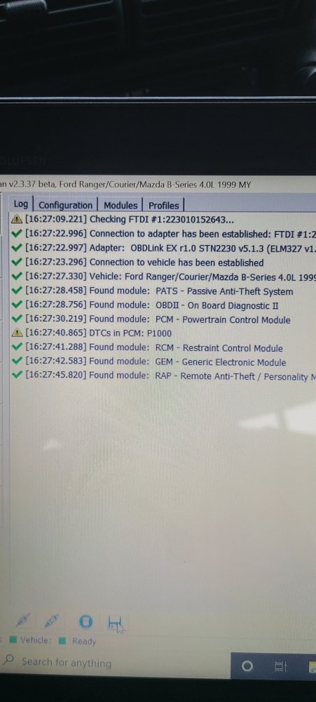

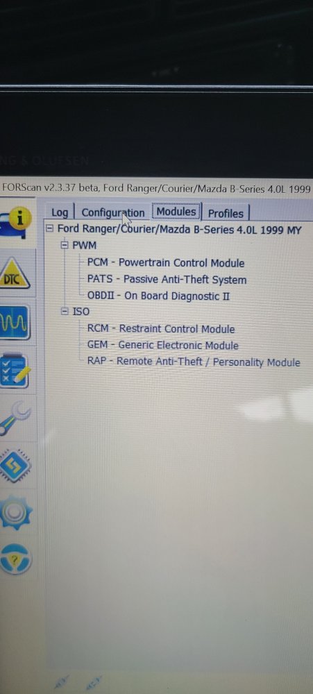

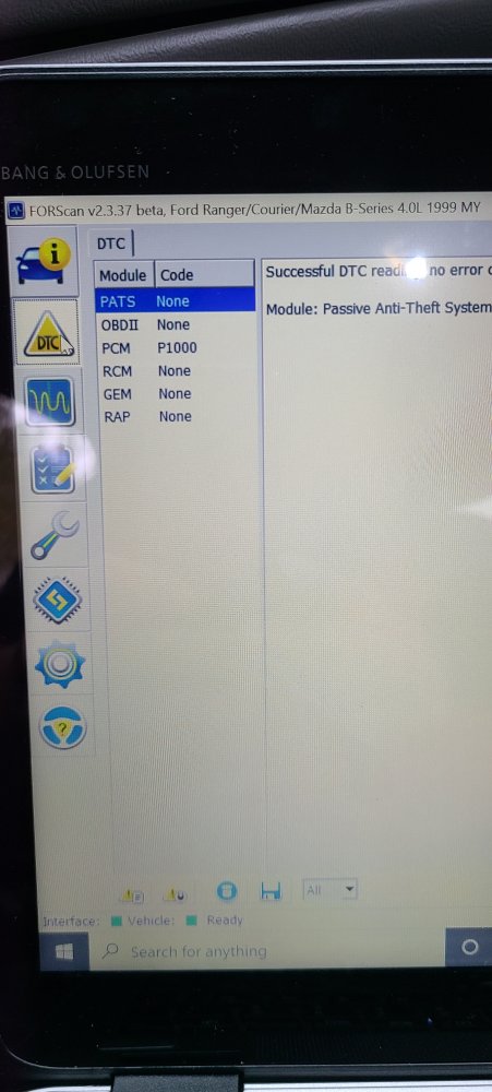

So I get the OBD Link EX get it all setup on Forscan and go to the truck to pull ABS codes and nothing. Doesn't even to be reading the ABS module. Am I doing something wrong here??? Some pics for reference. Very frustrating!

To better describe what is going on. Turn on the truck ABS light is off. Drive down the street at 10-15mph it goes on. Turn off the truck and restart it and the light is off. Drive again at that speed and it comes back on.
Side note changed the brake switch the day before the light went on. So went returned it and tried another switch from another auto part store and it still came on.
This is a shot in the dark at something making noises in the dark.
Try replacing the rear wheel speed sensor in the top of the diff.
You have a missing wheel speed signal with an intact circuit. That's why the light stays off until you start moving. The rear sensor was a problematic part.

Also, don't the ABS codes/data actually come out of the GEM module not a stand alone ABS module?
I just ordered the rear speed sensor as a shot in the dark like you said.
And yeah checked brake fluid and the GEM handles wipers lights and all that stuff, did not see anything to do with braking or ABS in there.
