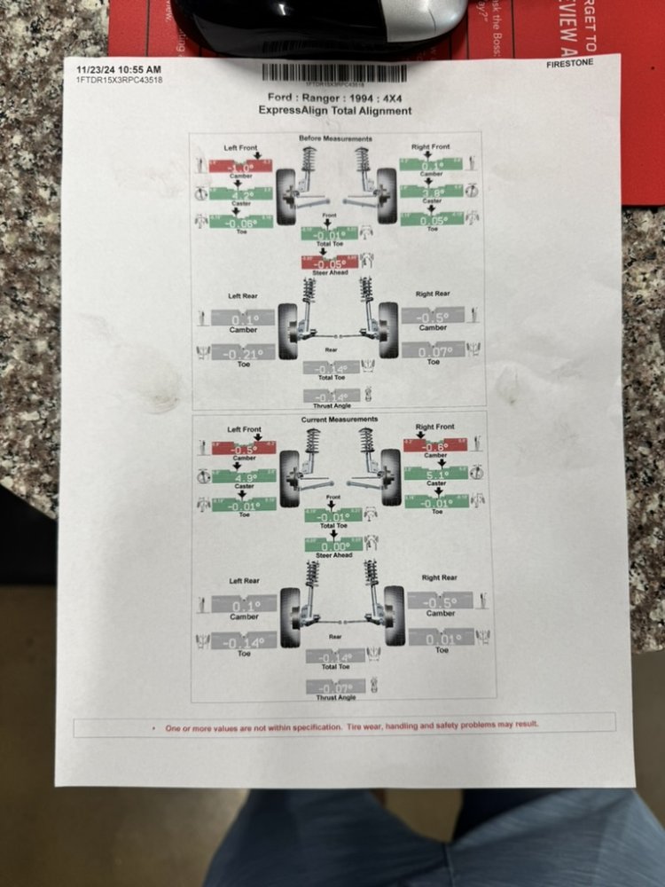

I've had my 94 4.0 XLT 4x4 aligned EIGHT times by Firestone/Bridgestone and the truck keeps pulling to the right. I showed them the tech article here and they were skeptical, saying there was no way to know.
I installed dual-adjustable camber/caster bushings after the first alignment attempt and we've been going in circles trying to get this thing aligned. It continues to pull to the right pretty hard. They've agreed to re-align it with a caster differential to try to correct the pull to the right, but are telling me that I need to tell them how much to change the caster to try to fix it. Any ideas what # we should be shooting for here? I'm beyond frustrated that they keep telling me the truck is driving straight only to pick it up and find that it is definitely NOT driving straight.

Latest alignment:

By those numbers, it should be driving straight. I'm curious why the caster isn't in spec on either side. But I also think caster is one of the least important specs in the alignment.
A pull to one side could be caused by other things - brakes (bad caliper or hose) wheel bearings loose or bad tie rod ends/ball joints that allow things to move out of adjustment as you drive, and even tire problems.

Step number 1 is to find a qualified alignment tech who will adjust everything to the prefered spec. The camber is "in the green" but that isn't good enough and the caster is out of the ball park. The negative camber on that sheet will wear the inside edges off the tires. Our roads are crowned so we always used a .5 degree caster split to offset it. Apparently Michigan doesn't crown their roads so we had to realign the first 6 months of Explorers because they all pulled right. A properly aligned vehicle in NH will have a slight right drift in the right lane on the highway and a slight left drift in the left lane due to road crown.
I see Camber is whats 'out of the ballpark' (in the red), Caster is green.
IME the caster split needed on these trucks is usually around 0.5-1° or so, pass-side being higher (you have 0.2°).
Given the amount of drift I see in that video, (just based on my own experience) I'm thinking subtract 0.7-0.8° caster on the driver side (or add that amount to the pass-side) should get you pretty close.
The camber can be corrected either at the bushings, or you can also do it by putting a washer or two under each of your coil spring seats (giving you about a ½" suspension boost at the same time). If you use washers, do it before you try aligning it again.

Appreciate all the feedback. I will ask them to aim for ~0.7* subtraction from driver (or add to passenger side). This whole thing has been a PITA trying to find a tech who is willing to take the time to do it. Firestone/Bridgestone keeps telling me they've got some old-school tech at another location who will be able to solve it and then nothing changes when I pick it up. Crazy.

Why did they set your camber out-of-spec negative? Even with fixed bushings, your alignment choices for the correct caster would be to add or subtract however much corresponding camber.
