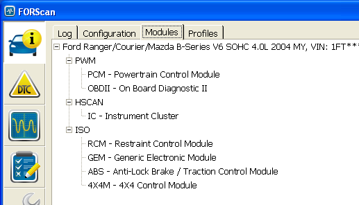

For comparison, here's what FORScan shows for my 2004 Ranger:

Interesting. If it's an honest-to-goodness node on the OBD2 bus, there are ways to "ferret out" the nodes and it could be manually queried, but I really would think that FORScan would've found it. The fact that it didn't makes me worry (for the OP's sake) that maybe it's not really on the bus.

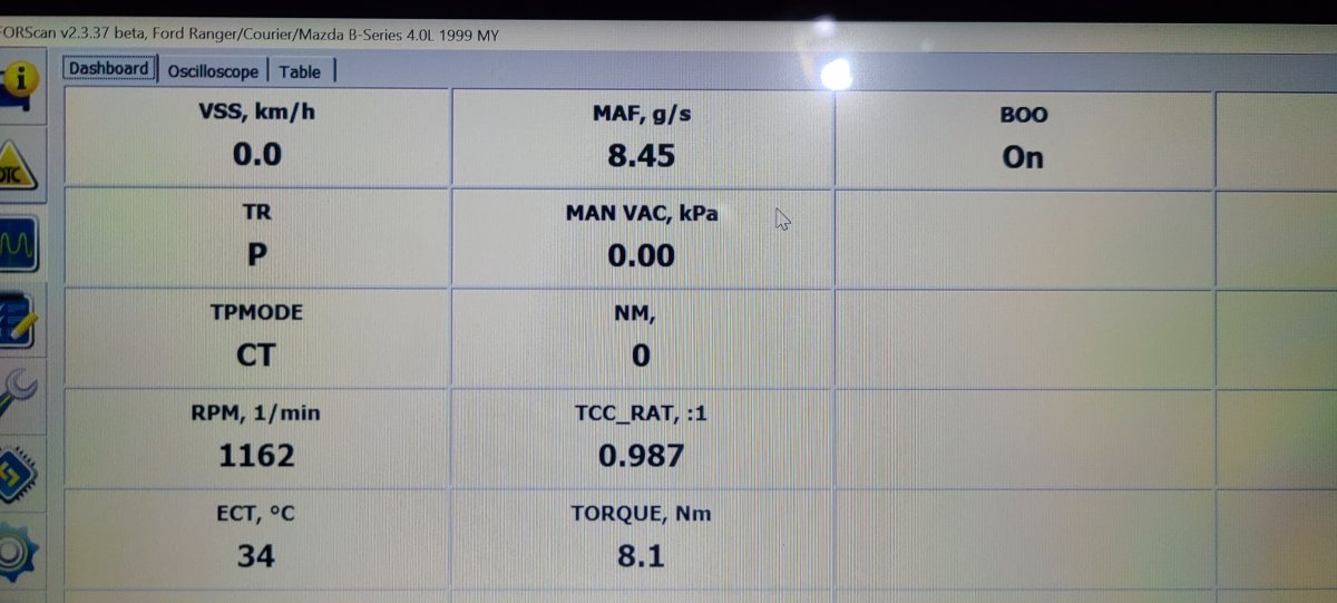

BOO in FORscan says on:
Not enough info. Is that with you pressing the brake or not pressing it? Test it both ways.
In fact, I edited my earlier post because I saw evidence that the "BOO" signal may not be present at the PCM on a RABS 1999 Ranger. Do you know whether your Ranger is 4WABS or RABS? I don't know the easiest way to tell the difference. I'd look for wiring to the front wheels to confirm 4WABS, but some of the veteran Ford guys probably have a quicker way.
Also, see if FORScan offers any other PCM-module, brake-related PIDs (Parameter IDs) that you can monitor, other than "BOO" (Brake On/Off). Maybe not, but it's worth a look.
Also, I forgot to ask earlier: Is your red dashboard "BRAKE" (not "ABS") lamp illuminating as part of the self-test when you turn the key fully on? It should also illuminate when the parking brake is engaged. Does it?
Yeah pressing brake on and off and BOO only says on. However i did not try it while car was on.
