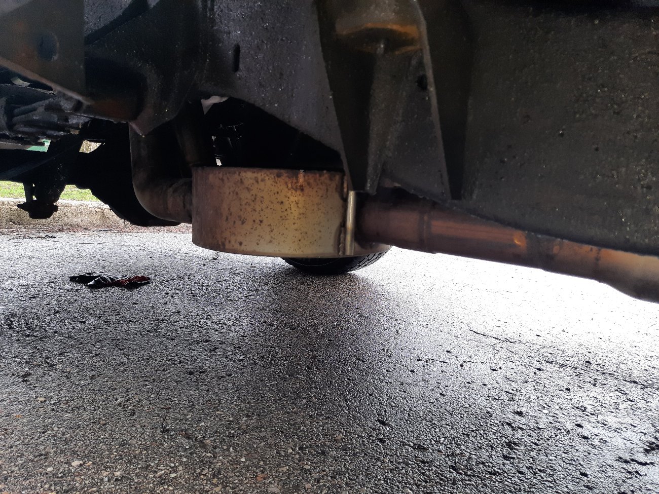

Recently purchased '98 B4000.
I don't have a lot of detail on the exhaust equipment make and model, but I know the previous owner installed:
  • Two high-flow cats
  • A muffler that's barely wider than the exhaust pipe
  • Vibrant resonator
  • Dual 3" exhaust
Truck also has a K&N air filter that's likely contributing.
The resonator makes my head explode at 3000rpm.
Should I replace the muffler first? If so, what would you recommend?
Restore the factory airbox?
Thanks

Yeah, I was afraid of that. It's 3" from the manifold, which means I'll basically need to replace everything to get it back to stock. Money is definitely a concern, so this will likely need to wait. Aside from a different throttle body, I don't think the engine is modified at all.
What is this thing:
  • How to make the truck a bit quieter without sacrificing character/performance
I took the truck into a reputable exhaust shop. They said the "muffler" is completely custom, and not really doing anything. Just a fancy 1-to-2 splitter making the whole system louder. They chopped that out and inserted a proper muffler. Left everything else alone to save me money. They were impressed with the 304 stainless system and agreed it made no sense having 3" pipe, but still suggested I keep it. Said it probably cost the previous owner thousands... Verdict: The exhaust is still very loud, but doesn't sound quite as awful. So I suppose it's a win. Definitely quieter in the cab.
