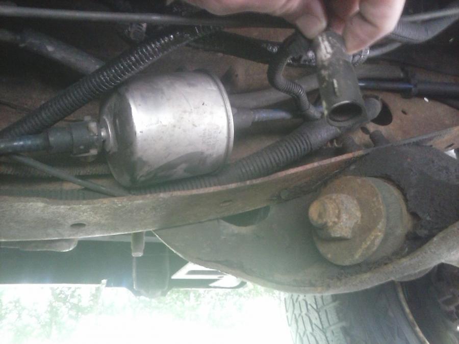

Yes, I have that black inline reservoir which was changed a few months ago as I thought the filter may have been clogged and causing me to smell gas all the time around the driver's door. (First Pic below)
How to: Install inline/high pressure fuel pump (86 ranger 2.3 gas)
There is no inline fuel pump on the truck right now. I'm surprised the in tank pump didn't burn out yet.
I was wonder where the inline pump is supposed to get hooked up. And looking in your picture it looks like its before the inline fuel filter.
Also, in the first picture I am pointing to a green fuel line/vapor line coming from the tank. Is this what goes into the inline fuel pump?

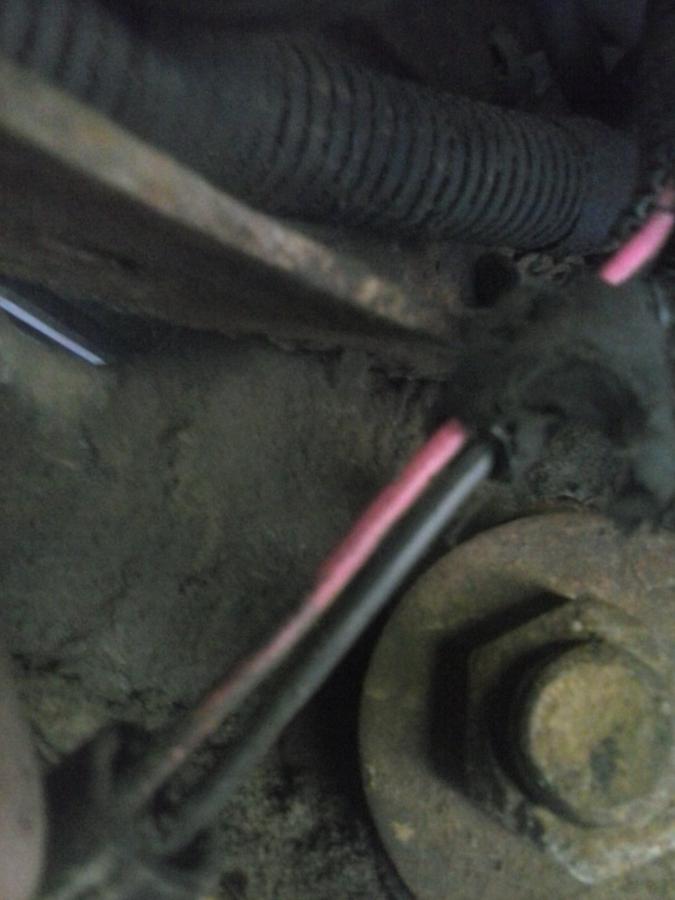

Also, in the second picture is the inline fuel filter where their is also a wire connector/pigtail that isn't connected to anything... is that for the inline pump?
The wire to that connector are pink and black (Third Pic)

The gas flows to the side with the terminals on the fuel pump correct? and the other end says its supposed to go into the filter. So I am assuming the fuel pump should be hooked up to the frame after the fuel filter.. thoughts? corrections? diagram?

If you have a low pressure lift pump feeding a frame mount filter--> then the filter out goes to pump in, outlet of pump to engine fuel rail.
While not very scientific, the one high pressure pump on my bench has electric fittings on the out side. Simple test squirt both ends with wd-40ish oil, bump pump w/12 volts and watch (1 sec or should be long enough) the squirt. Alternative method is figure out which way the check valve works (probably a bit safer) and lung pressure is enough.
The high pressure pump should be between the low pressure filter/reservoir and the high pressure inline filter. Pretty sure your pigtail is supposed to power the inline pump. As to which end is which, I'll try to get around to crawling under the '87 tomoroow to check it out if no-one has settled this by then.
The 2nd line up by the inline filter is your fuel return line! No wonder you have a fuel odor under your door. Gotta sneak another peak at your reservoir, but I thought both delivery and return lines hooked up to it (2 lines in each direction)
