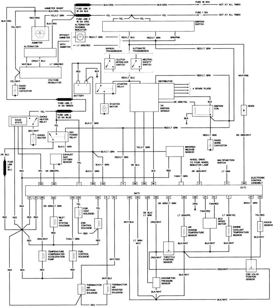

Green and yellow wire on the coil, I use an alligator clip to connect to the terminal, then clip the tach to the alligator clip.
IS the Dk GRN/YEl the negative wire going to the coil then?
