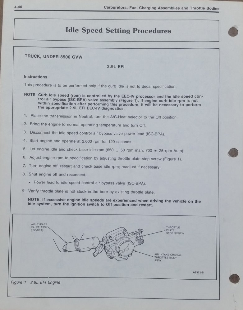

So i had a surgeing, kinda low idle i was blaming on the charging system. I still think that might be an issue but i happen to run across this...
How to- 2.9 idle adjustment
I know the 2.9 is famous for its shitty idle, but i did this procedure and inital results are amazing. It idles about as good as my 97 460. Ill update this post as i drive it more...but wow what a difference.
Could a mod sticky or put this in the FAQ?

I need to get a laser tach and get it real dialed in....i think it might be just a smidge high yet...but way better then it was...idled way low and loped like a drag cam. Its pry in the 800rpm range right now...but with my POS exhaust its hard to tell...it might be right on.

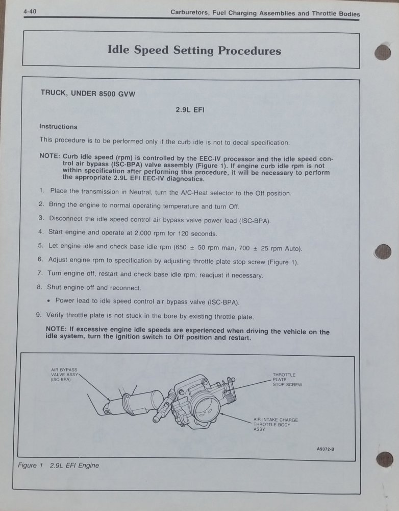

Thats good info to keep. What type reference manual is it in? None of mine have it. I stumbled on this when i did the top end on my 87 three years back and the idle hasn't changed at all. I remember 2000 rpm for 2 minuets and it died as soon as i took my foot off the pedal, off by 2 turns in. Thanks Dirty
Im not sure. I found it on google
Ford 1987 Engine/Emissions Diagnosis Shop Manual. If you have the breakout box, this shop manual is a must have.

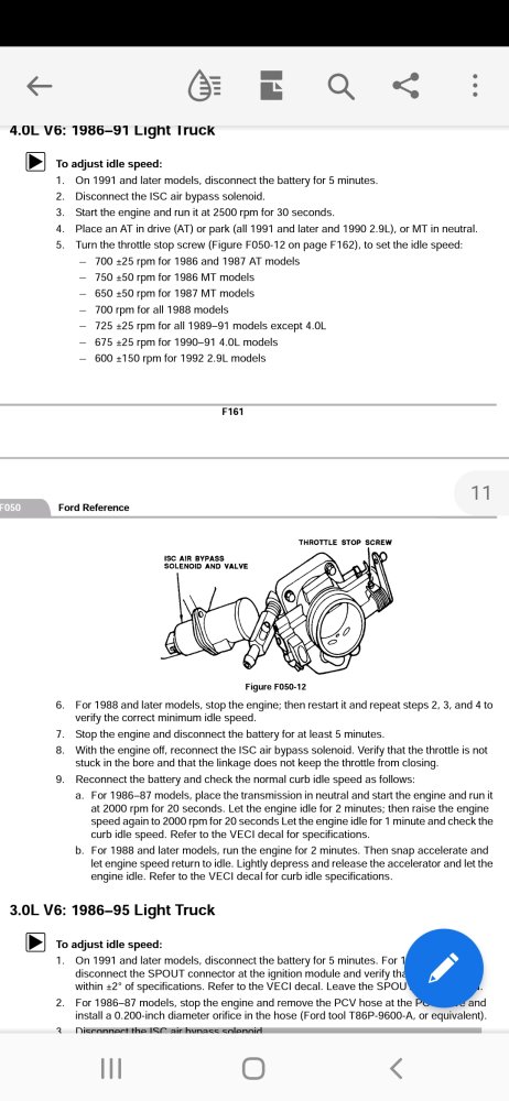

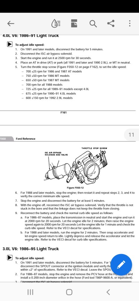

My issue is a low idle and if I use the stop screw to raise the idle it going to push the TPS voltage over 1V and mess with the computers parameters....i also found this on another site that breaks it out a bit more by the years

My issue is a low idle and if I use the stop screw to raise the idle it going to push the TPS voltage over 1V and mess with the computers parameters....i also found this on another site that breaks it out a bit more by the yearsView attachment 84084
I would verify that your IAC and TPS is properly functioning before attempting to manually adjust the idle.
I had a low idle on mine that was the result of me screwing with the screw before, this procedure helped me get it set properly after the IAC and TPS didnt help.
If that is the case you might have to hog out the screw holes on the TPS so that it has more adjustment room and then turn it accordingly.
Dang, '87 2.9 is supposed to idle at 650RPM +/-... might have to mess with mine a little more... it stays around 800 after doing the original procedure in this thread.
My under hood sticker is a hundred r0m higher than this chart shows too....
