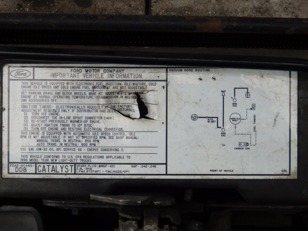

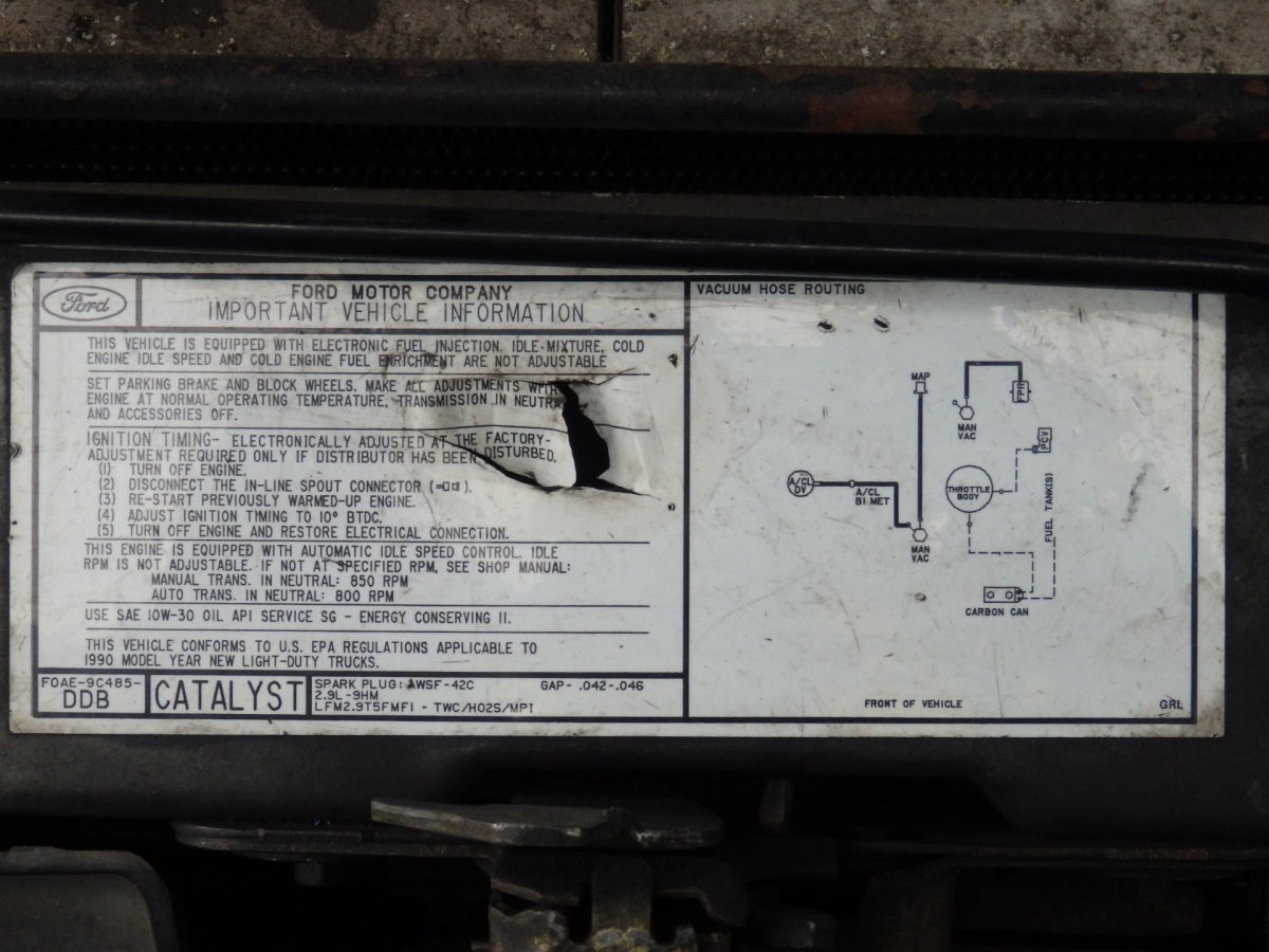

I know the oil weight is wrong on this label but is the Idle RPM correct ? (1990 2.9, AT)

Late reply but oil is incorrect. Label should state 5W-30.
I want to say even a few 1994 4.0L trucks I've had specified 10w30. I think your label is correct for your model year.
Well I've got the original OG & it states 5W-30, unless you live in an area like Death Valley you would use 10W-30.
I've been running 5W-30 for the 15 years I've had my truck without any ticking issues.
I read somewhere (& maybe here) that Ford didn't keep all there labels updated. Who knows ?
