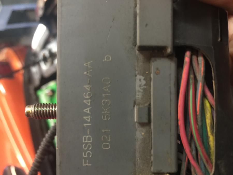

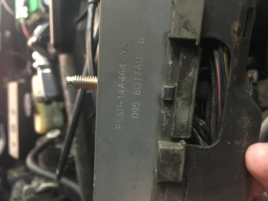

I have 1997 Ford Ranger XLT 4.0l 4x4
The previous owner messed up part of the engine wiring harness. I have been trying to find the harness I can use to replace all the messed up connectors but I cannot seem to find the exact one that matches my truck. Surely Ford didn't use a different harness for every truck.
One of the harnesses I have tried matched up with what looked like everything but when I look at the plugs that connect to the firewall there is a series of numbers that are different. The wires are also different the harness I have now has multi colored wires and the other has black with colored stripes.
There has to be a way to get the right harness so I can fix the electrical issue the photos that are attached show the numbers I am talking about.

Top pic looks burnt or really dirty. I would think the core wiring harness would be the same for a given year range?

It is just really dirty I am not going to use that regardless. I am just confused why it is the numbers do not match up and the wire colors. Especially from what I can tell has all the right connections.
They will clean up to color. The top number is all you need to be concerned about.
Match up the year, engine and drive train type. The first two digits are the year F5 is 1995 and 1997 should be F7. D is 1970s E is 1980s and F is i990s
Yeah, those two harnesses are the same. Or at least they should be.
The first set of numbers IDs the year and model the part belongs to. The center section IDs the part itself. The last set is a revision level. Those lower numbers should just be serial numbers, or something of the like.
Well if f5 is a 95 harness why is it on my 97 truck?
I've looked everywhere trying to figure out what numbers should match even got on ford parts website the other thing that seems to matter is if it is a California emissions truck
This harness came out of a 97 ford ranger XLT 4.0l but it was a manual and mine is an automatic that's why I'm not using it

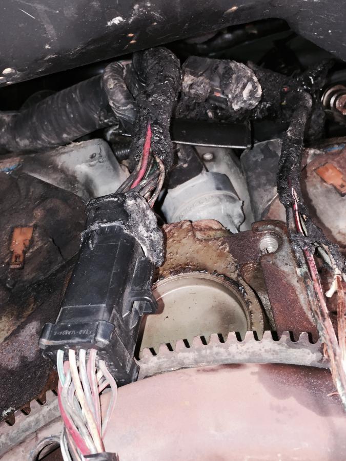

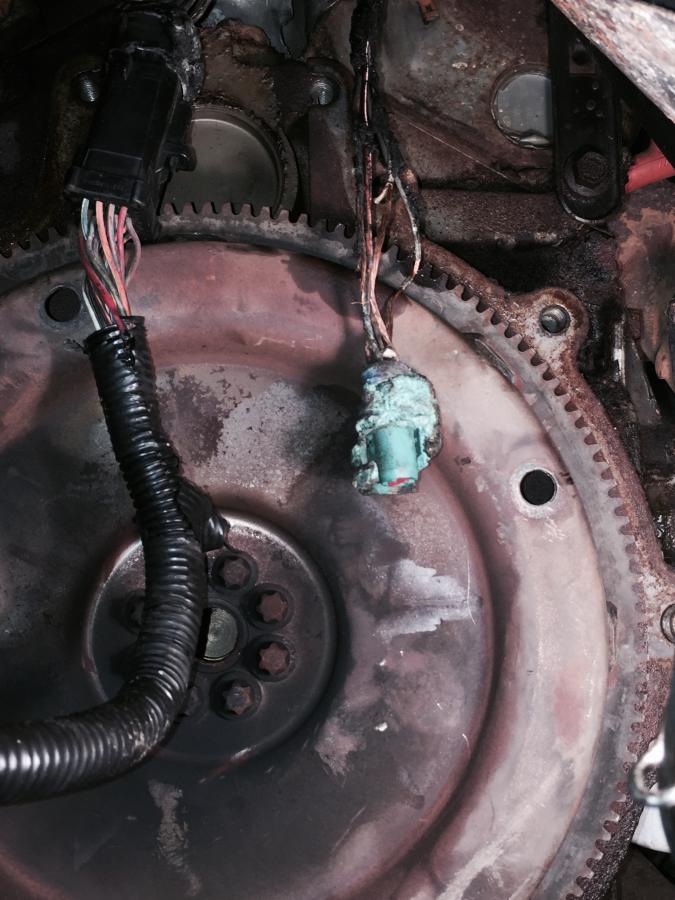

One of the fried connectors goes to the passenger side upper o2 sensor and the larger black one I'm assuming transmission

This is the large connector I'm talking about

its a trans and o2 plug, i would run a seperate system when i located one. it dont look ike a 97 though to me for some reason. i dont remember the jumper being there. but thats just it. these systems can change through the year.
