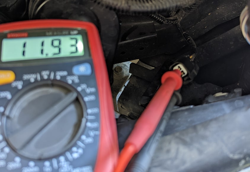

Hit a small speed bump and my horn has stuck on. This happened one other time while off roading but it turned off after a bit that time. Unfortunately this time it will not turn and I had to pull the fuse.
I took off the airbag and the horn switch/clockspring on the steering wheel seem to be fine.
The horn relay makes a click on/off when I press the horn, and same if I swap the relay with the one next to it in the fuse box.
I took the bumper off the get to the horns, and the wire that connects the horns to the harness has a solid 12v no matter the position of the horn relay (on or off). The wire also has 12v if the relay is removed from the fuse box.
What should I try next to fix the horn?

The horn is connected to a constant ground source. It comes on when the horn switch sends a ground signal the BCM. The BCM then pulls the horn relay coil to ground to activate the relay. Power is then sent to the horn.
I you can pull the horn relay from the panel and you still have 12 volts at the horn... the horn wire is shorted to battery positive.
Most likely culprit would be a short in the battery junction block or a short in the wire bundle near the junction block.

If pulling the Horn Relay doesn't cut off the 12v to the horn but pulling fuse 48(20amp) does, then fuse 48 is getting 12v when it shouldn't
So fuse box short circuit to fuse 48 between relay and fuse

I think RonD has it... There's probably not a lot of wiring length to look over since it looks like both the fuse socket and relay socket are right there in the battery junction box.
Any electrical mods to the truck? (aftermarket lights, switch pods, etc.)?
