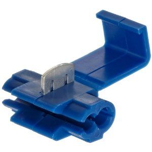

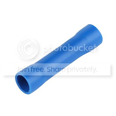

hey y'all hows it going, i've recently (moments ago) finished installing a new Water Pump and Fan Clutch which was a big PIA... but i finally finished, and still my temp's reading rlly high, i bought and installed the sender unit and i also bought the boot connector for it however i dont have an electric solder gun and i dont exactly know how to do it either so im still left with a truck/temp gauge that is reading very near to H on the temp gauge...
i have a blue wire connector the square one like this one:
High temp gauge!!!?? Trouble!? Help!!
as well as a circular one like this one:
i know you said no tape but given the circumstance's and being without a Solder Gun, would these be unsuitable to for connecting the new boot connector? and how far back should i trace the electrical line to replace it with the new boot?
No tape on the threads, where it screws into the intake manifold.
second connector would be best

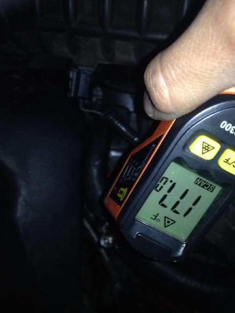

update: i took the infrared scanner and let the car idle until the temp gauge spiked and these were the hottest readings i got [I took temp from the rad neck, the top rad hose, and right next to the temp send unit]
rad neck
upper rad hose
and send unit
so it seem's that for whatever reason maybe the gauge spiking means its simply running at normal op temp???? i guess???
what y'all think??? whats the normal op temp of a ranger supposed to be?
Since the T-stat is supposed to open somewhere around 198'F I guess it should be alright to drive????? However it's still scary as hell, I feel like my engine is gona blow up and shoot straight up into the sky

Use that scanner, 198 is about average for a fully warm ford engine.
If that's what you see with the scanner, all the mechanical is good, the gauge is 3/4, and the gauge has been changed . . . draw your conclusion.
