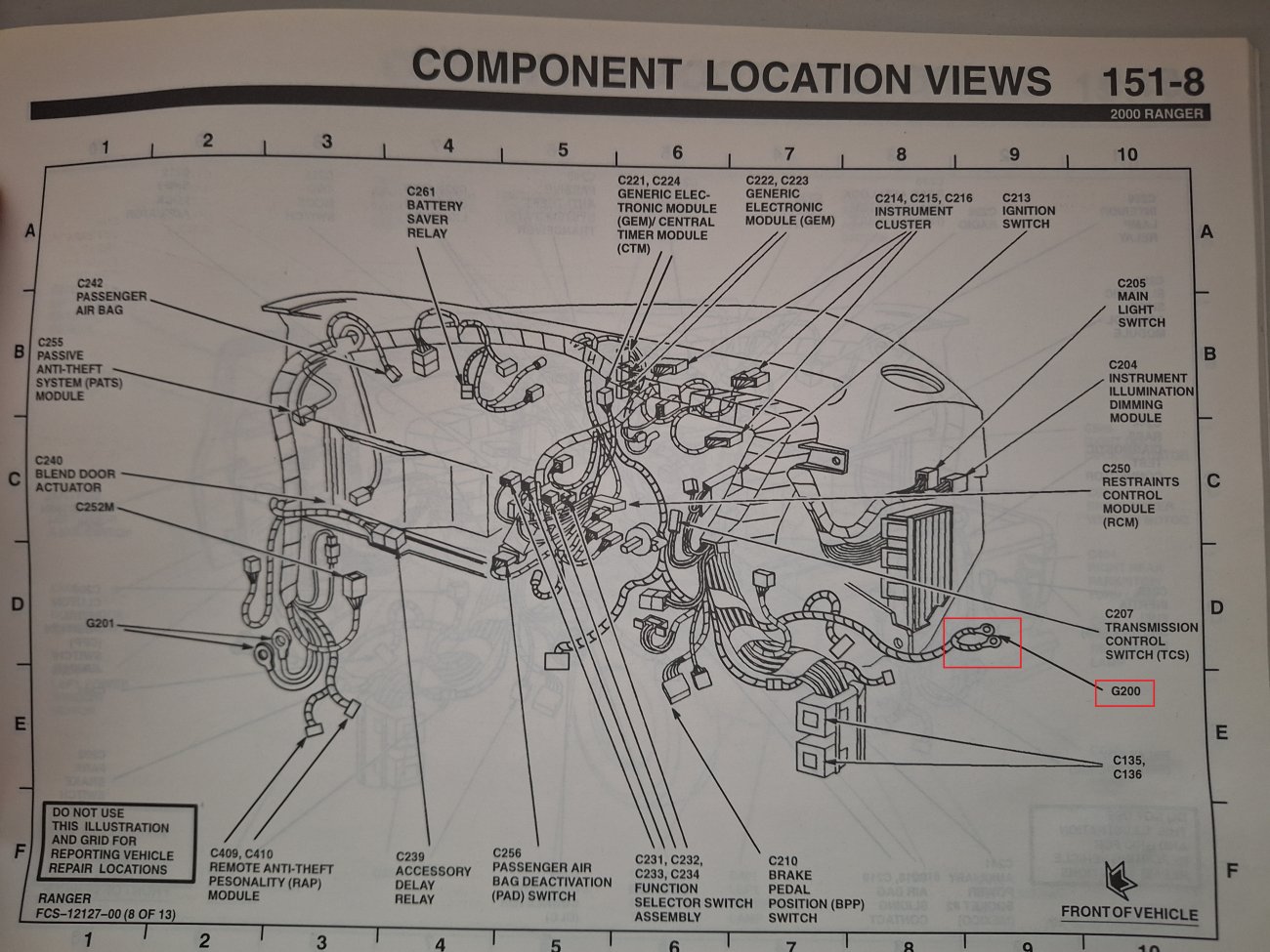

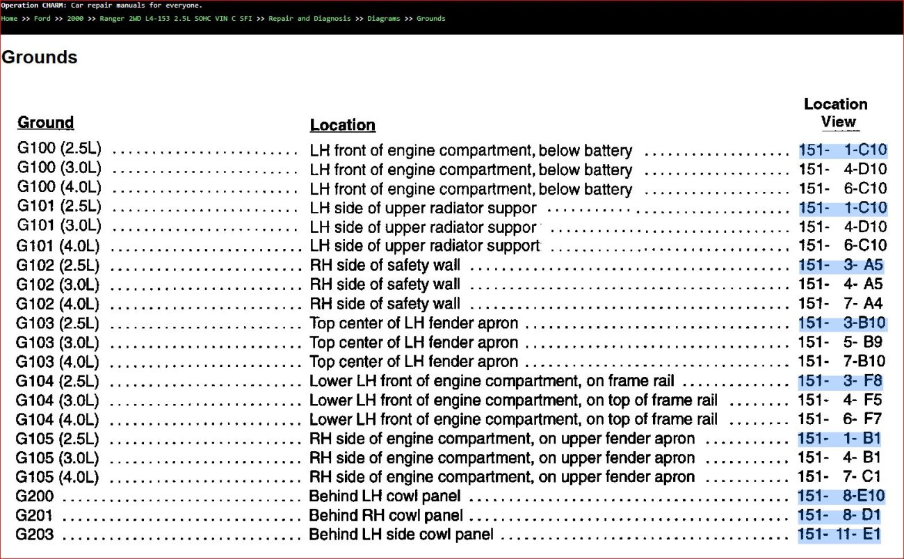

"behind the left hand cowl panel", I believe, is down by your feet, near the parking brake pedal assembly.
can you post picture of the page showing you that ground connection?
Here's the location page from the Wiring Diagram manual-
And here are the ground locations both in the book, and on the vehicle. I got this from a site called Operation Charm which has a lot of Official info and diagrams. It's a free site and has as much, if not more, than
Alldata DIY.

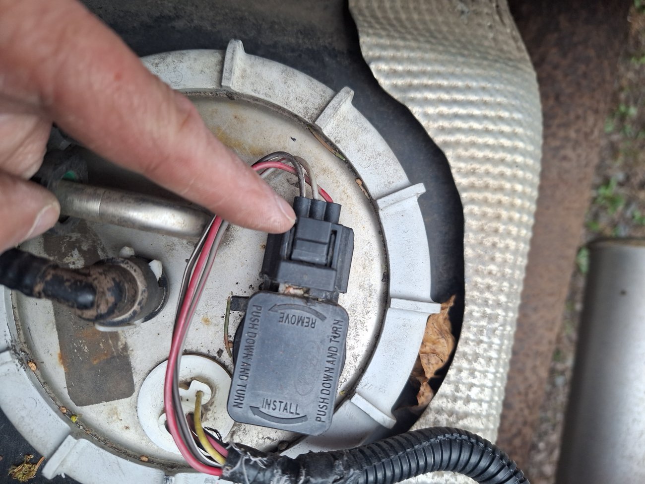

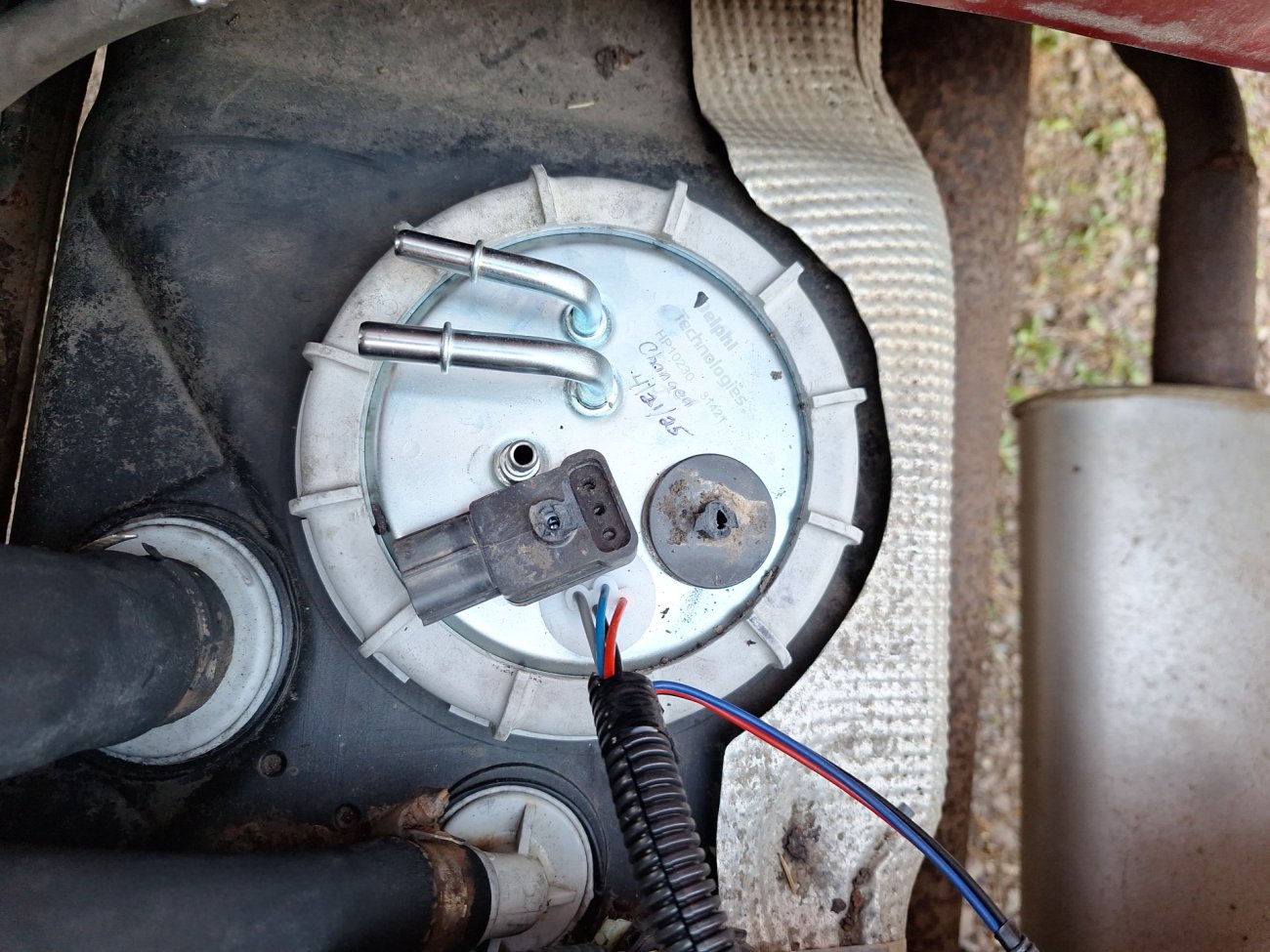

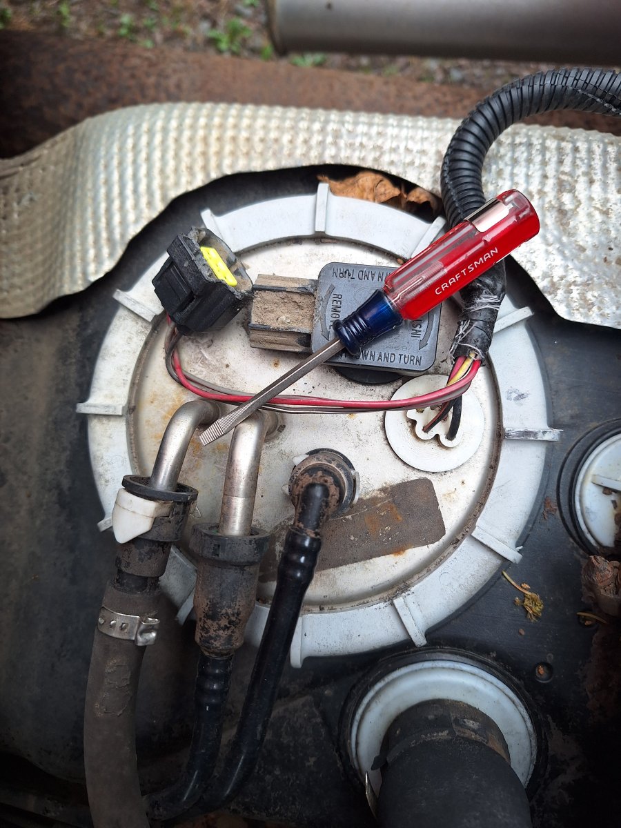

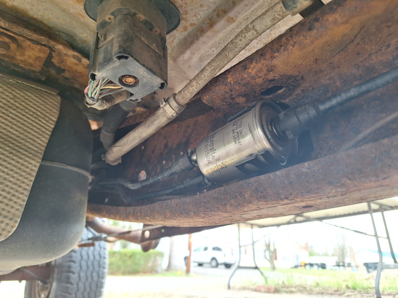

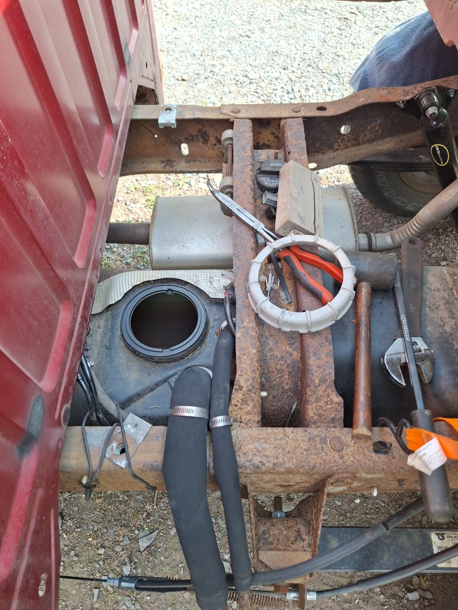

So it turned out to be the fuel pump after all. I put the new one in a week ago and it's been running ever since.
I also changed the fuel filter and the Fuel Tank Pressure sensor, since I snapped the old one in half trying to transfer it to the new pump. It was totally my fault, not gonna lie.
I got it running Thursday 4/24 since I had to wait for the new FTP sensor to get here from Rock Auto. I treated the new sensor like it was a priceless Faberge egg lol, and I had a hell of a time getting it seated into the new fuel pump. After about an hour of trying to push down and turn at the same time with no luck I did what any man would do when something doesn't want to go in...I spit on it, a lot. It went right in after that.
I was nervous the whole time, it was my first time after all ( First FTP sensor, umm, insertion :ROFLMAO:). The OEM sensor through the Ford Dealer next door was $130, the aftermarket sensor (SMP) was $61.25 so it was RA for the win. Even at $61 I didn't want to buy it twice lol.
It also took quite awhile to get the FTP connector to disengage from the old sensor since it was caked with dirt and debris that turned into a kind of cement. But my trusty old Craftsman pocket screwdriver made short work of it after I realized the issue.
It was a good feeling to finally get that connector to pop loose, but not near as good as that new FTP sensor finally seating into the pump.

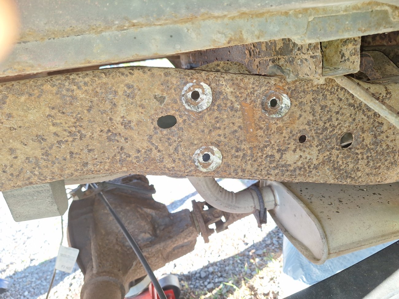

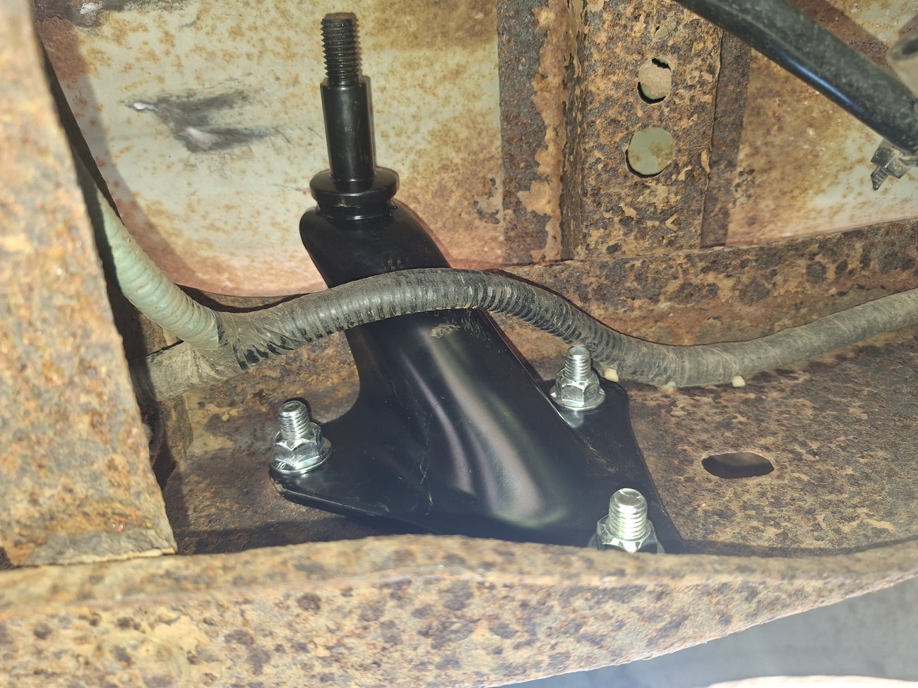

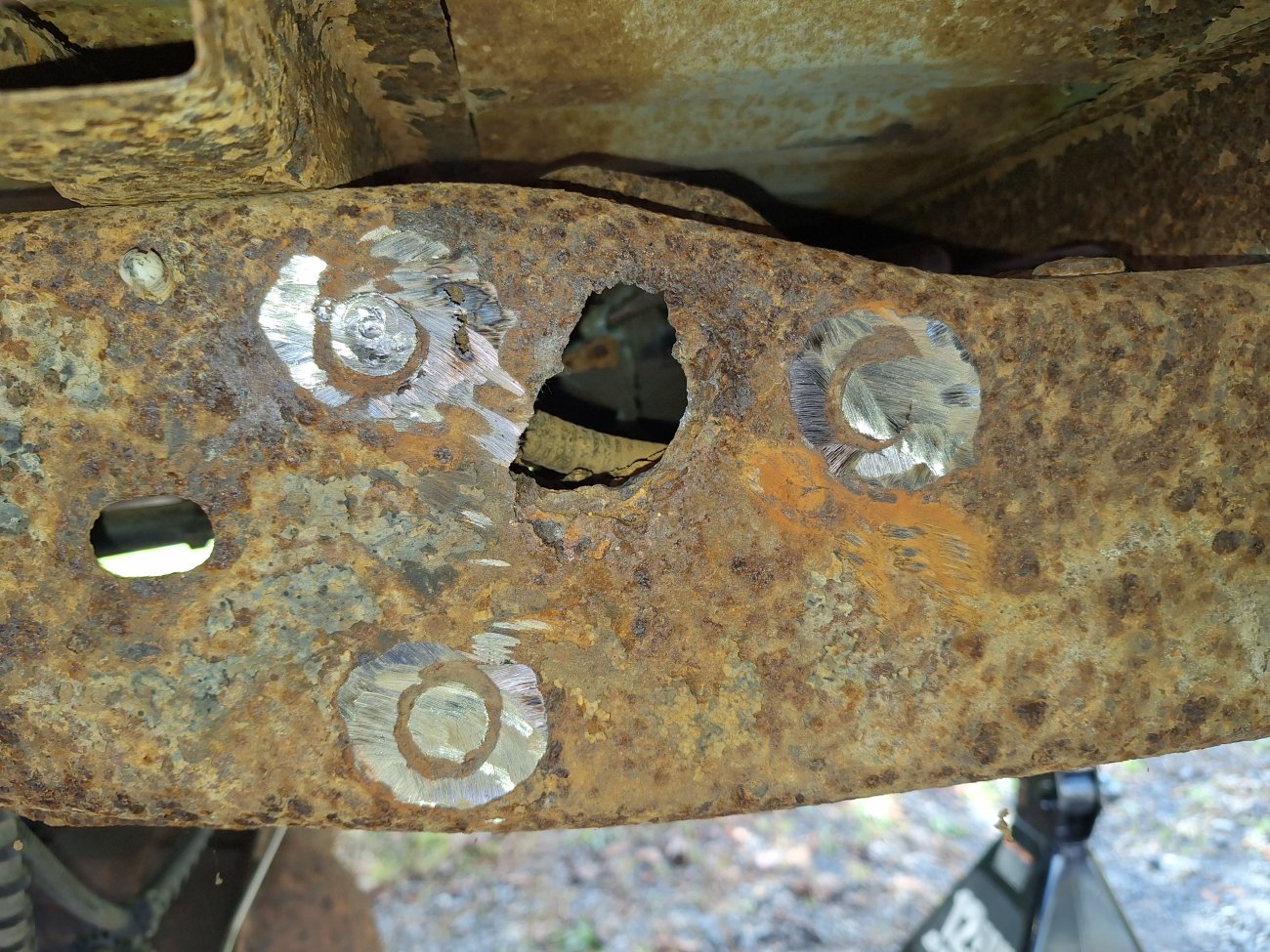

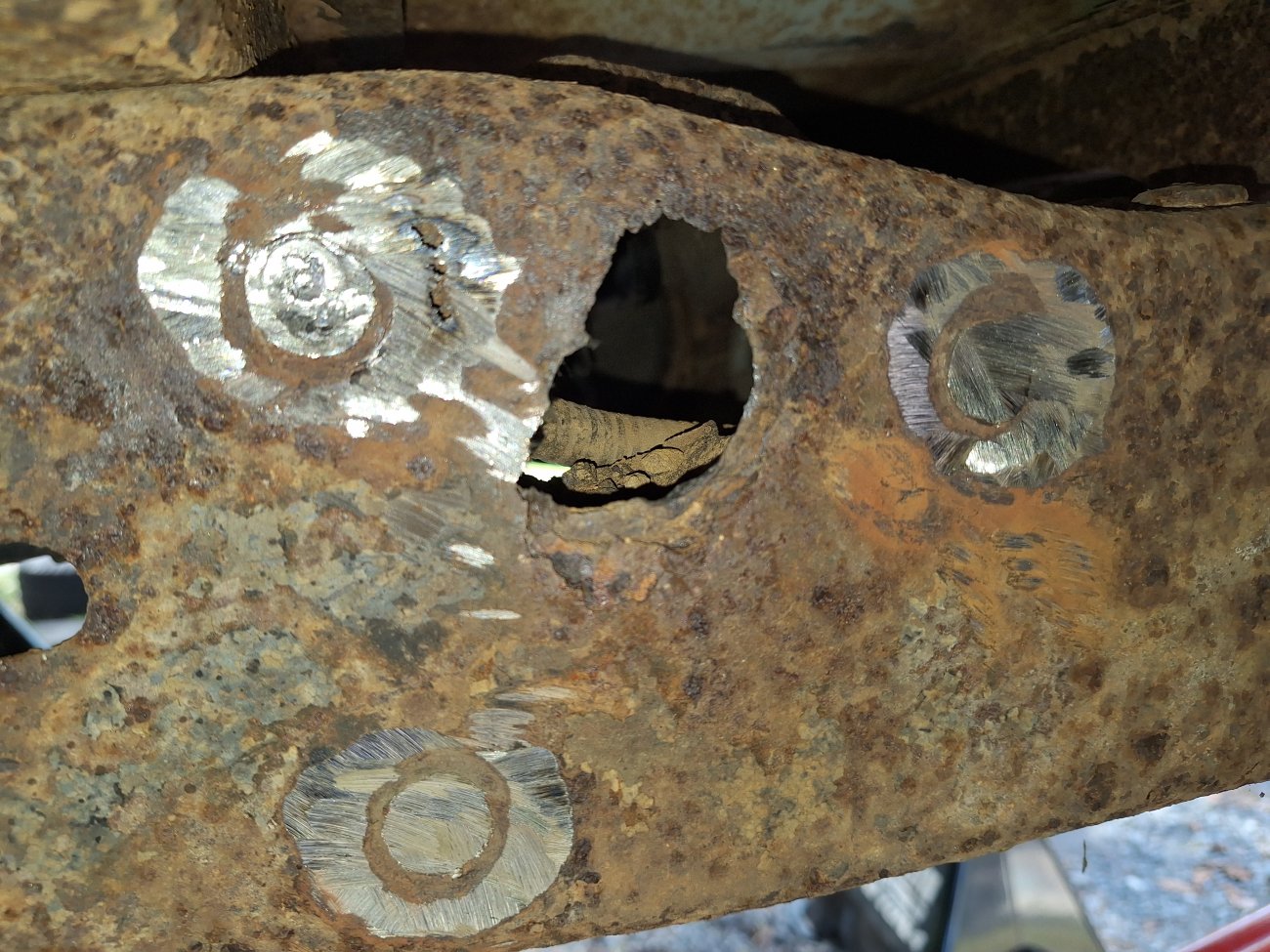

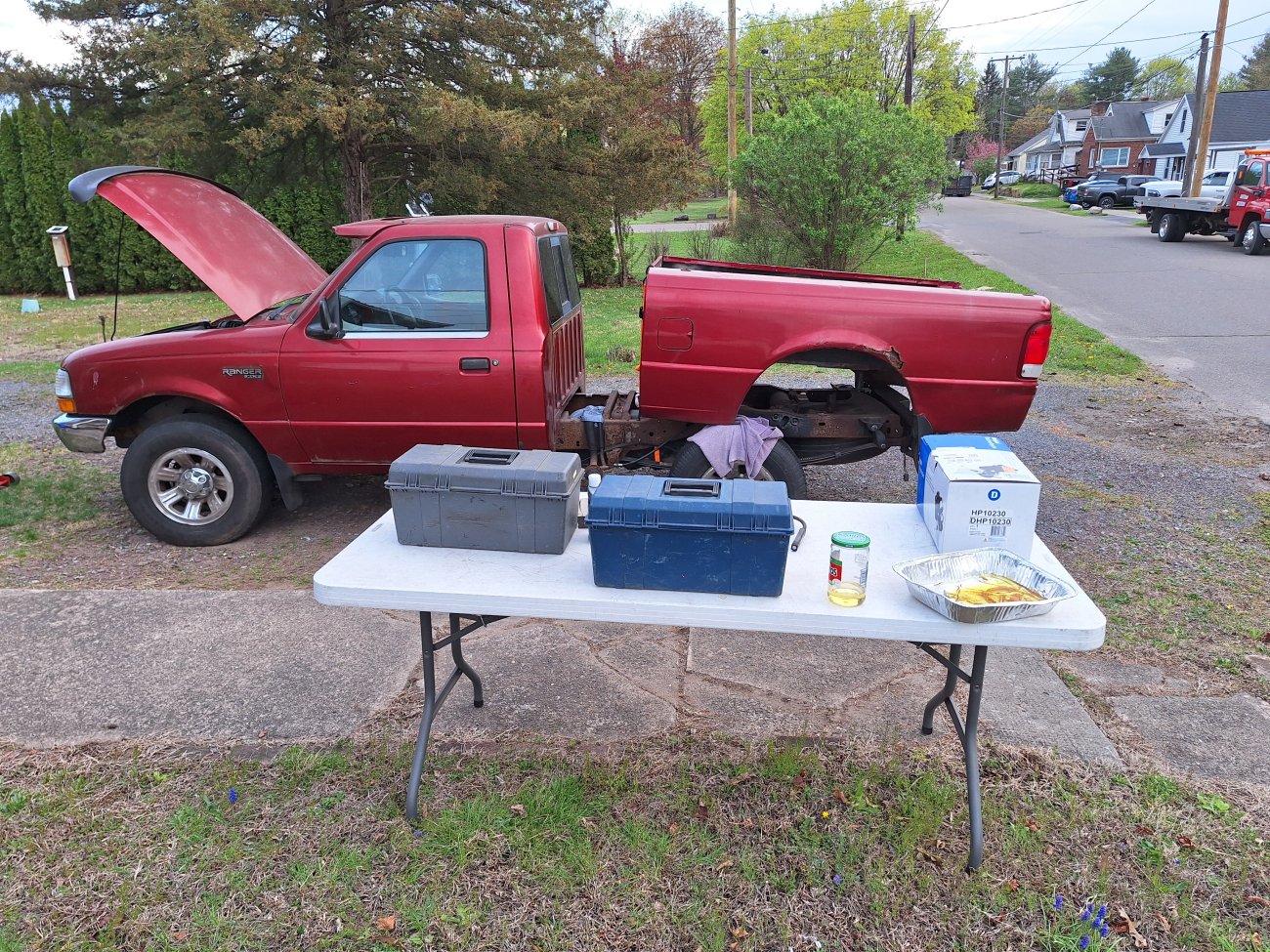

I took some pics to send to my daughter so I reckon I could post them here-
Note- I'm pointing at the FTP sensor connector in the one pic to show her what it is and what was stuck in place when I was trying to get it loose. I've been trying to spark an interest in her about mechanics and how things work since she was little although I haven't gotten much of a spark at all. But I'll keep trying.
And the pictures are in no particular order.

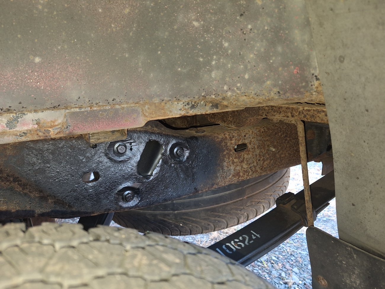

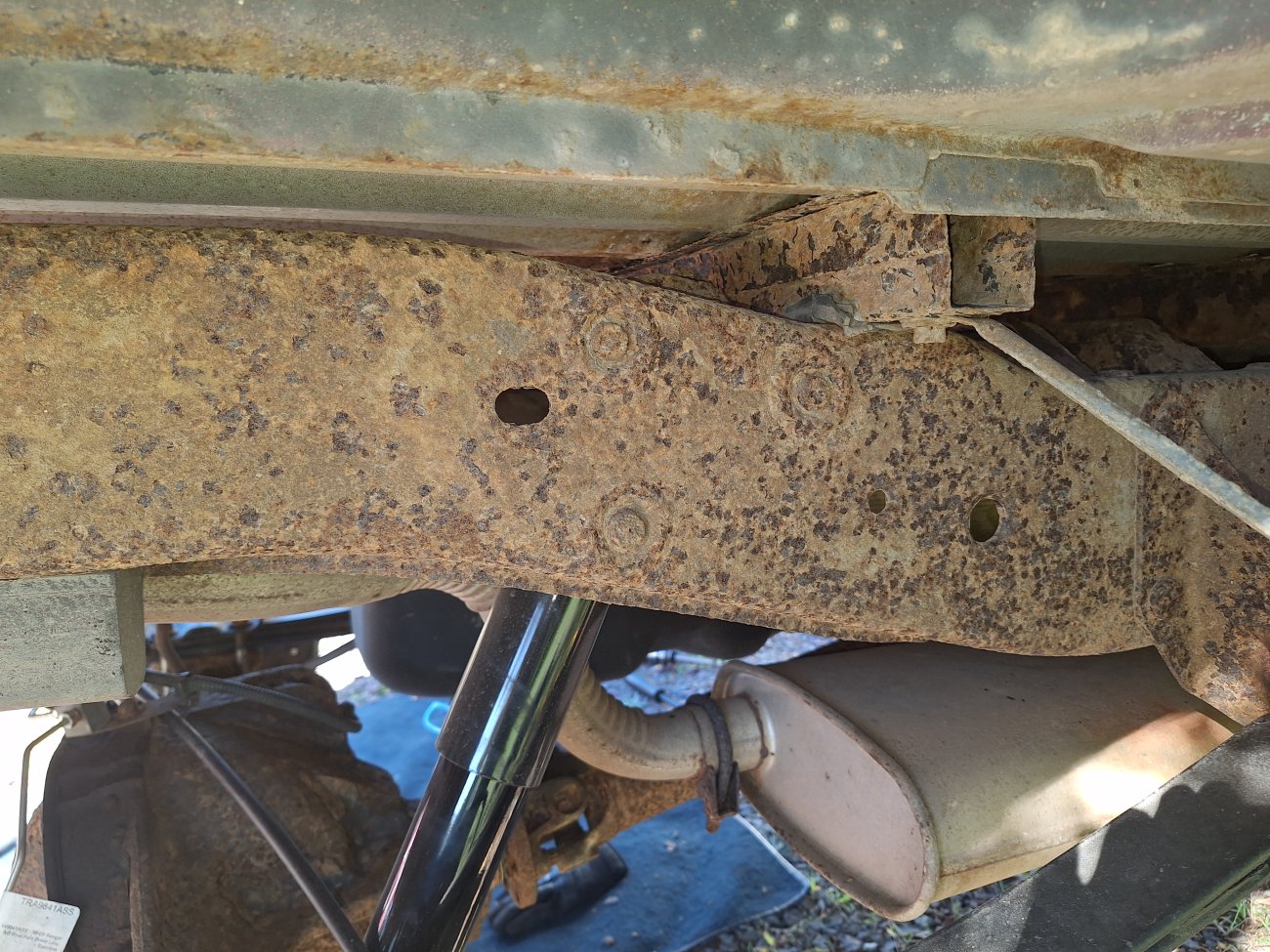

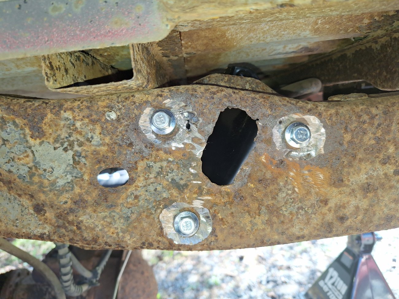

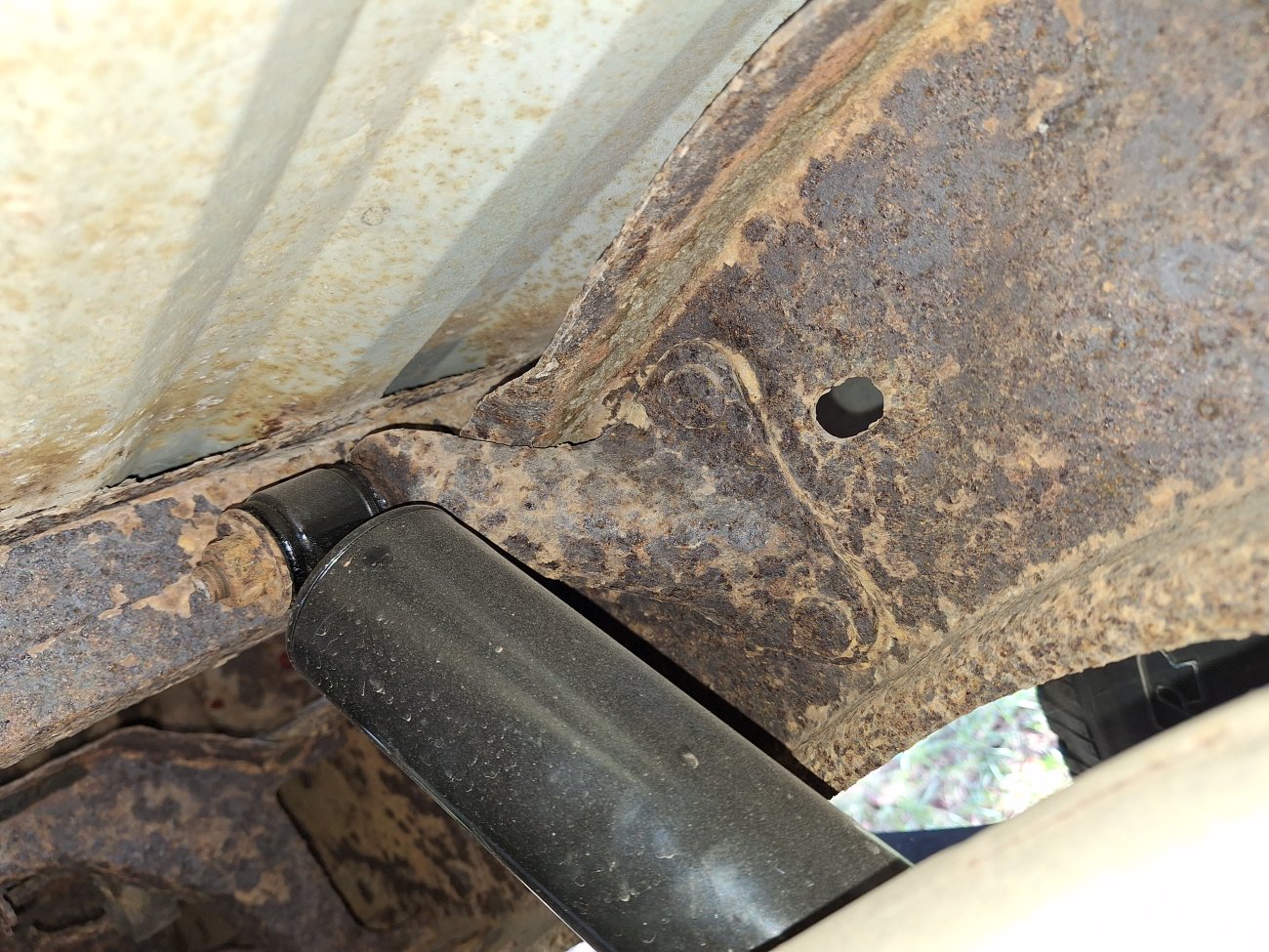

The oddball pic of the hole in the frame is a cautionary tale for anyone who has an old Ranger. That hole opened up while I was beating out the 3 factory rivets to replace the rear shock mounts.

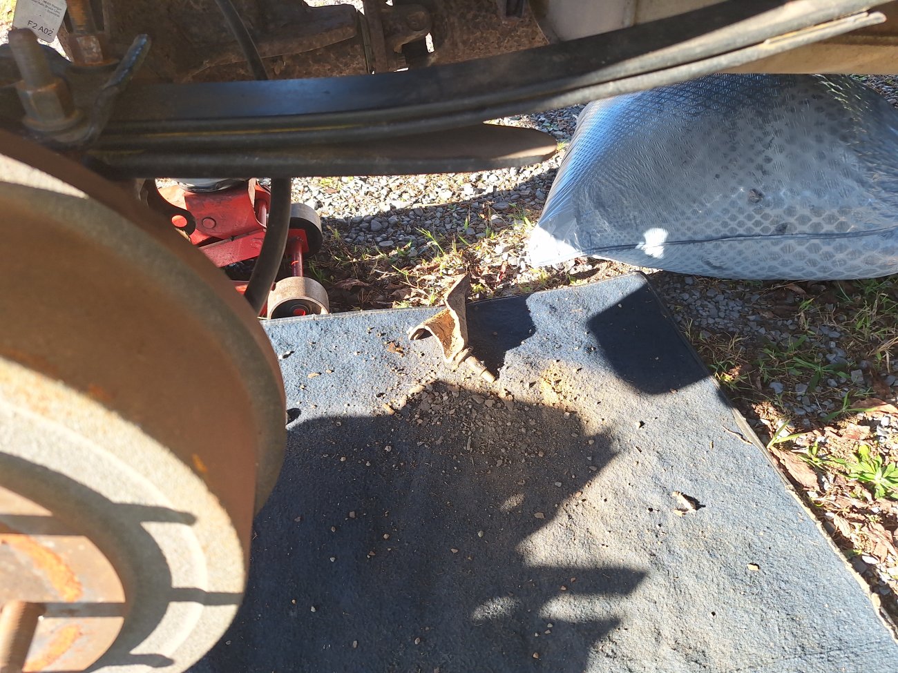

Ford engineers designed the rear shock mount like a cup, or vase if you will. Over time it fills up with dirt, rust, other debris, and moisture and if not cleaned out will slowly eat through the frame in the perfect shape of the mount. I had no idea, until this hole opened up right before my eyes. The frame seemed fine right up to the point I was hammering on the one rivet and was visually checked by both me and the two mechanics I take it to for inspection multiple times prior, we never saw anything that looked like it was getting thin or rusting through.
The mounts themselves can and do rust out and break over time, mine did on the driver side, which is why I had to remove the rivets in the first place.
I changed both sides but the drinker side frame was okay, and the mount popped right off the frame after the second hit on one rivet. I learned some things from the driver side which made the other mount a lot easier to remove.
So anyway- check your frames and rear shock mounts once in awhile lest you end up with a frame hole like mine.

That frame hole is easily patched. IIRC, I drilled a 1/4” drain hole in my shock mounts to at least try and drain out any water, then I coated the frame and back of the mount in grease before assembly

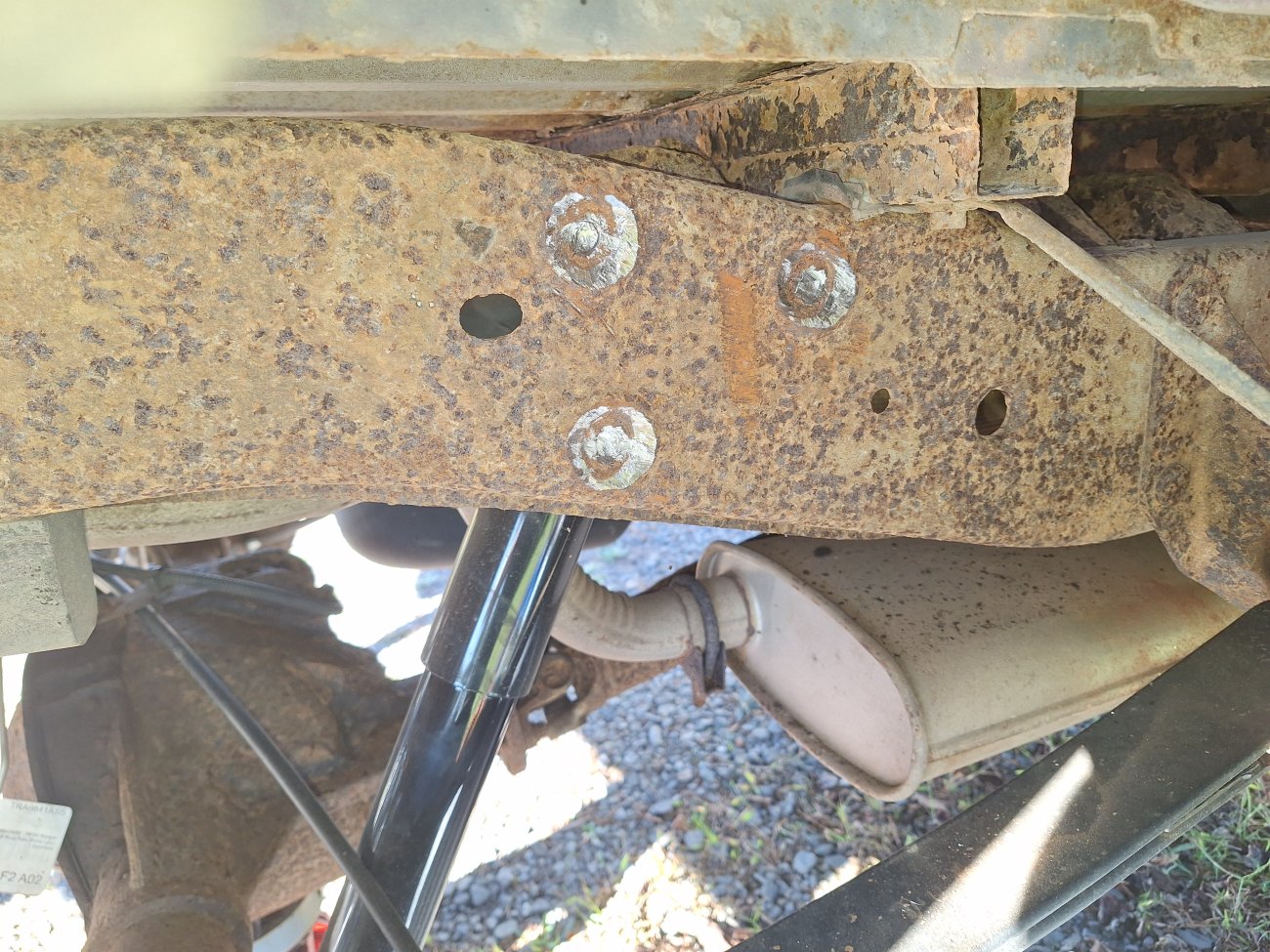

Just in case they might help someone replace their own rear shock mounts; I've gone through my pictures and here are a few of each side. They're not necessarily in order since I was working on it different days/months but they might make things a little easier for someone like myself who never did these before.
The pics are in semi order, at least as well as I could by naming them.
Some notes-
The right side was a bear to remove, taking well over an hour ( maybe 2, I can't remember) of highly motivated hammering, and cussing that would make Gunny R. Lee Ermey proud.
The reason for all the extra effort was my fault since I didn't use my air chisel to peel off the residual rivet heads after grinding as much as I could. On the other side the air chisel cleaned the remaining head material so there were only the rivet shafts to deal with. The drinker side mount literally flew off the frame after two hits to the first rivet, man that felt good after the driver side.
Live and learn.
The hole in my hand resulted from a slip of my left elbow, which was resting on the u-bolts as I was grinding the heads. When my elbow slipped the grinder, which was locked full on, caught me before I could blink.
When I was young I had cat like reflexes, now I like to say I have cat-erpillar like reflexes.
I even tried to mount the shield before grinding but as it turned out, it wasn't for this grinder, which was given to me already well used.
It doesn't show in the picture, but I removed a good chunk of knuckle along with the skin and meat. I just dumped some iodine on it, tossed on a 12-15 year old band aid and got back to grinding, 'cause those rivets weren't going to remove themselves.
It healed up nicely but the DIY bone reduction surgery still causes a lot of pain through my hand but, I can still use it so that's okay.
Regarding the mounts- I didn't think to snap a shot of the back side showing the shape of the mount and why they tend to fill up with crud, mud, and moisture. But hopefully it shows well enough in these pics.
Yea I talked to the two mechanics that inspect it for me every year and they said they'll get it done for me before inspection runs out at the end of June. I don't have the equipment to do it myself, and they're the only ones I trust around here. They didn't set an appointment yet since it was end of day and they were trying to finish up two vehicles before closing up for the night. Once they do get it in, I'll probably have them do the other side too, just to be consistent. I like to do things in pairs, or 4s, depending on the job and parts that need to be replaced.
Did you drill the holes near the bottom of your mounts? Maybe you could post a couple pictures for others to reference.
I wonder if an oval slot near the base ( Like in a rear drum backing plate but smaller) would weaken them too much. That way they could be cleaned out periodically, as long as it didn't weaken the mount of course.
I guess hitting them from above once in awhile with an air nozzle would work too. I didn't even think to check mine while I had the bed pulled back. My hindsight is 20/20, but my foresight seems to be going blind lately lol.
That’s good you have someone to take it to. I have welders so I just take care of it myself, lol.
I did drill near the bottom of the pocket. Don’t think I have any pics though. I’m not sure that a small slot would weaken it substantially unless you’re using load carrier shocks, then it might be more questionable
