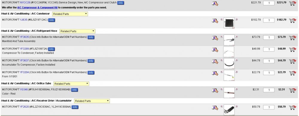

I've attached a screen shot of all the components I would get. All motorcraft. It's around $600+ for all the stuff which makes me wonder if I should. I don't want a car payment and I am not interested in buying a new truck. This one serves me well on what I use it for and it's fortunately not a DD so I can have it taken apart in the garage on the lift for however long it needs to be.

My only fear is changing everything in the below screen shot and then having it still exhibit the same behavior as it is now.
