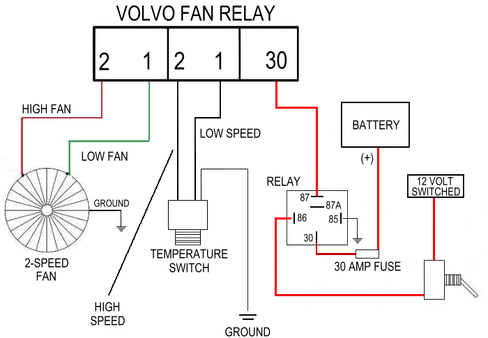

I'm following the Volvo electric fan swap on my 92 Ranger. I got it all installed and went to test it last night (fans never did come on, thinking I need to recheck my grounds) and while the truck was warming up in my driveway it triggered the relief valve in the AC compressor (scaring the bejeezus out of me). I hadn't realized my AC was running, and I realized it was because with no airflow the refrigerant wasn't cooling off enough in the condenser and therefore couldn't go back to it's liquid state, over pressuring the system and blowing out the relief valve. It happened at a relatively low temperature too, I suspect lower than the 195⁰F that would trigger the low speed fan.
So I got to thinking, it would probably be wise to wire in a way to override the temp switch that I plumbed into the upper radiator hose so that any time the AC is on, the fan will come on low speed. When moving obviously it wouldn't be much of a problem anyway, but if I were for example sitting in a parking lot with the AC on in the summer, the same thing would happen.
I'm following the below wiring diagram- would it be possible to do the wiring I described with the relay built as it is? I'm still a beginner when it comes to engineering my own electrical diagrams, so thought I would check with the experts.

So its basically 2 relays in a "box", one for low speed one for high speed
Relays get 12v with key on
Then each relay is Grounded to activate it by a Temp Switch on heater hose or upper rad hose
Make sure Temp Switch is always in contact with Coolant or it can't work
And manually Ground each temp switch wire to see if fan comes on, engine on or off doesn't matter, but 12v must be on
Easiest way to add AC on/fan on is with another relay
AC Compressor clutch gets 12v to turn AC on
Splice into that wire
Low speed fan is activated by Ground wire at Temp Switch, splice into that wire
Relays use 85 and 86 to activate, no polarity, as long as one is 12v and the other a ground relay closes
Standard automotive Relay Diagram here: http://www.gtsparkplugs.com/images/mini-automotive-relay-wiring-840x.jpg
Connect Low speed ground splice wire to 87
Connect chassis Ground to 85 and 30
Connect 12v AC splice wire to 86
When AC is activated the 12v closes the relay
87 and 30 are then connected, grounds the Volvo Relay
Low speed fan turns on same as if Temp Switch Grounded it
If low or high speed was already on it wouldn't change anything by ground that Temp Switch wire
I personally don't think you should have a on/off switch for the fan, just key on power
If you want the on/off switch then make sure you wire in a bright RED Light to notify you when fan is switched off
