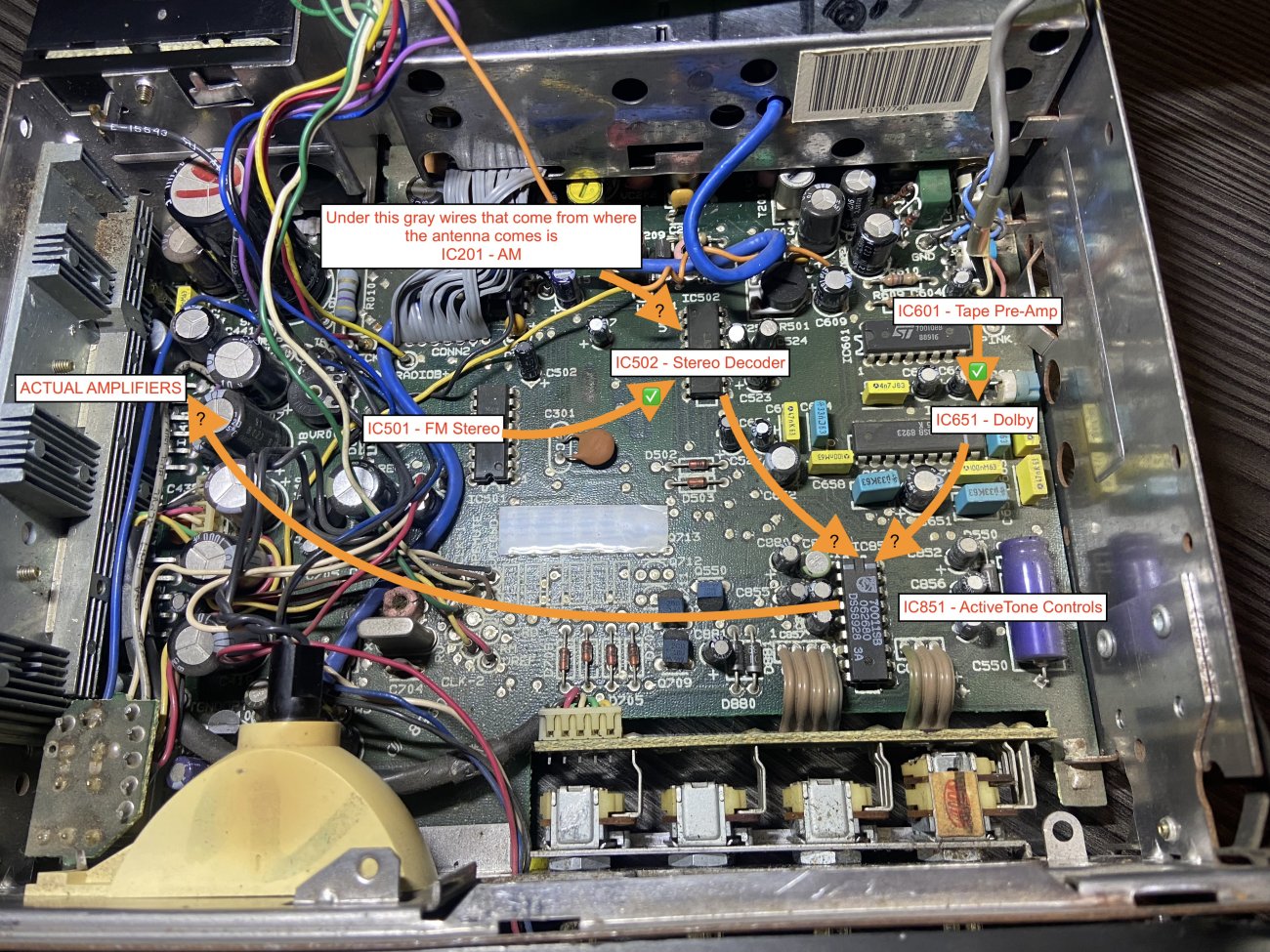

1 - The first photo shows a cheap USB adapter for the 12v outlet (cigarette) that I'm going to use instead of a 5v regulator, this should be more sofisticated and small enough, I connected the 12v feed into the main radio input ACC pin 3 and the ground into pin 6 and this is what I think my mistake (I'll tell you why next)
2 - The second photo shows how I connected the BT board.
3 - The last picture shows that I removed the AUX output on the board that did let me mount the board flush with the LCD light and added 4.7uf capacitors on the audio outputs.
So, what went wrong? I plugged the radio on the truck and as soon as I turn the acc on, the BT module blew literally, the IC fried inmediattly, and noticed the red LED didnt turn on, BUT if I turn the lights on the led would turn on, strange enough I think I choosed the incorrect ground for the voltage regulator, I'll try again tomorrow with other spare BT board I have.

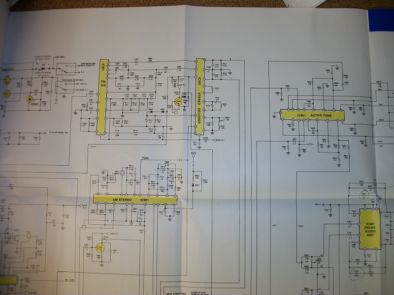

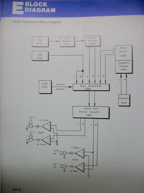

This is the section of the HUGE schematic sheet that covers circuitry between IC201 and IC551. I have added some highlight to trace the AM audio circuit between them. Unfortunately, it turned out lo-res.
I could PM you a higher-res of this image, if you'd like it.
Interestingly, AM audio input is on two jumpered pins on IC551, because there's an option for AM stereo. If you could get a bluetooth signal in at this IC, it might be possible to have 2 channels for stereo, I'm thinking.

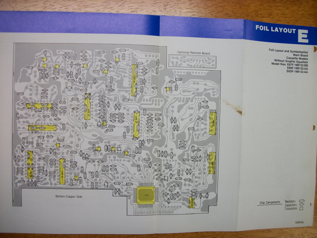

These two pages show the PCB layout, top and bottom, in case it's helpful.

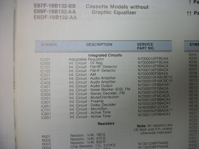

I noticed my motherboard does not have the IC551, I tried to send you a message but I'm a new user and I can't, if you still have the high res images, please PM them if you don't mind.
On the way.
What is the Ford part number of your radio? Does it start with "E", or "F"?

I bought another cheap 12v to 5v usb adapter for the cigarette lighter socket, disassembled it and replaced the burnt one, replaced the burnt BT module too, I discovered my mistake, it a was a pretty noob one, I didn't pay attention that the connector on the radio was 7pin instead of 8 shown in the schematic, so I was off by one pin in the ground side, I tapped it into the lights system and even tho it gave me continuity to chassis ground maybe it was floating or something. Works well now, so im still analyzing the schematics @RobbieD PM'd me.

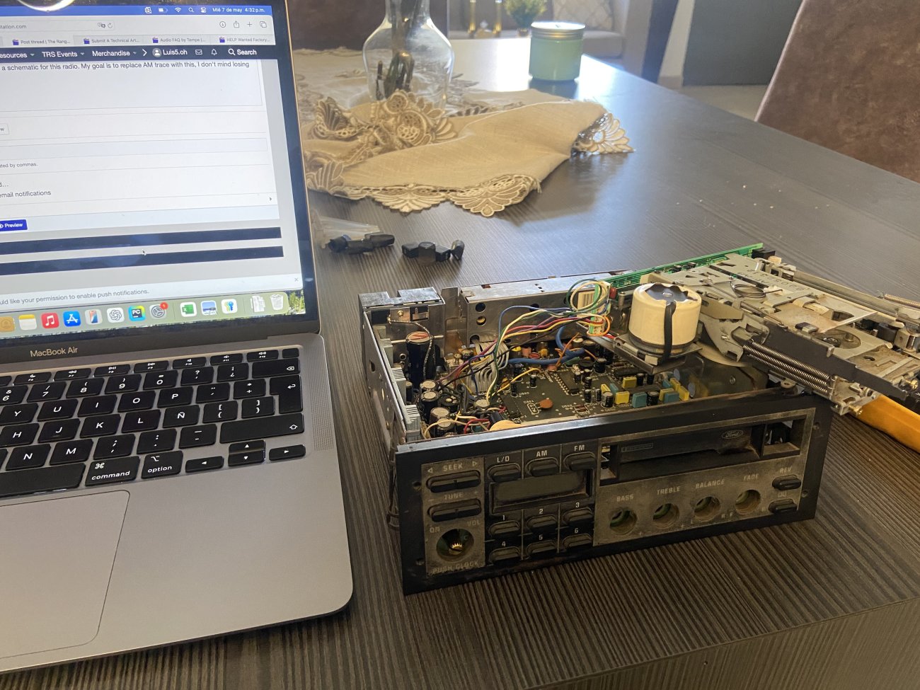

Update:
Removed the metal shield on the back with the hope to find the IC551 but no, it was IC101 and 102 (both FM related), so I can conclude:
-This kind of radio DOES NOT have the IC551 or MUTE IC
The easy thing would be to use the tape circuit but thats not what I want so I'll do some more testing but so far I have made no good progress
