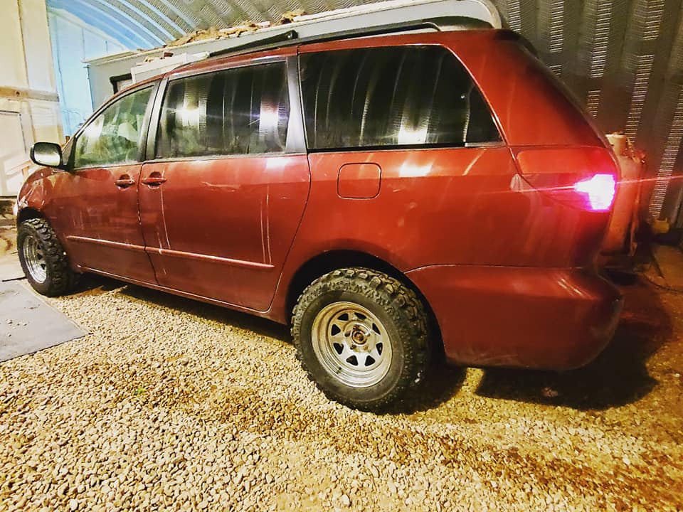

I am pretty sure you can get Super Swamper TSLs in like a 28" size... if you want to go really agressive :) My buddy has them on his Toyota Previa van, lol
Actually it was a Sienna... he has had a bunch of Toyota vans. IIRC he had to put spacers on it to keep the tires from rubbing pretty much everything on the front.
