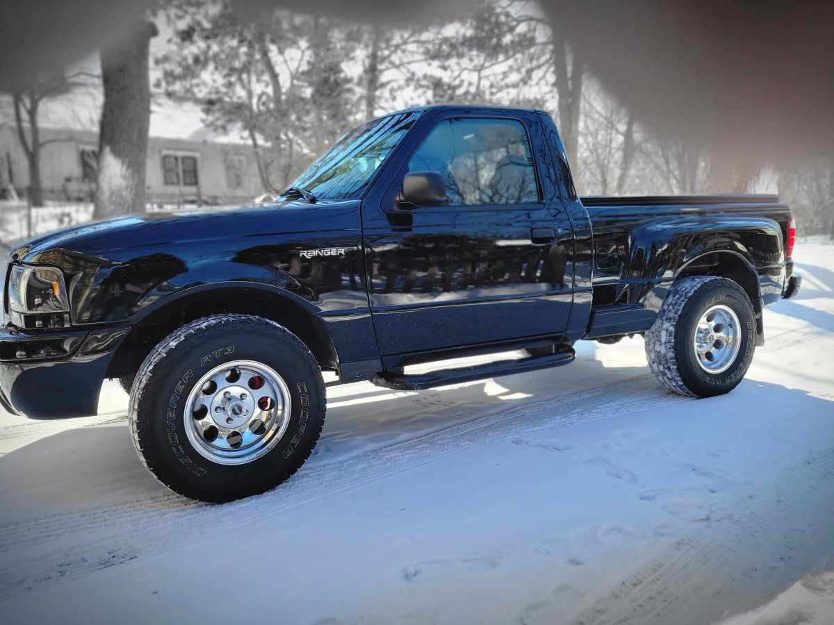

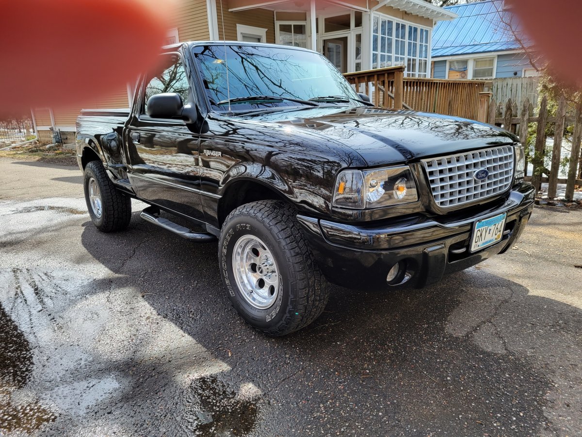

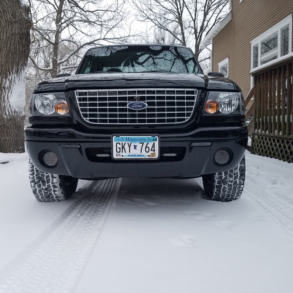

Pictured is my Ford Edge which rides a little higher than stock. The third attachment shows how the wheel looks inside the fender wells. IMO, bigger tends to look a little "stuffy.' Smaller looks a little empty.
