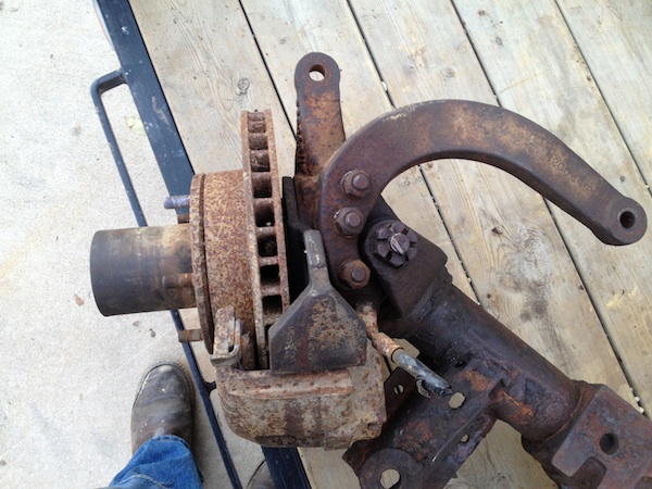

The 1977.5 HD 3/4 ton dana 44 hightop (knuckles & C’s) came stock with the dual piston brake caliper, while the 1979 Dana 44 coil sprung 1/2 ton came stock with the single piston brake caliper.
SO WHILE EVERYTHING ELSE on this all fits and slides together like butter and like it was made to work together, i can not for the life of me get the (1/2 ton) single piston brake caliper to fit with the (3/4 ton) knuckle .:icon_confused:
........The only way i can see these fitting would be to cut out a section of the knuckle (where the bottom of the caliper hits) with a cuttoff wheel on the grinder making straight lines. Cut all 3 sides (~3”x4” square piece), flip it so instead of the rounded arched side going up (away from axle shaft or center) it would become con-caved and the rounded arched now facing axle center/shaft. to hopefully allow for the clearance i need to run the calipers.:icon_welder:
UNLESS anybody else has any other options or ideas!!!!

yes, im well aware they do not fit right now, thats why i am asking if anyone else has any opinions of this.
Like should or shouldnt i cut and modify the knuckle to accept it, or if there was a dual piston caliper that can work with the 1/2 ton system.
bc i know for a fact the everything else fits together and operates
There is no way to run Ford 1/2 brakes and have flat tops.....unless you buy Ried Racing knuckles.
Sent from my XT907 using Tapatalk
Or find a 78 F150 super cab driver knuckle, but they never made a Ford 1/2 ton passenger side flat top.
