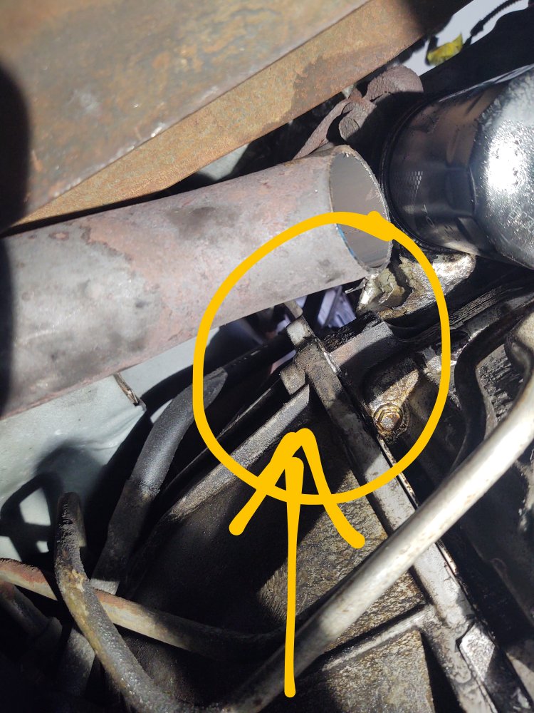

I had to steal one of Petroliumjunkies pics...
There are 8 bolts, if you’re counting the 2 at the bottom that go into the oil pan.

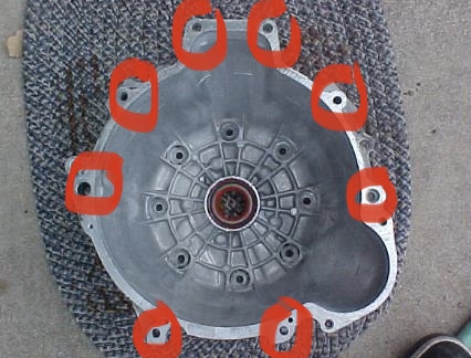

This pic is not the same trans (Bell housing)
Mine only has 6 bolts.
4 above the dowel pins
2 at the bottom.

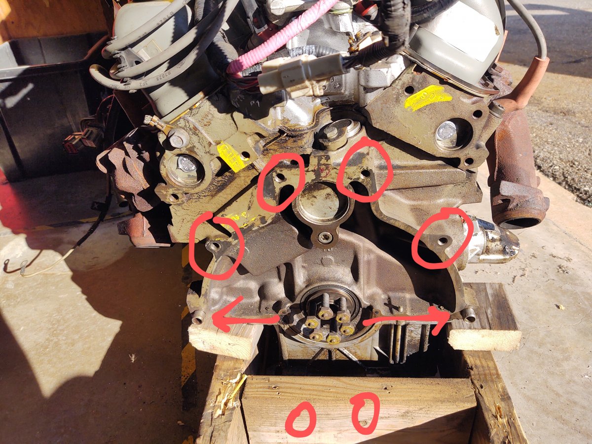

This is the back of the replacement engine.
2 at the bottom.
Yes... it’s the same. It’s a 4.0l auto bellhousing in the pic. There are 2 different 4.0l bolt pattens. The OHV and the SOHC use slightly different bolt patterns. The only difference is the top passenger side bolt is moved about 2.5” to clear the timing chain on the SOHC. (Some transmissions have both holes, but only use 1 of the 2.)
In your pic, there are supposed to be bolts at all of the circles (that’s 6) and 2 where the arrows point at the dowel pins (that would be 8 total).

There are no bolts where the dowel pins are. It is hollow all the way through.

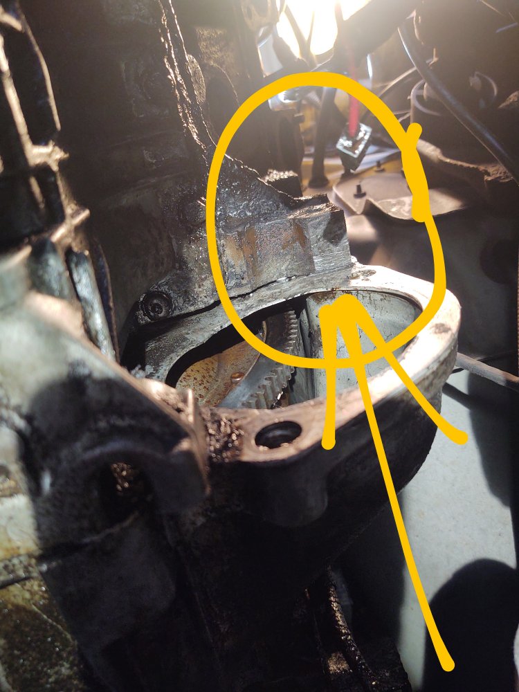

Well, the Dowel Pins or guides are hollow, There are no bolts in there. I removed all bolts. What method can be used to release the guides which marry the engine to trans? Thats the only thing holding it together I can see. I cannot get a pry bar in there?? Plus Bell housing is aluminum so I can see by trying to jam things inbetween it is warping a little. I'm trying to be careful as possible. I saw one video on a Mazda 4.0 removal, one guide came out with engine, and other stayed in trans side. I dont care how it comes out. I have nice guides on the new motor. Problem is there is no where to pry and get leverage. Its 4wd so pulling trans out together is more a headache with the transfer case and all. Plus all bolts, to driveshaft, and trans mounts, and transfer case all look like more problems. Any suggestions? I will post some pics and video if it lets me of some stuff I've tried. It just dont make sense, it is this stuck?
Pic of both sides where guide pins are stuck 🥺
