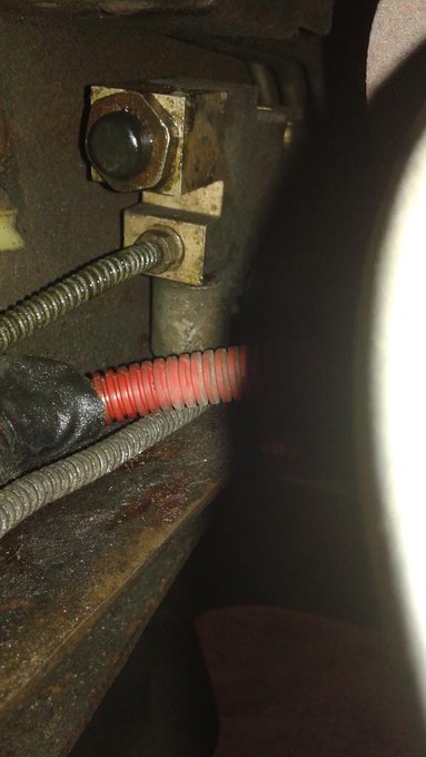

Mine leaks at the abs hydraulic as well also radiator cooler breached into Trans washed it out rebuilt it didn't flush lines no first gear now. On top I drove through high water took out my new front bearings again. But great truck after replacing both heads used block putting trac lok in her new shocks, etc etc etc.
