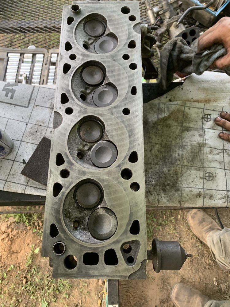

Well looking at the heads what do u think?

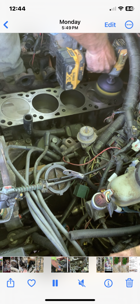

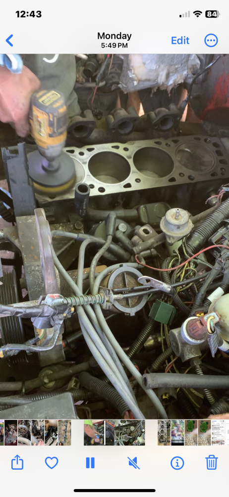

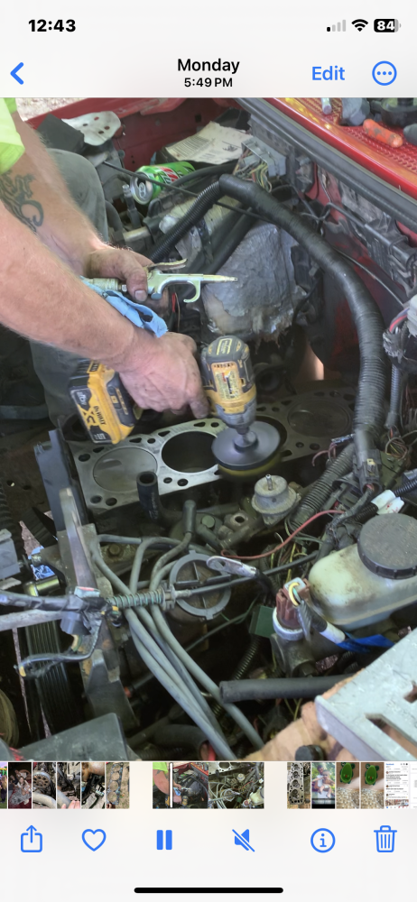

I have a video it won’t let me post but here are some screen shots where u can see the pistons
Can't tell, the heads pretty much look the same. The major difference was in the block, namely the pistons.
Looks like a flat top with valve reliefs from here. That would mean non-turbo. If the engine has been rebuilt with non stock pistons (impossible for me to tell from screen shot), who knows what the piston specs are.

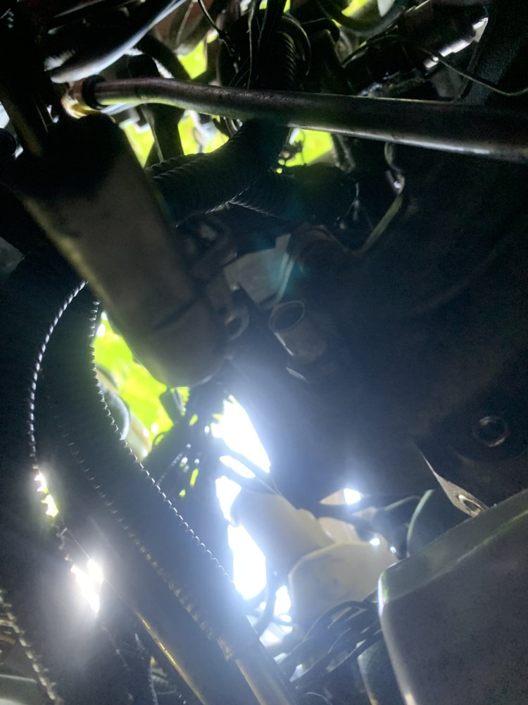

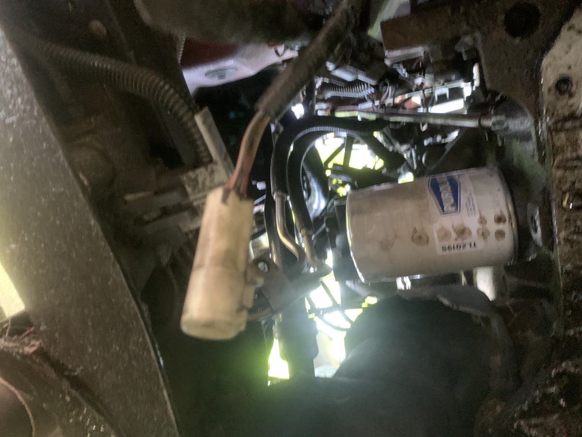

there’s also a plug under it if anyone know what it’s to

That looks like the oil pressure sensor. If I remember correctly, it's on the side of the block and is a single wire unit.
