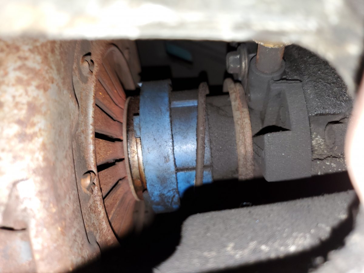

I am not able to shift gears at idle but once I am rolling the truck is able to shift. I throw it into 4th, 5th, or reverse (whatever gear it'll go into) then its able to go into 1st if I switch really quick. The clutch was not completely disengaging and I was able to roll forward in first gear. I bled the clutch lines and the pressure plate was being compressed a lot more. However I noticed some brake fluid coming out of the top of the master cylinder when the clutch pedal came back up. So I decided to replace the master cylinder. I bled the lines and all looked good. I took it for a test drive and it was shifting into first gear without any problems. However about 20 mins of driving and then trying to shift from a dead stop it will not shift. I am back to throwing it into reverse or whatever gear it'll go into then quickly going to first. Is this a bad slave cylinder? The lines looked dry and no leaks that I could tell before I started working as well. The slave cylinder doesn't look wet just a little dirty? I was really hoping to not have to pull the trans to fix this.. so any ideas?

I pushed out the roll pin and replaced just the master cylinder itself and it came with the hose that led up to the reservoir but thats it. I wanted to bench bleed the system but I couldn't get the quick disconnect that connects to the trans out. The way I bled the system was by pulling the plunger out of the master cylinder until it came out then closed it. Pumped it about 3-4 times then pulled the plunger back out. (Repeated this process 4 time) This seemed to harden up the master cylinder and it wouldn't budge past 1/8". Can you explain what you mean by with the engine off slip my foot off the pedal 5 or so times? Should I pump the clutch pedal? Also, the clutch pedal doesn't feel soft or spongy. It feels hard to push.

I just bought this truck and I decided to replace the trans fluid to help extend the life of the trans. I mistakenly put in 85w140 royal purple since I had it lying around. I drove it around the block and it did not want to go into gear while driving. So I got STP mercon v trans fluid and replaced it all with that. This is when I noticed it will not go into gear from a stop. I never really tried putting it in gear from a dead stop before though. I didn't have plates and just drove it around the block. It slides right into 1st gear when rolling to a stop. Just before completely stopping. I would say it has gotten worse. I was able to throw it into reverse 4th or 5th before (whatever gear I could get) then throw it into 1st real quick. Now it is becoming where it won't find any gear. I sat there for 45 seconds trying each gear and nothing. I let off the clutch and keep trying and it eventually finds something. This is how it got the first time then I bled the lines and replaced the clutch master cylinder. Now its getting worse and is like how I just described. I personally feel 90% sure its the slave cylinder. 5% I got a another bad master cylinder and 5% more air worked its way in the line and needs to be bled again.
