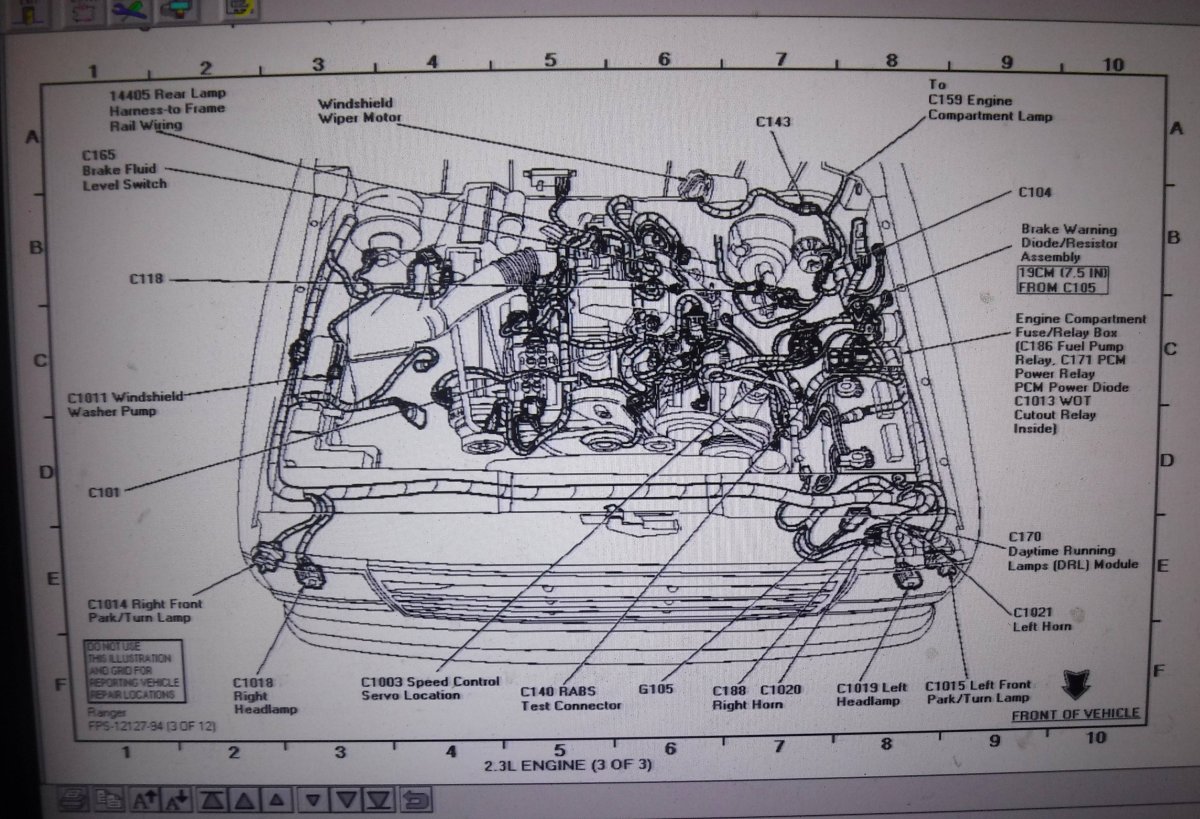

1994 Ford Ranger 2.3 liter manual transmission a whole bunch of things are going wrong with it I got a bunch of codes but there's a wires that are going up to this harness and I don't know what it is so please help

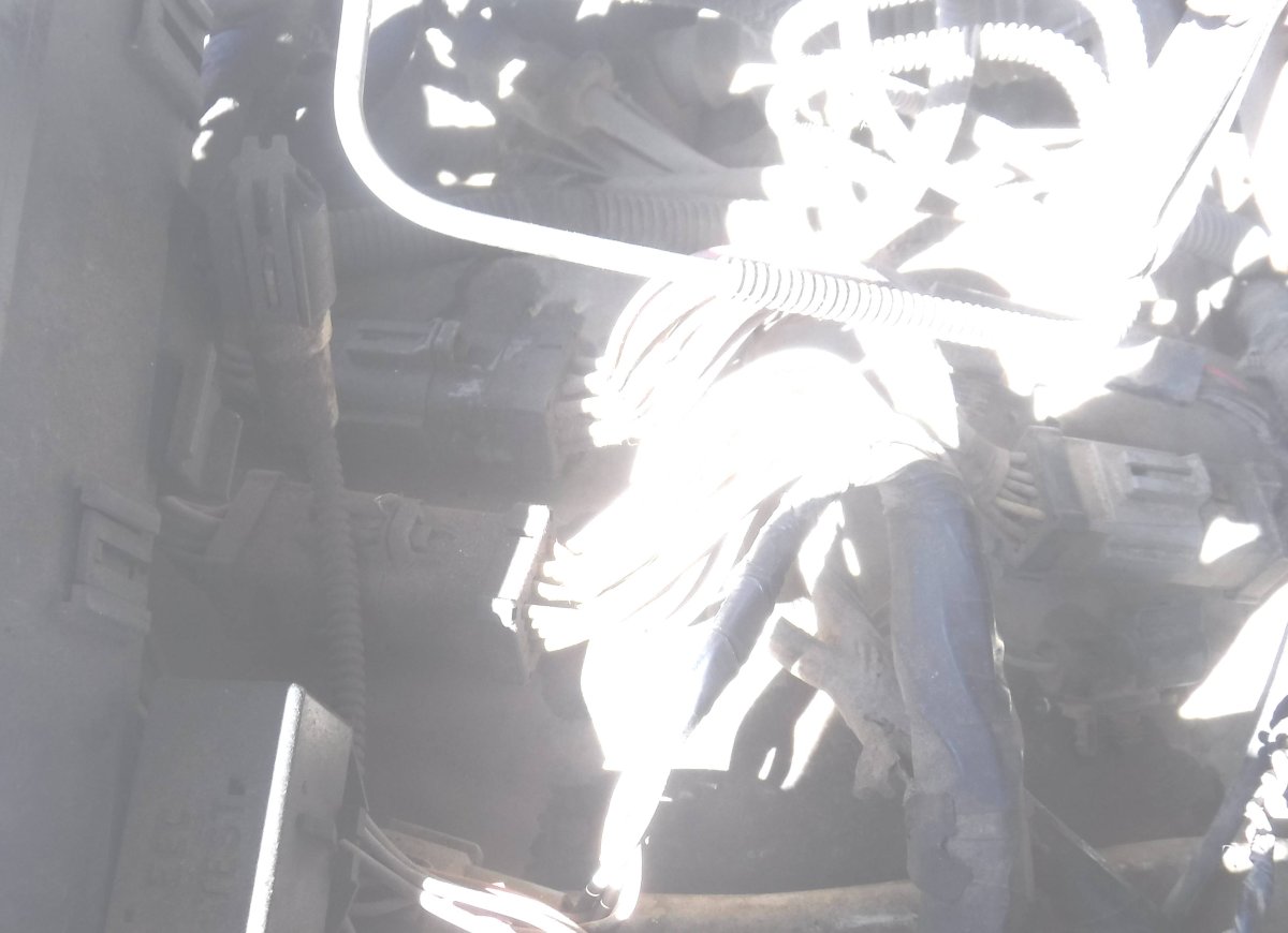

Better pictures would help. Where are these connectors in the engine bay? What color wires are in them? Do you know where any of the wires go? Are there any numbered labels on these connectors or near them on the wiring harness? With more info, somebody can look them up in the EVTM.
Maybe you should also get shots of its mate, in its natural habitat
Yes please...what ericebphoto said.
Just a wild-ass guess on the location, but maybe the left side engine compartment fender liner near the fuse box and starter relay.
There's three of them there, right beside the fuse box.
I thought about looking inside them for info but afraid they'll be brittle. Used 100 percent brightness to get them to show in the photo Two are to the left of center and one is to the right

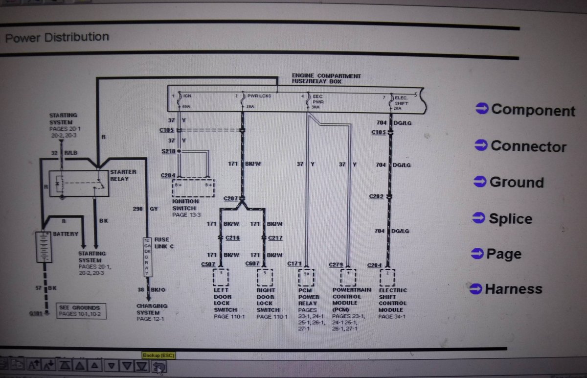

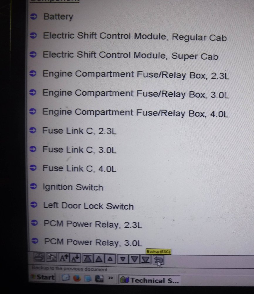

Best I could do with a Windows XP and pocket camera
If you can download the wiring photo you can zoom in a bit farther

The big rectangular looks suspiciously like the connector between the body harness and the engine harness used in 94...
looks like the trans one and 02 ext
