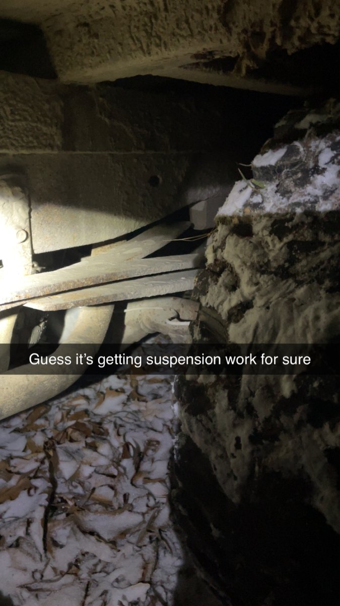

If I can find a set to lift it a little and get rid of the block that would be awesome but I know I might have to play with block sizes to get the look I want. I attached the passenger rear spring pic. You can see the broke leaf and relatively how flat the pack is

Yup, those are toast. They also are definitely not 1750# springs. Those look like main leaf, single leaf, and overload. Not the lightest rated leaf from the factory, but the heavy duty packs had a main, two leafs and an overload from the factory. I want to say the 1750# pack is a main, three leafs and an overload.
A Chevy drop shackle can be used in place of the factory shackle to eliminate a factory block.
