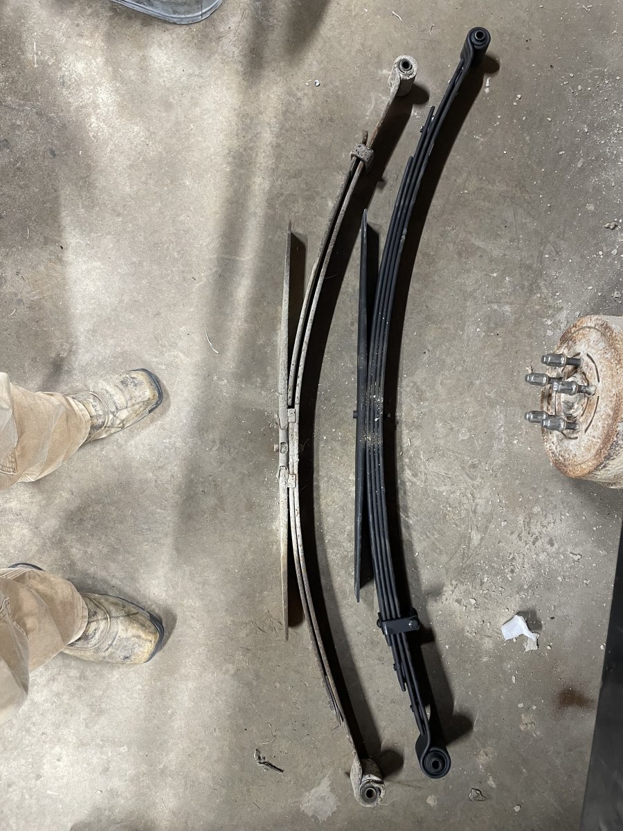

Kinda my understanding of what was offered to me. When offered a 3 leaf or 4 leaf setup through my local but online is a 5 leaf setup for less money I'll go with that. I was hoping they could make me something that has a decent weight rating and maybe a little lift but at those cost I didn't bother asking.

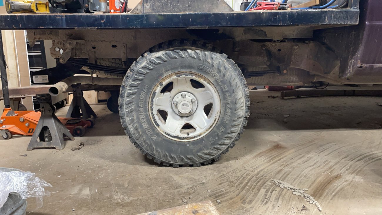

Surprisingly every bolt on the leafs has come loose and isn't stuck in the bushings, even the u bolts came loose. I still plan to buy new u bolts but can atleast mockup whatever setup I like best and measure it to order. I'm guessing since the truck was used on company grounds for however long it didnt see road salt to mess much up
I got the springs in temporary till I get the new bolts and u bolts. Definitely raised it up a good bit which I’m glad for
