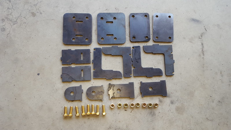

Awhile back I built some new shackles for the rear suspension. I built them to match the length of the Belltecks that I have been running. All was good till I went to install them and the 2" OD bushing I used would not clear the factory hangers. I put it on the back burner and finally built some new hangers. They are made out of 1/4" plate.I also made a backing plate that the nuts are tacked to on the inside of the frame. I only did this because my gas tank is in the way of easy access to the back.
The pieces.
20160215_134045 by Matthew Dresselhaus, on Flickr

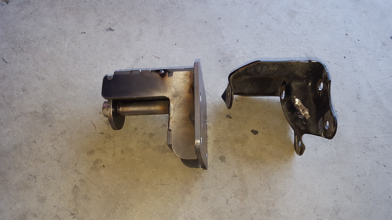

Then compared to the stock piece. The stock hanger is an original 23 year old piece.
20160215_141732 by Matthew Dresselhaus, on Flickr
20160215_141745 by Matthew Dresselhaus, on Flickr

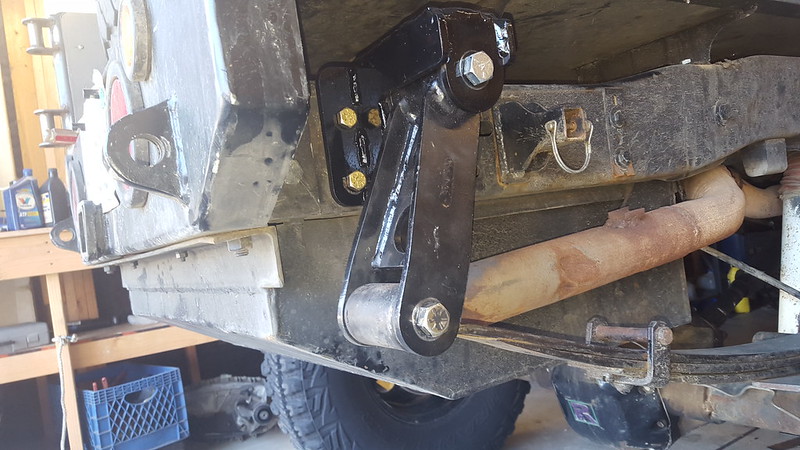

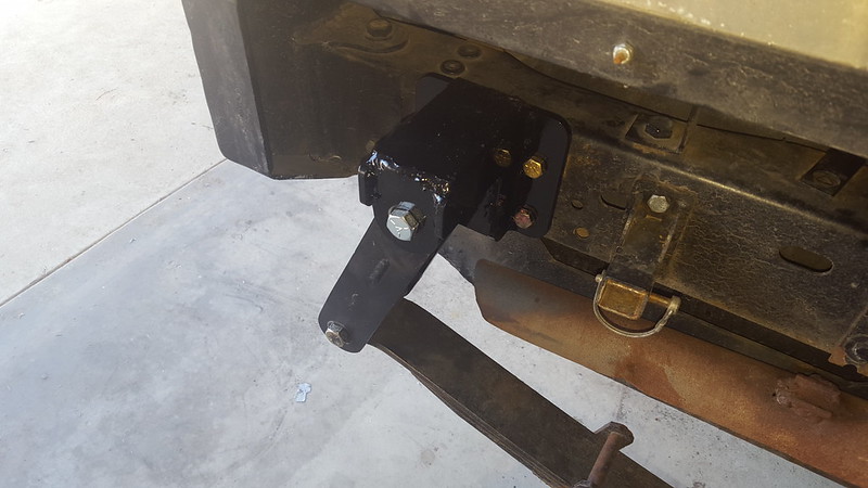

Installed on the truck with my new shackles.
20160216_150438 by Matthew Dresselhaus, on Flickr
20160216_150426 by Matthew Dresselhaus, on Flickr
