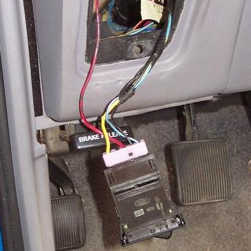

While on this topic of fog lights, anyone have an idea of how to keep them on with high beams? Watched a tutorial on snapping off one of the prongs on the relay switch and all that did was kill them altogether so now I have no fog lights. I'll just replace the switch.
Due to DOT regulations... its probably better we don't discuss ways for you to defeat the factory built in regulation.
It may vary by state. I was going to recommend checking state and local laws.
Then check put this article in our tech library.
Guess I never saw that.
I guess that is one way... not gonna work on the news ones.
I haven't read that article in a long time. I just knew we had at least one article and bunches of forum threads about doing it.
