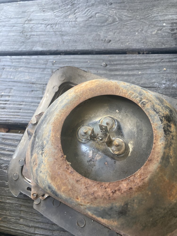

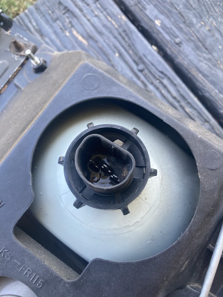

Two of the three front light connectors mate up by design, but the primary headlight has a different kind of connection.
Anybody know the pinout for each?
I might try beeping each light/connection with a multimeter.
1st Gen first, 2nd gen second:
On your later model wiring, red/black is the lowbeam, purple is the highbeam, black is ground. On the early light bulb you can try the pinout below.

The main headlights need their connector chopped off. The two sets of blinkers/yellow lights already connect so no mod needed to those harnesses, they mount right in. As for the headlight connectors, once you chop the connector you can slap crimp terminals on each wire and be done. I used the 3/8” female 10-12 gauge crimp terminals from autozone since it was down the street. They slide perfectly and securely onto the 3 1st gen headlight pins.
https://www.autozone.com/miscellane...-8in-12-10-gauge-female-disconnect/600320_0_0
When I’m confident I have the high/low pinout correct I will add heat shrink to protect each one from external contact.

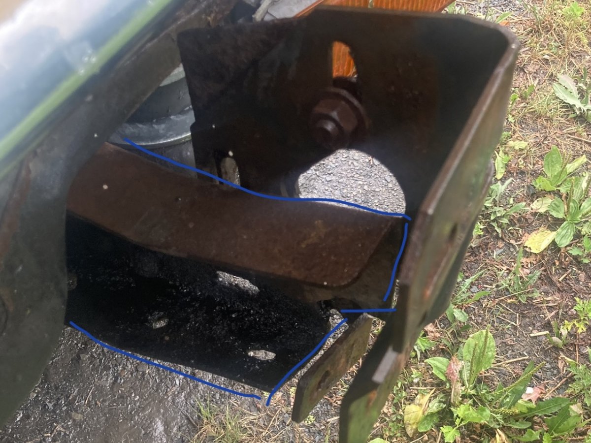

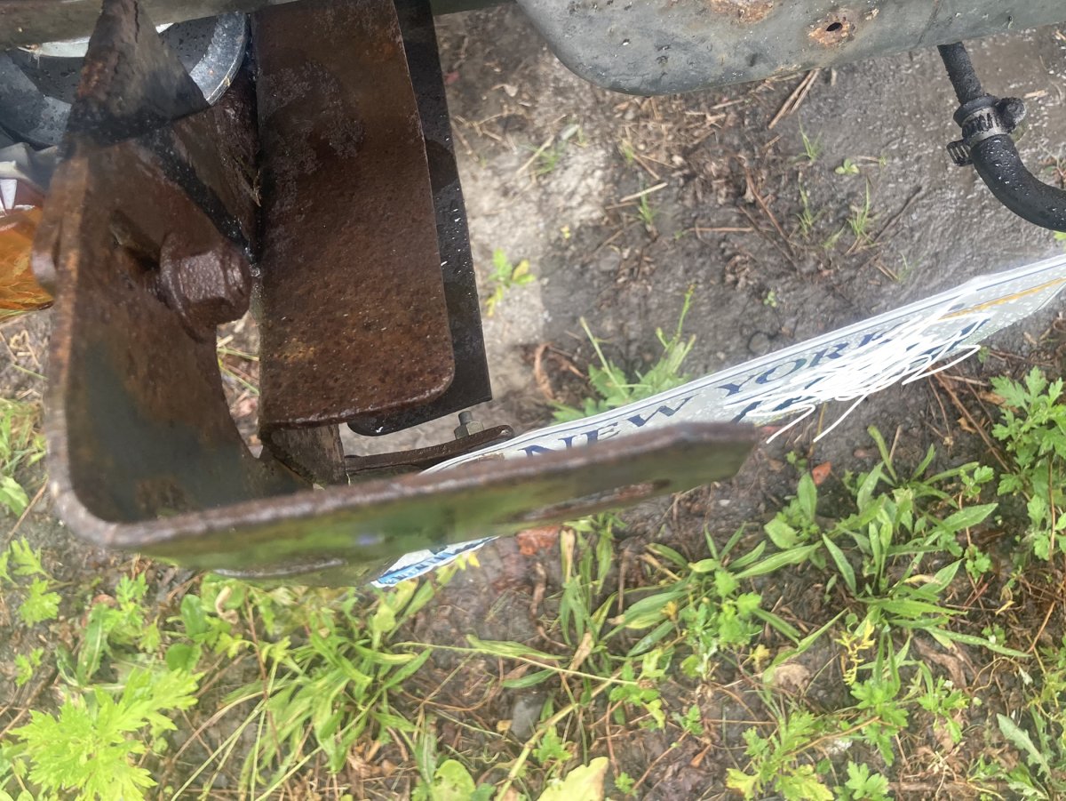

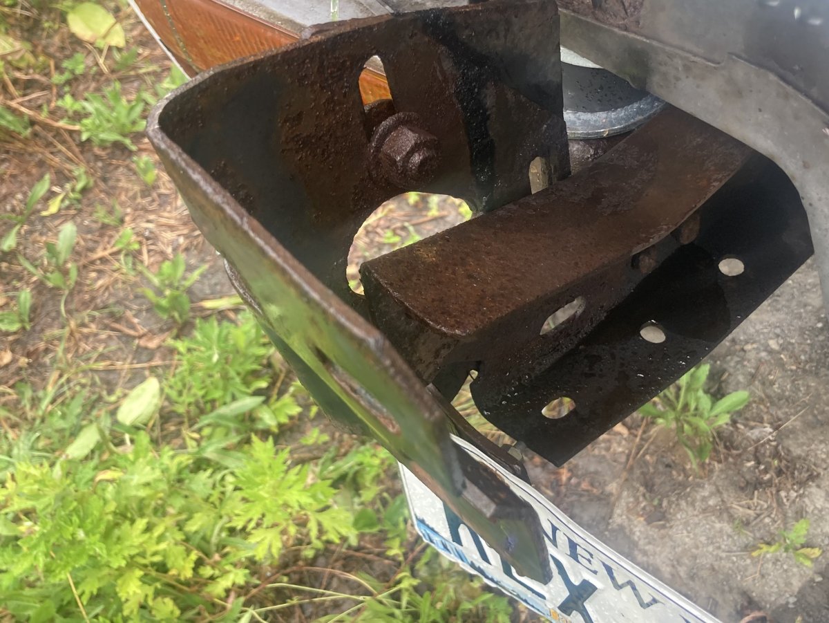

Here’s a few pics of the bracket attached to the front of each frame rail. In one of the pics I drew a blue line that outlines the frame so you can see what is part of the bracket. The brackets are pretty complex and have two separate layers welded together, so maybe they are DIY or maybe this was some aftermarket design for bumper lift. In any case, the bolt that holds it to frame is removed from both, and all that’s holding it on is some spot welding which i will need to cut.
But if what you’re saying is true about the 1st gen bumper lining right up with frame, I don’t see how that could happen here but maybe my truck is missing some pieces that used to connect to frame and offered up some direct mounting to 1st gen bumper.
I still have my 2nd gen bumper that I believe has some mount pieces inside of it too, which attaches to this stuff of course. It came on the truck like this. Maybe there’s a way for me to remove that from 2nd gen bumper, install inside 1st gen bumper, and also delete the lift brackets from frame, and maybe it will mount up as if OEM. The trick would be how to mount the pieces inside 2nd gen bumper to inside the 1st gen bumper.
Did it come with a body lift on it? it looks like thats the brackets to raise the bumper up so it matched the body lines again.
Yep it’s a lift to match bumper body. I deleted the body lift.
Just can’t tell if by removing them I’m returning the front of frame rails to 2nd gen OEM or if something is missing that they had removed to install these brackets.

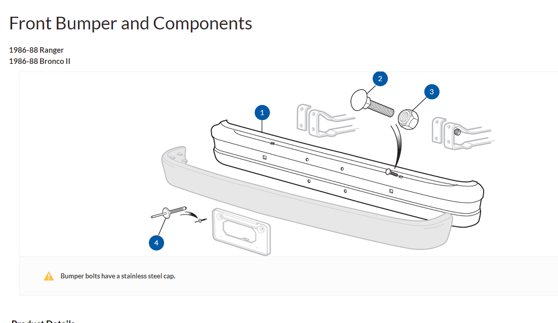

O I gotcha. Yours right now have been notched a little but nothing really removed. The 1 gen bumper mount is different. This picture shows on LMC pretty good how its suppose to go.
Second gen bolts on the side like yours (from the sides). Besides yours being notched its pretty much there. They didn't make second gens round like the first gens.
Nice. Thank you for this! Helps big time.
Looking at that, it seems the issue is that my frame rails don't terminate like how i see there in diagram, with that bendy solid front face with two holes.
My frame rail just ends open faced like a I-beam, so I'd need to develop that pair of holes for each end. You can see from the pics i posted that the rail has no front face once the blue outlined bracket is removed.
Looking at my 1st gen bumper I have in hand, sure enough it has two pairs of vertical holes that mount to those pictured in diagram, so if I had those holes in front of my frame i'd be done and ready once the bracket were pulled.
It's interesting that the diagram kinda also shows that there might be two pieces that can be fixed to the front end of frame and thus provide the holes. I suppose i could try searching for bumper mounts to see if those pop up anywhere.

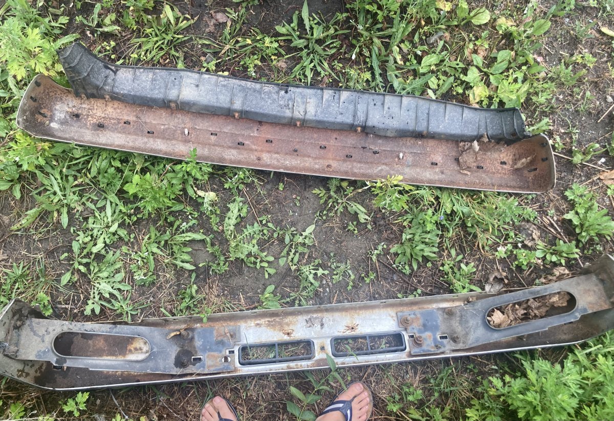

Here's the pic of my 1st gen and 2nd gen bumper interiors.
