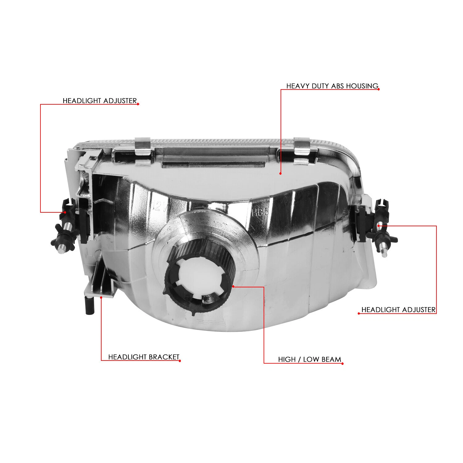

Well I tried after market but I don't know if it will lock to core support with only having two pins I have one after market I'll get pics of the oem set up
This is what you are finding?
If so then they will work. The bumper on the bottom will ride on the outside of the core support. Yes you will loose one anchor point but they will work.

That is because they are two separate pieces. That turn/marker light is it's own piece. Some sets seem to be attached others they are separate. I just grabbed a pic off of ebay that happened to just be the headlight itself.
Now the lights that have a single bulb for the directional and marker will not be correct for your truck. There are two separate bulbs in the factory marker light housings. 1 single filament for turn signal and I believe a 194 bulb for the marker light.

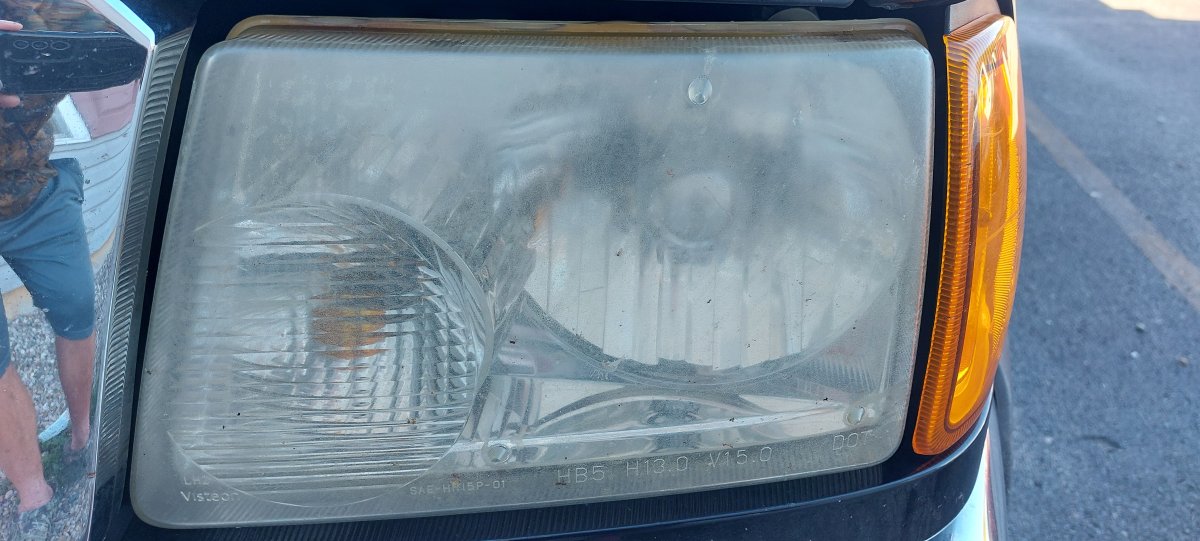

I have 3 light plugs . One is the turn signal on corner of truck totally separate from headlights . Then headlight assembly has two lights one amber that is built into the head light and then the hi low bulb.
I have an aftermarket one here but that means I have no where to put the amber

OK lets double check the year of your truck, This is a 1995, correct?
'95 did not come from the factory with that style light and why I'm double checking.
