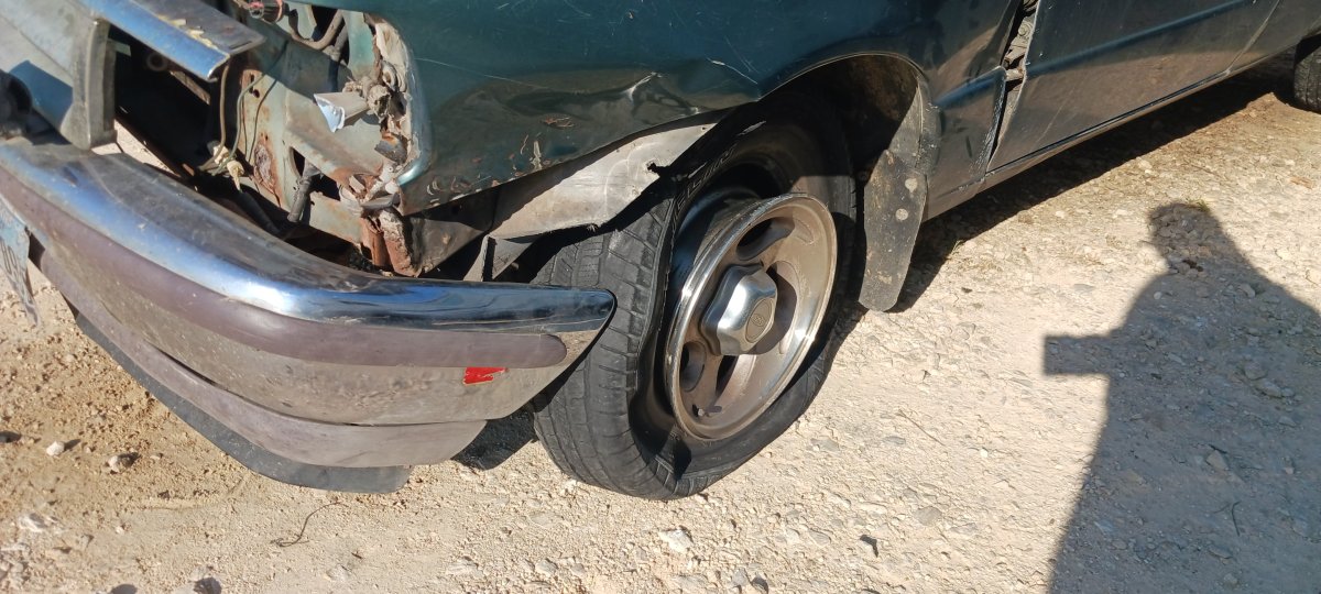

1996 XLT 2.3L 5sp supercab. Hit a deer in the wee hours of the morning and lost pretty much the whole front left quarter. Was already planning on replacing most of what was damaged for the resto project, but now that I'm forced to do it earlier than planned, I want to go ahead and upgrade my head lights. I'm very fond of the newer style with the LED light bar that surround the head light perimeter, but only see them available for the '01 and newer Rangers. How much trouble am I looking at to retrofit these newer style into my 96? Also if this has been done already, can some one point me to an example so I can get a visual idea of what is going to involve? Attached a picture of what I want to upgrade to.
  • Upgrade to newer style LED surround type head light help

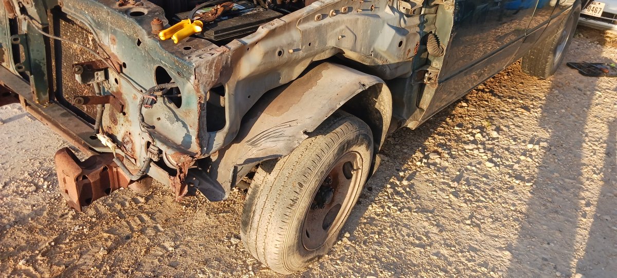

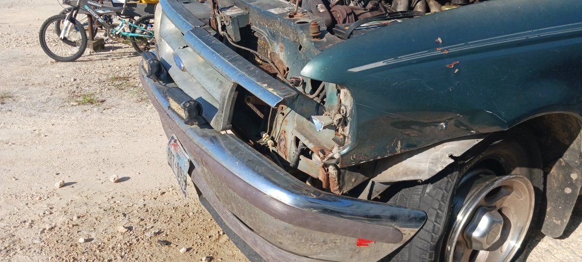

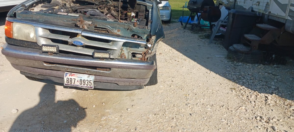

Wanted to add some of the damage pics before I started to tear into this. Could have been so much worse. Thankfully everything that's damaged is superficial exterior parts that are easily replaced.

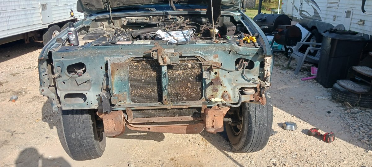

Today I removed the bumper, fender and bad tire. Found a few issues with the core support, but it's getting swapped out for a new one. Here are a few pics of where it sits right now. At least now I can drive it a bit if I need to move it.

Yeah, I was concerned seeing how low the front left corner was sitting in that first set of pics. With everything removed it looks like the frame is straight and the core support was just bent. New core support and inner fender would probably get everything back straight.
Sounds like you want to facelift to newer generation which involves replacing the core support anyway. Time to start hitting up some salvage yards and picking parts. I understand wanting to go new on everything, but I'd recommend at least getting your header panel from a salvage yard if you can find a good one.

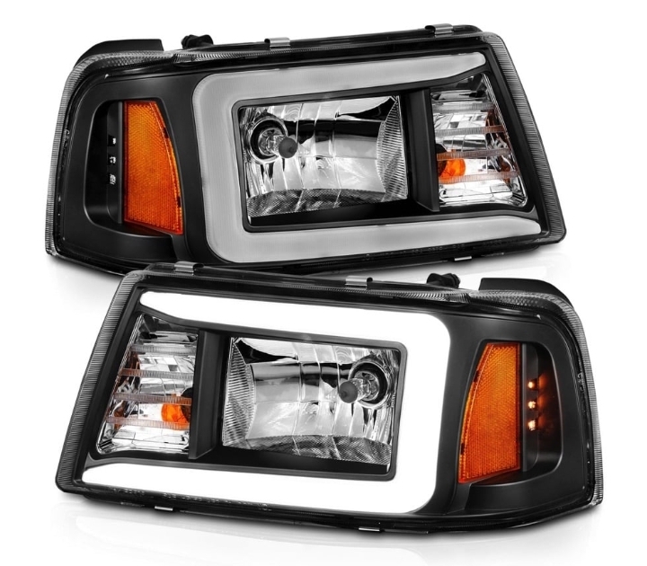

Small update, I have received a few of the parts I ordered via rock auto. New header panel, grill, both left and right inner fenders and sone of the headlight mounting hardware. Still need to source the outer fenders, bumper pieces, valance, hood and core support. Been patient and have run across a few on the CL parting out 01 - 05 Rangers, but also asking astronomical prices on pull off parts. One ad said the outer fenders were $120 each and the hood was $500. Some people reach too high. I tried to walk them down on their pricing hoping they were just wishing to get a good sale price, but no dice. They were pretty stuck at what they listed everything for. I will keep searching, but this is my daily so I need to get it back up and running asap s well.
Where did you find those headlight buckets at?
Often the seller will tell you that they are "polycarbonate" (Lexan) but they are not, just have a very thin sprayed on coating which doesn't last more than 6 months, do yourself a favor & clear coat them yourself first. I did this to my replacement one piece buckets and finally they look much better after a year exposed to the Texas sun.
I haven't purchased them just yet. I've been looking at several different suppliers such as Amazon, parts geek and so on. I realize the less expensive they are the more likely they are to be made of cheaper quality material, but I'm researching to find the best value for the dollar amount. Once I do make my decision and buy a set, I'll be sure to update this thread with the info.
The one piece design is really a nice feature if & when you buy new. A quick spray with WBPU and a couple of re-coats I would recommend. Please share a picture.
Just an FYI there are MANY grades of polycarbonate. Very few of them use the Lexan name. Oddly enough they are often mixed with black colorant and ABS.
