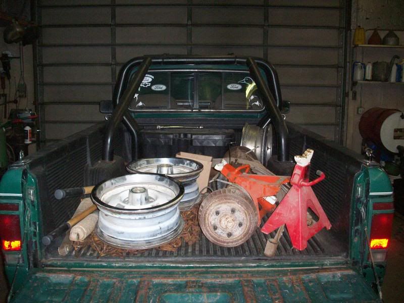

For rear squat, I have a set of 13.6x38 tractor feedlot tire chains, 3 rims, a 7.5, a pair of Ranger springs and two large jackstands in the back of my Ranger that I just put the previously pictured Explorer springs in and it didn't phase the ride height at all.
