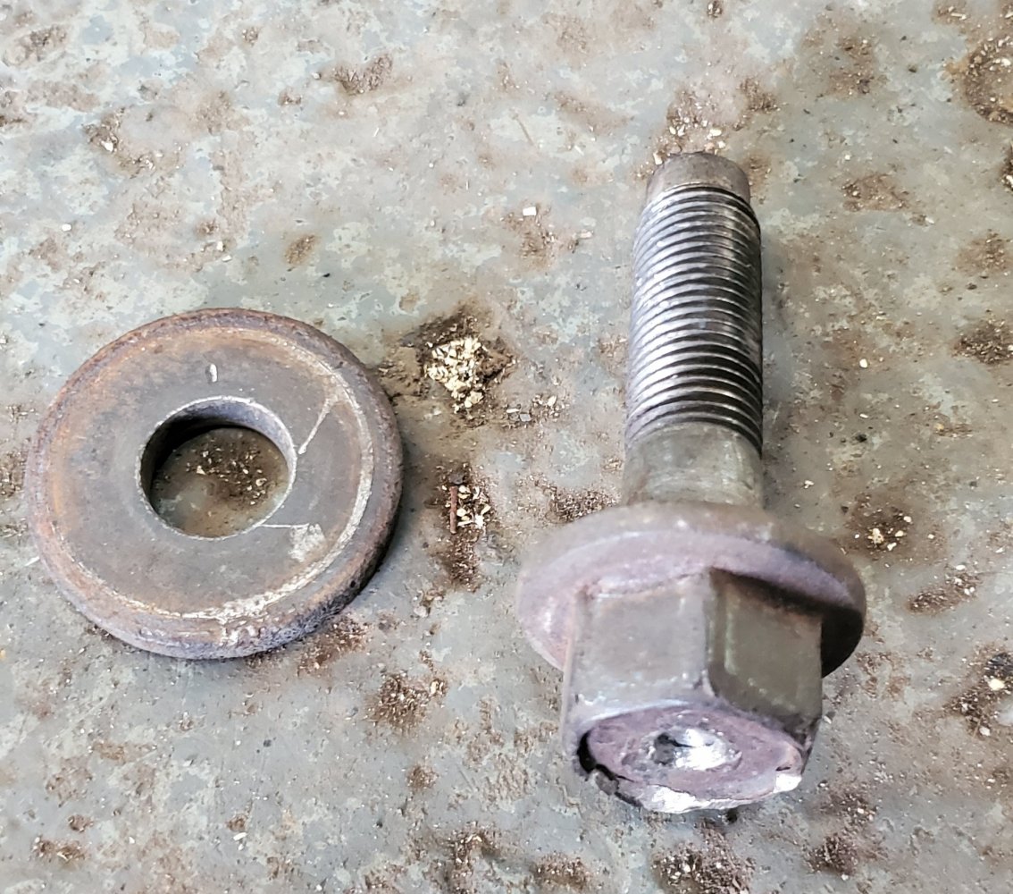

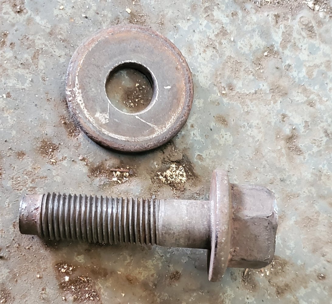

Bent my harmonic balancer bolt while trying to remove the balancer with a puller.
Trying to find a replacement online and no luck.
Any suggestions on a new one, whether OEM, ARP, etc? Would rather avoid a hardware store special.
I know this is an older post but I just encountered this issue. The harmonic balancer is available but the bolt is not.
After a lot of research I found a mopar knuckle to hub bolt from a ram 3500 is the same bolt with a jis head. Same 14x1 50x55mm at 10.9 hardness. Use the old washer, thread length is the same. Mopar part number is a 5086661AA and the Dorman cross reference is 926-171.
