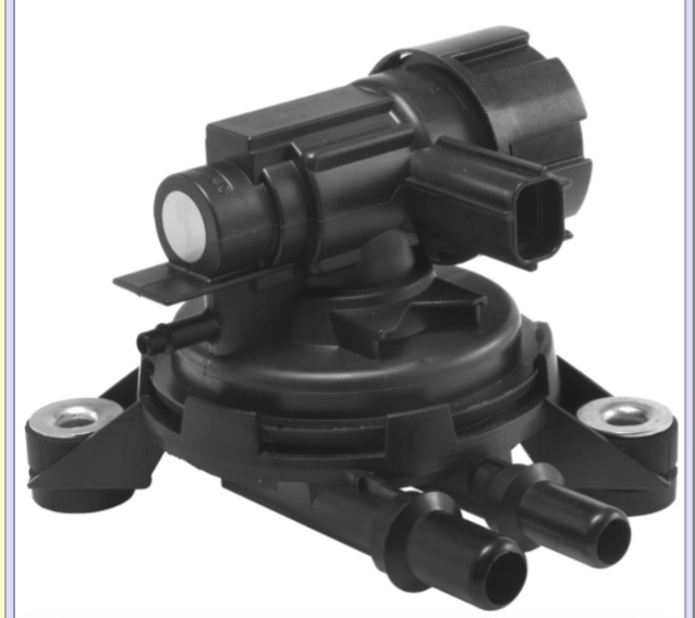

Hack #1: Purge Valve Modification
Only a few caveats exist for the conversion and I know them all.... one is the purge valve for the vapor canister.
In an attempt to make things behave like the EFI but run a carburetor, I dont want fuel smell, I dont want vapor accumulation under the car and certainly not under the hood where Ill smell it as well. I also want to actively be purging the canister at least as well as a 1972 Ford truck would have in 1972. The factory of course uses a 12v solenoid purge valve that gets a signal from PCM, that opens a needle valve which lets manifold vacuum pull a large diaphram with a twin seal out of the way, thereby connecting the vapor can line to the manifold vac port/PCV system under the appropriate conditions.
I am cheap. Initially I was going to use a GM vacuum switched purge valve as a contemporary analog device. Thats another $40-50 so screw that!
Last night I decided that the purge valve was pssing me off and making me think to hard to find a way to bypass it. You may say, "thats easy". No it is not. Bundy connectors are used for both in and out. Two differing diameter Bundys, 1/2 inch and 3/8. The 1/2 inch is a "nylon" hose extension from a steel line as far as I can see and is the input. The output is just FI hose with Bundy to barbs, that part is easy. I found parts ot help but again, another $25.00. You mess up a nylon hose under your Air Conditioner compressor and you rapidly become an angry person.
So I removed the entire bracket with purge valve and found it was quite easy to disassemble. I will post some stills of the modified device later tonight.
Essentially it is a clamshell. Take the electric half off to expose a large return spring, a diaphram with 3 separate seal surfaces and a plate with two orifices. The diaphram has a major diameter outer seal that seals the clamshell. The inner diameter is for sealing the INPUT channel cast into the plate. The center of the diaphram has a TIT that is like a pencil point, and it PLUGS the OUT to manifold orifice. At rest the diaphram simultaneously blocks the CHANNEL, the ORIFICE and maintains a seal on the clamshell. When vacuum is applied from an accessory tap by the solenoid, the diaphram is sucked away from the platter, opening both channel and orifice linking them.
The hack is to both maintain the clamshell seal integrity but loose the dual seal integrity permanently. Once opened, I removed the return spring as there will never be high vacuum applied to the system. Second, I added two BUMPS to the platter surface causing the dual seal to see a lump rather than a smooth surface to seal against. Lastly the center of the diaphram is aluminum and I hammered a small dome into it so that it could not seal the old TIT/Orifice even with the silicone TITcut off. Under test even with tit removed, the flat center of the aluminum did effective seal about 90% the orifice.
Essentially the diaphram is now unable to seal except the perimeter of the clamshell. You can suck/blow with very little restriction. I effectively married the two ports making a butt connector out of a purge valve. I get to use the factory hoses in total, the valves outlet will feed the air cleaner base plate port with the 3/8 OEM hose which happens to be the correct length to get there.
Thats the hack. It is a rare situation I believe I created but Ill bet someone else on some other later model RBV(ish) car may desire to link the purge line to the carburetor region of the engine cheaply on their converted EFI to carbonator system. Could be done on any car with a purge valve, at least from Ford. I have seen quite a few purge valves from Fords and they all seem to be built similar.

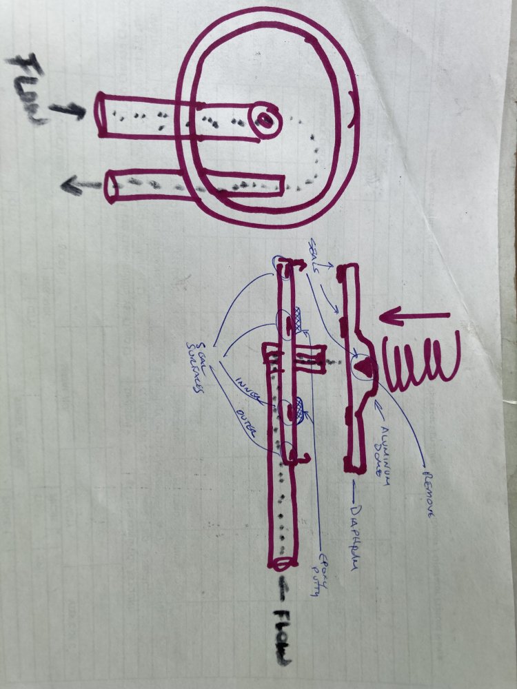

In my haste to assemble and rainproof the car, I installed the purge valve complete before pics. So my less than professional artwork must suffice
Pic of the complete valve.
Drawing shows the base of the valve which is removed from the whole assembly with a couple of small flat screwdrivers, easily. Perimeter plastic latches get stretched a bit and it pops apart.
This will expose the base with the tubing connections and the diaphragm. Coil spring presses on diaphragm and seals the concentric inner and outer seals when solenoid not active/and or vacuum not present. The little tit in the middle of diaphragm is removed with a screwdriver gouge easily. The aluminum dome is then dented toward the spring to raise its clearance from the central port opening. Or alternately you could shave down the port tower an 1/8 inch. The dent is less work.
the epoxy putty high spots are placed approx in line with the inner diaphragm seal surface. These should be very minimal, 1/16 inch to 3/32. This will allow the outer diaphragm seal to seal the entire device when you snap the top back on but the inner will have an obstacle in a few places. The diaphragm is flexible and will distort to the new shape. The dented dome will permit gases to flow from the central pipe to the outer pipe channel.
Remove the spring completely and toss.
Once assembled, blow or suck both directions on the two ports to ensure you have a complete bypass that has satisfactory flow. If too little for your liking, open and add more blobs of putty or- taller.
Let the epoxy have time to surface harden so the device doesn’t get stuck to the diaphragm with incited epoxy.
There are probably 9 ways to skin this so this was fast and took 10 mins, had stuff on hand. Simply ensure you have violated both the tower seal and the inner concentric seal permanent, whatever way you choose to go. Violating one or the other will leave you with no flow.
Had to wait on a job for 30 mins today and figured my scratch paper and boredom could be useful.
