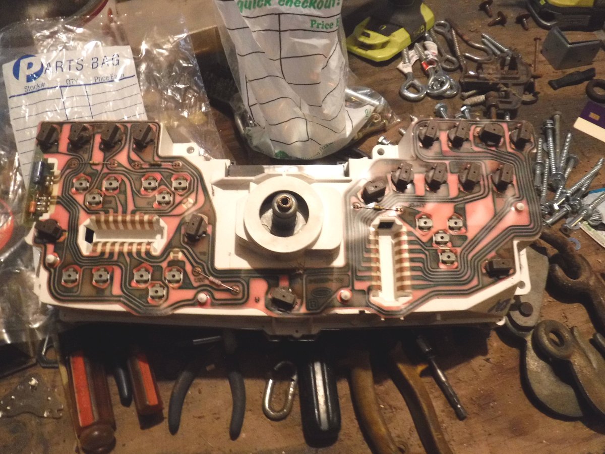

While playing around at the Picker's yard I plum tore that cable from a 94 B4 Mazda, and have yet to get mine loose shy of dynamite. I did go ahead and grab the B4 Cluster, doesn't appear to be damaged but I never could bring myself to put that much pressure into releasing it.
Appears to be 16 of the T10s, and now I've come to the sad realization the small socket looking things are uhmm, sockets?! and I'm guessing it's the T5s that go in front

There a release latch on the bottom side of the cluster for the gear shift PRND21 cable if that what you had trouble with. Speedo is electric driven, so no cable for that on the Ford cluster.
Mine is stick and has the gear, I likely won't tackle it before getting the motor swapped and running, I don't have the T5 bulbs here anyway
