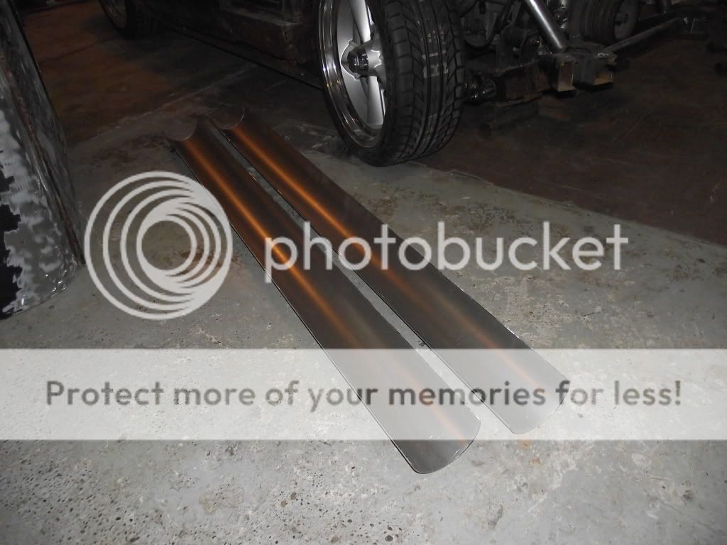

in the mean time,how about some rockers?making them this way not only gives me a nice even curve,they are also corrosion resistant.
i still have to figure out how the sidepipes will be hung.

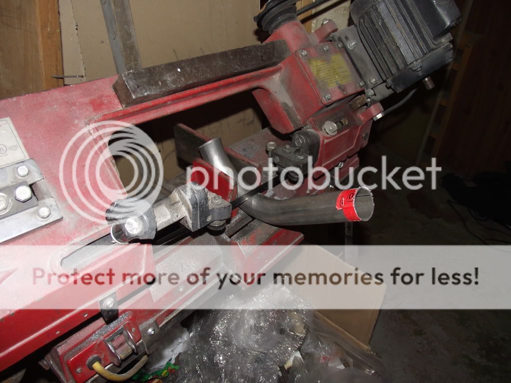

virtually all my cutting is done with the little bandsaw,this is a great machine for this sorts of stuff,although a zipcut or even a hacksaw could be used.
i think where a lot of people get into trouble is in thinking it can be done quickly.accept from the beginning that making something worth having will take a few days,then take your time.sometimes i'll take over an hour just to get one piece fit up right.but if i do that,i'll be much more likely to be satisfied with the job for the years afterward that i have to look at it.

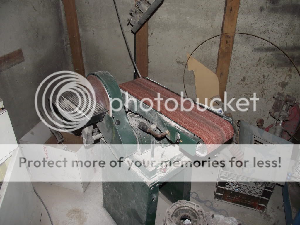

this small belt/disc sander is another very handy machine for fitting up parts.small angle changes and length adjustments are pretty easy using this.it's a 6x48''belt,and 9'' disc.

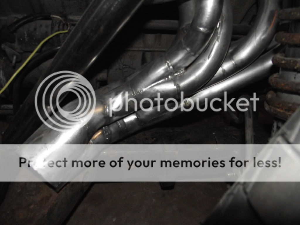

heres a detail of the right side header showing the primary and secondary collectors.i will probably bemaking the left side collectors tomorrow,so i will show how they are made.
