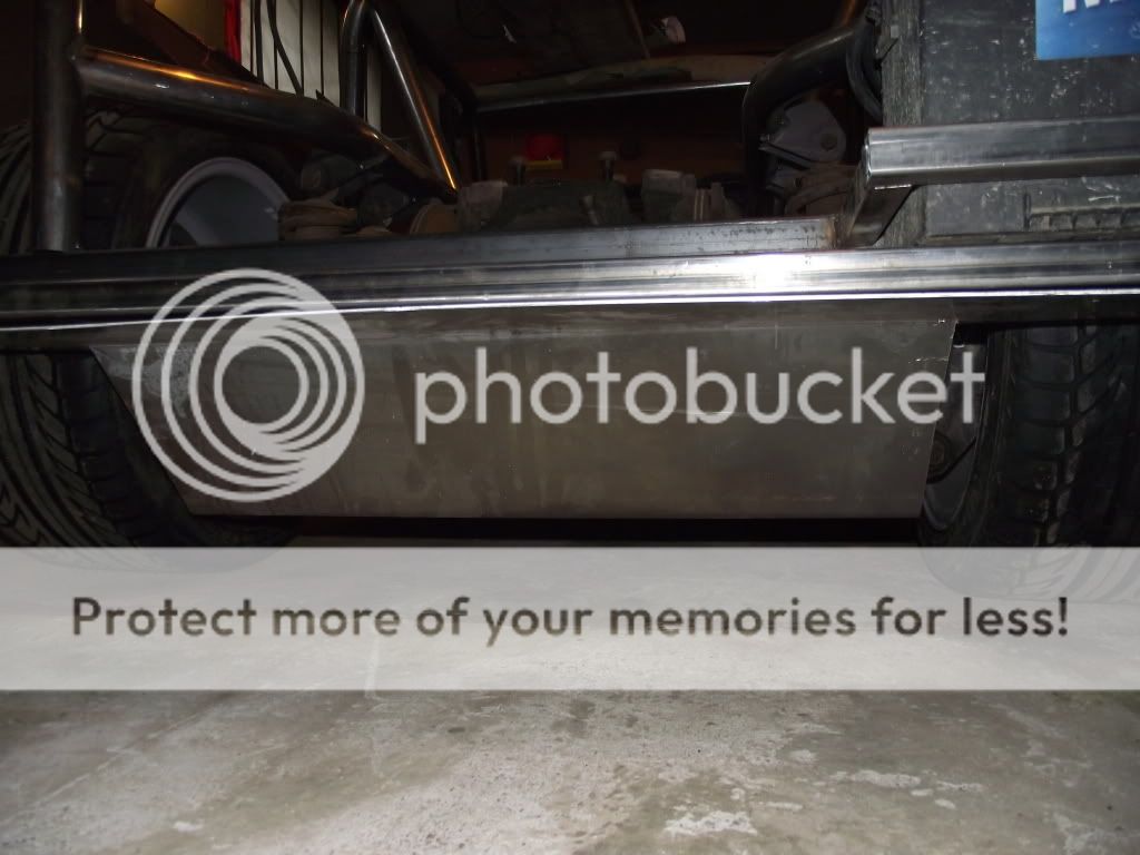

it's a slow go....spent about 3 hours at it today.
messed up at first,tried cleaning the surface with a scotchbrite pad,it put so much contamination in the weld i had to grind it out and start over.
recleaned it with a wire brush and all was fine.

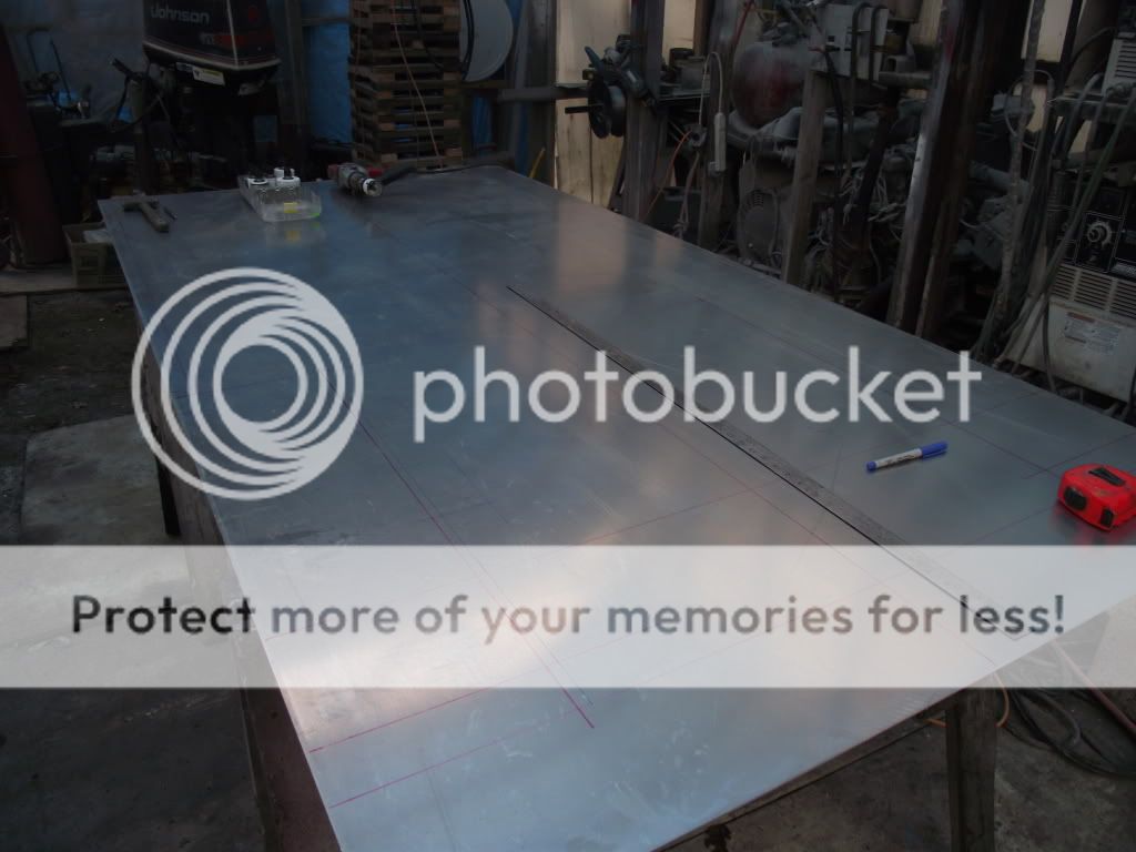

so,i figured it's time to get the floor/belly pan sorted out.
yup...more aluminum fab.

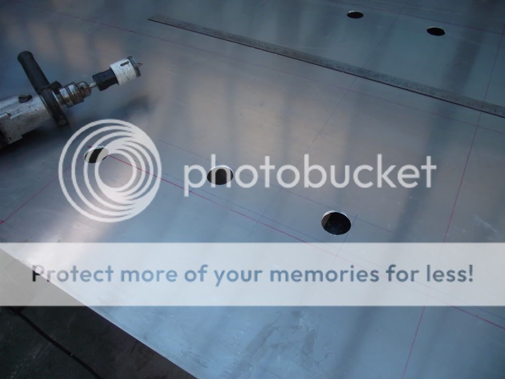

when doing cutouts that need radiused corners,i like to start out by drilling the corners out with a suitable holesaw.this leads to a more professional looking finished product.

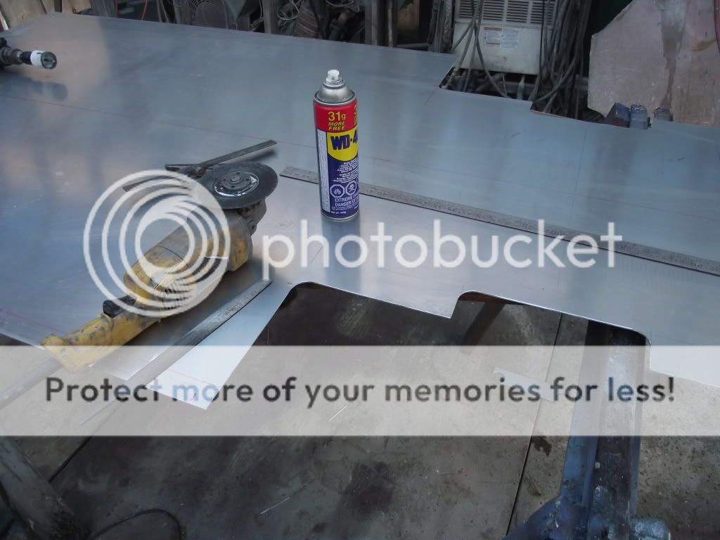

i cut out the wheel opennings with a zipcut.i will often use a circular saw or a table saw on aluminum,but when i need precision this is the way i usually go.
when cutting aluminum,lubrication is essential to prevent the tool from getting clogged up right away.i give the disc a quick shot with wd and it cuts slick.you will feel it starting to grab after a few inches of cutting,this is when you need to stop and shoot some more oil on.
this also applies to using fiber disks,bandsaws,and even files on aluminum.

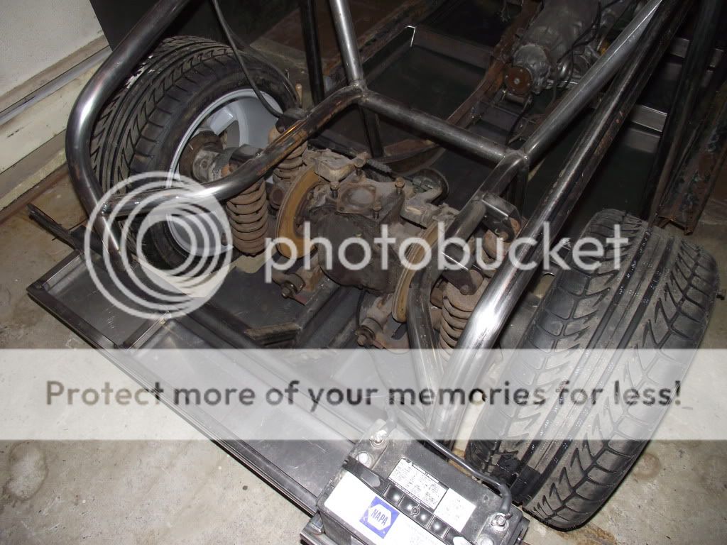

with the pan set under the car and clamped to the frame,you can see why i didn't want anything sticking down under the frame rails.i want a smooth,clean bottom on this car.

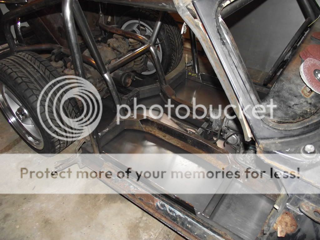

this is where the kick up is.the pan will be a smooth surface from the very front to the very back of the car.putting it on a hoist won't give you too much access to anything.

Back on topic, that's a neat looking brake setup on the rear axle. Never seen one with the rotors right at the diff like that. Neat!
inboard discs were real popular on racing and high performance cars for quite some time-it reduces the unsprung weight,allowing the wheels to follow the road better.i just think it's cool.
