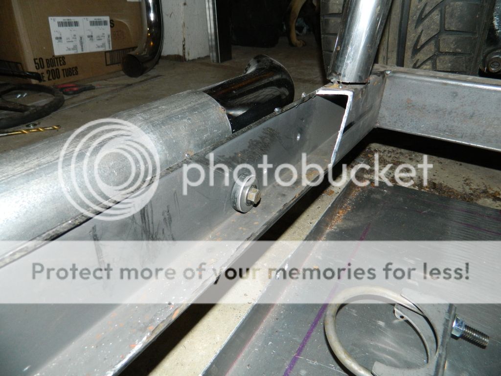

in line with the whole body-to chassis interface thing,i needed to ge the rockers figured out.a big part of this was getting the sidepipes hung,as the rockers pretty much envelope them.

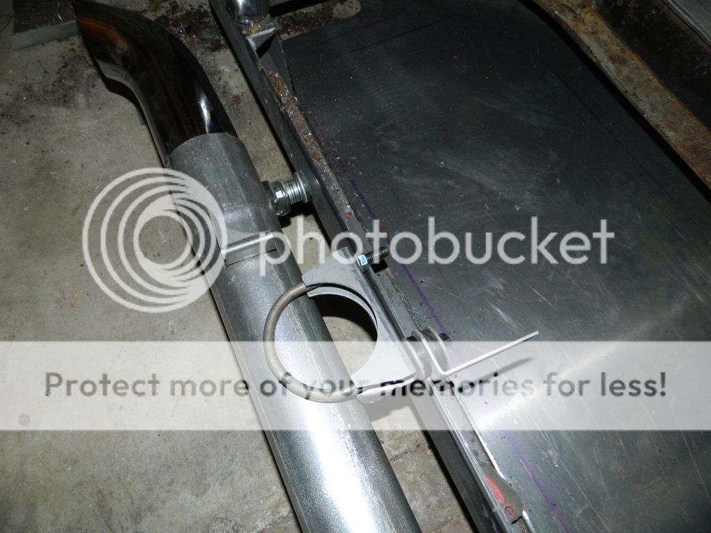

on top of the pipe is the setup that came with the kit.it would be pretty effective on a car(or truck)that had room for it,but there was no way i could fit it into this build.
i cut the saddle for the u-bolt to make a weld-on bracket(above,in pic)then drilled the frame side to accept the isolator.washers have been used temporarilly to space the pipe out to it's needed position,though these will be replaced with a machined spacer.

from inside...it's not too obtrusive.

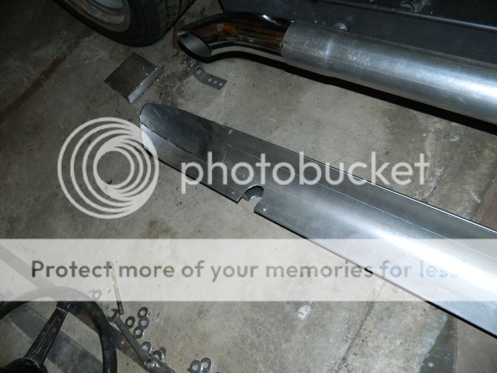

i wanted the body to be able to be removed without disturbing the mechanical in any way...and this meant the sidepipe mounting couldn't be disturbed.with this setup a simple notch in the bottom of the rocker to clear the pipe mount will allow the body to be pulled up.this still needs to be cleaned up and flashed in.

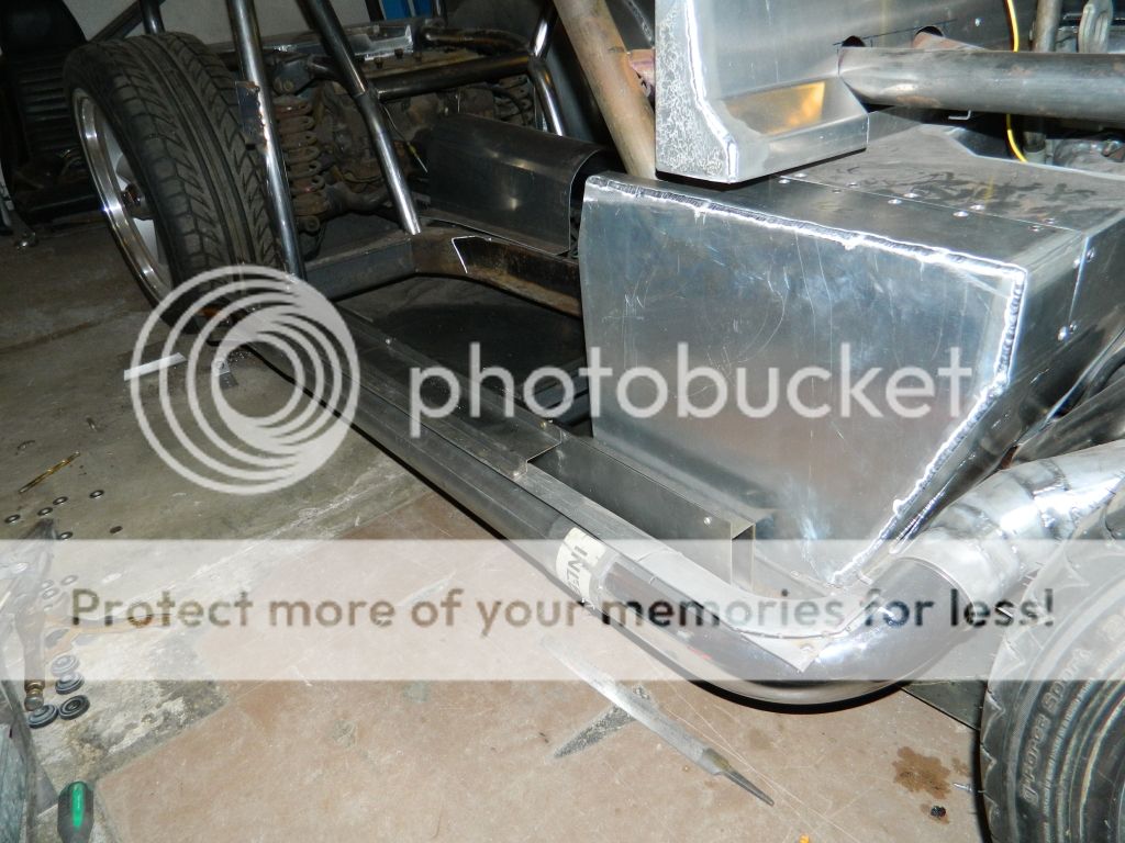

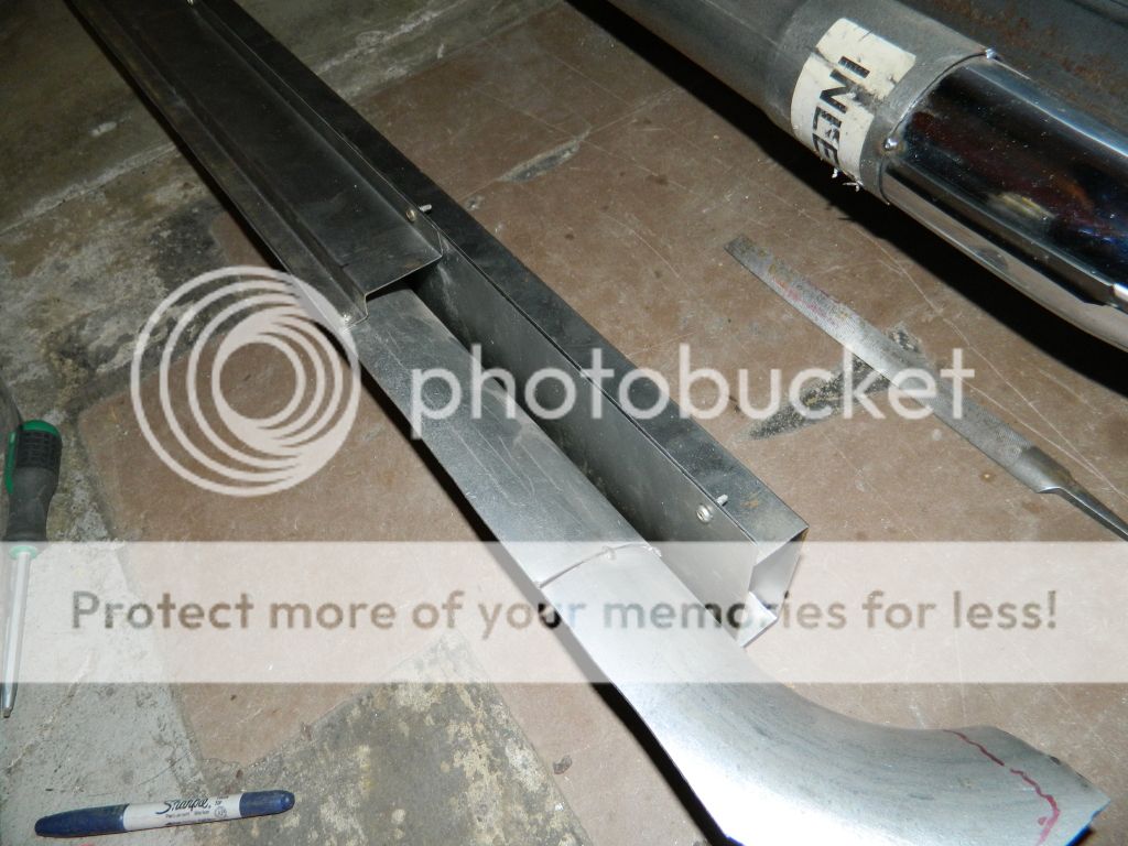

the rocker assembly is made from four parts-the inner section,a flat stiffenner,the outer rocker panel,and the door sill.this structure is fairly rigid...i think it will do the job well.

bolted to the frame,you can see how tight things are on this assembly.both rockers will be assembled onto the frame,then the body dropped onto them and welded to them in place.this will ensure everything lines up when done.
